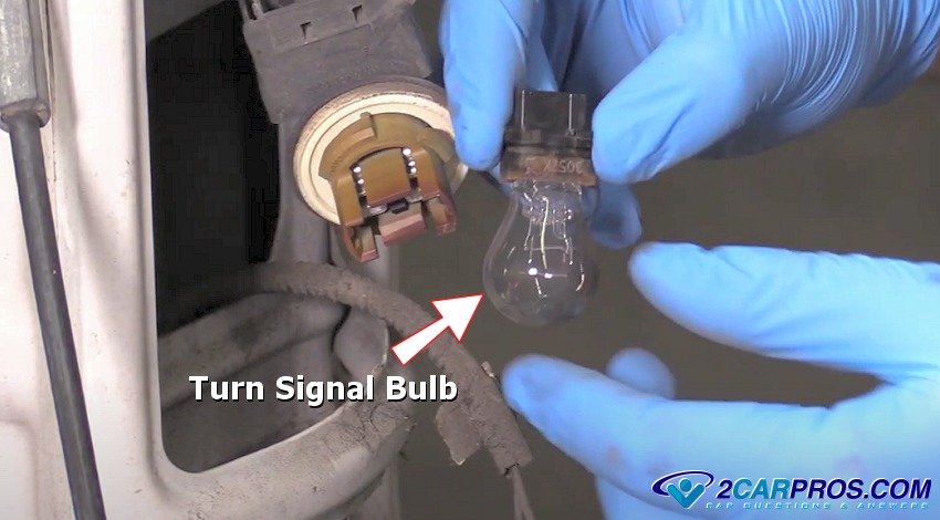

Single Bulb Failure - This is the easiest of the turn indicator problems to repair. First, access the bulb by either removing the lens or gaining access to the bulb from behind. Next, remove the turn signal bulb to replace it with a new unit and reassemble.

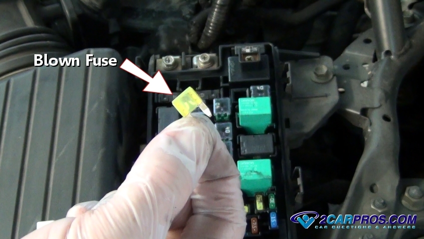

One Side Failure - With the ignition key still on, use a test light to check for power and to test the blinker system fuse integrity. There can be more than one fuse that runs the system. Most times, the fuses will have an ID which can be found on the fuse panel cover or BCM. If you are having trouble finding the fuses, please ask one of our experts to help (free).

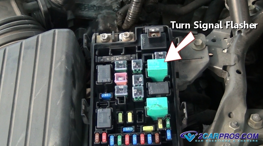

On older vehicles without a BCM or lighting control module, a turn signal flasher is used and can be configured to operate each side of the blinker system individually. When a flasher fails, it can prevent the system from lighting up or the lights to illuminate but not blink. The location of this flasher will vary. In the example below, it is located in the under hood fuse panel or PDC. Once located, remove the flasher to replace it with a new unit and recheck the signal operation. Again, if you cannot find the flasher unit please ask one of our experts for help (free).

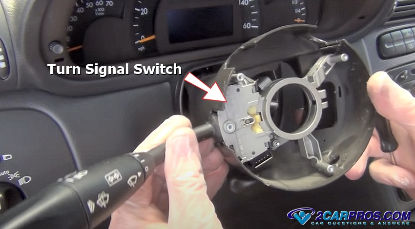

One Side (continued) and Total System Failure - A turn signal switch is designed to facilitate the operation for one side or the other. One or both sides can go bad. To test this switch, you must gain access to the rear of the switch or the switch wiring harness to check for output power to the particular side that is not working. Using a wiring diagram, which can be obtained by one of our experts or a source such as AllData DIY, (pay) you can identify the wire color to test and check for power output using a test light. This will isolate the switch as the problem if no output power is present or a power supply to the switch.
