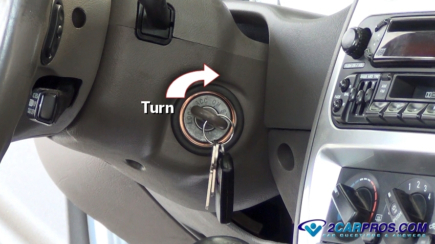

Turn the key to the on position, push the turn signal switch in the direction the system blinks fast in, right, left or both.
turn key on

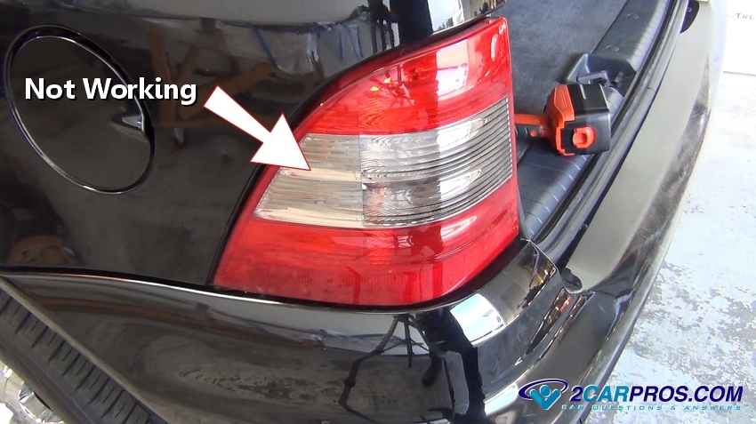

Inspect both the front and rear of the vehicle to identify a directional signal bulb failure, remove the lens or gain access to the rear of the lens and remove the turn signal light bulb.
blinker bulb not working

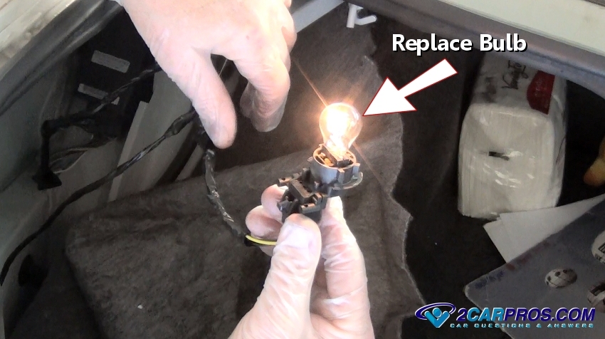

Once the bulb has been replaced check the blinker operation which should return to normal, then reassemble. It is a good idea to add dielectric grease when replacing the bulb, this stops corrosion.
replace blinker bulb

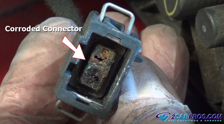

Sometimes the bulb can be good and electrical corrosion is the problem. When the bulb is removed, inspect the electrical connector terminal condition, if a slight amount of corrosion is present it can be repaired using electrical connector cleaner and a small wire brush or Exacto knife. If excessive corrosion is present the connector must be replaced as in the example below.
corroded blinker connector

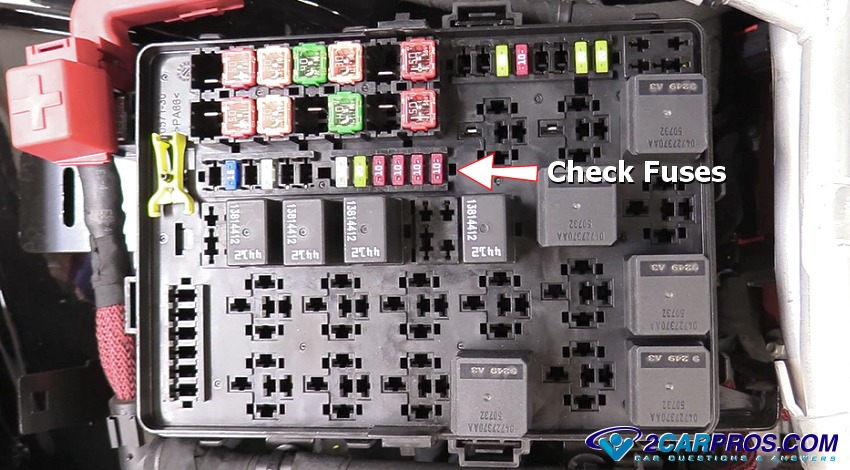

If all four turn signals are blinking quickly check the fuses on the BCM or fuse panel, if your vehicle has a turn signal flasher unit, replace it. If exact fuse or BCM locations or procedures are needed you can ask our experts to supply you with the information (free), or consult an online resource such as AllData DIY (pay).
check turn signal fuses
