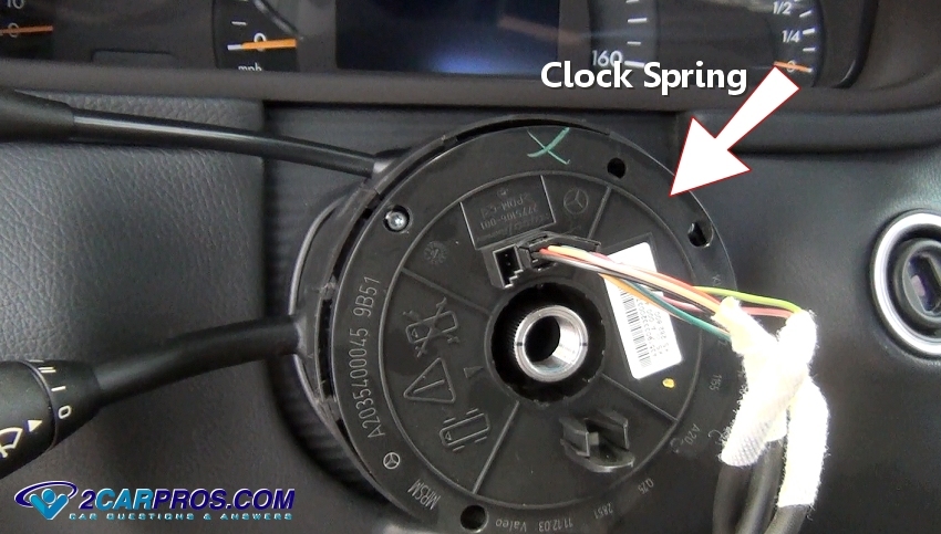

Beneath the steering wheel the electrical system clock spring or spiral wire is next, this part is designed to facilitate the steering wheel controls and horn operation while the wheel is in motion, it can be held in place by using mounting screws which will allow you to remove the clock spring.

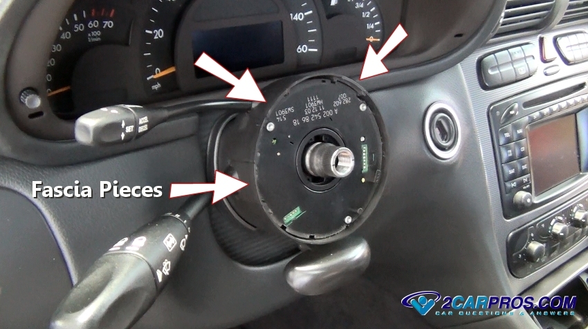

There can be a retainer plate and fascia pieces that need to be removed to access the turn signal switch, this will vary and may not be needed for some applications, simply grasp the pieces and remove them, they should pull right off.
steering column fascia pieces

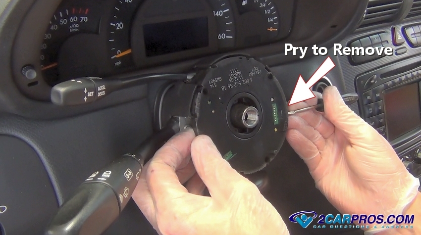

After removing the retainer plate mounting screws use a small screwdriver and gently pry the plate from the column, it should lift straight off.
remove steering column top plate

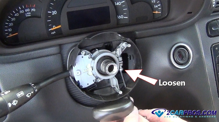

The directional switch is now exposed and ready for replacement, loosen and remove the turn signal switch mounting bolts or screws, in this case the switch is held in place by a squeeze clamp.

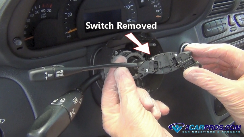

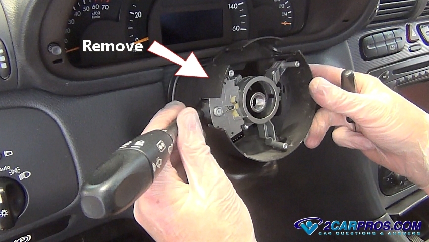

Gently grasp the switch and column bowl assembly and pull it outward to remove it from the column.
remove turn signal switch

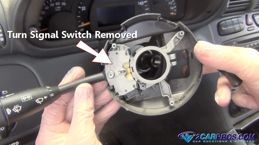

Once the switch has been removed, inspect wiring connections and terminals for corrosion, some turn signal switches are designed with a wiring harness attached which will need to be disconnected near the bottom of the column before removal.
turn signal switch removed

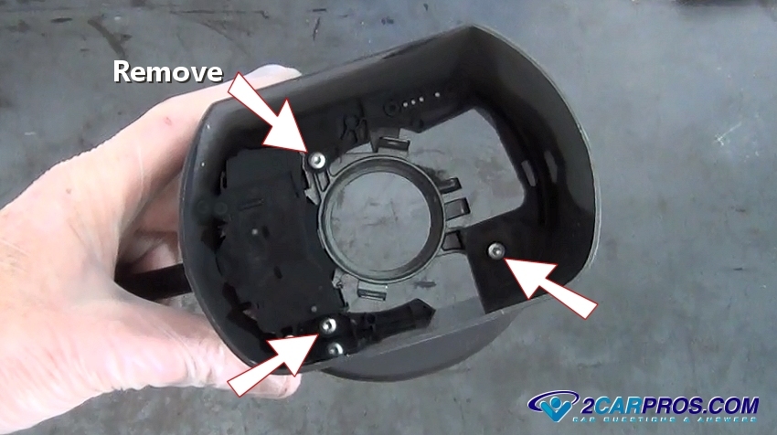

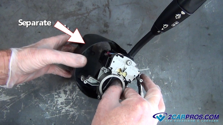

From the backside of the column bowl remove the switch mounting bolts using a Torx or screwdriver, this will allow you to change out the switch.
remove turn signal switch bezel
Remove the switch from tjhe steering column bezel.
separate bezel turn signal switch

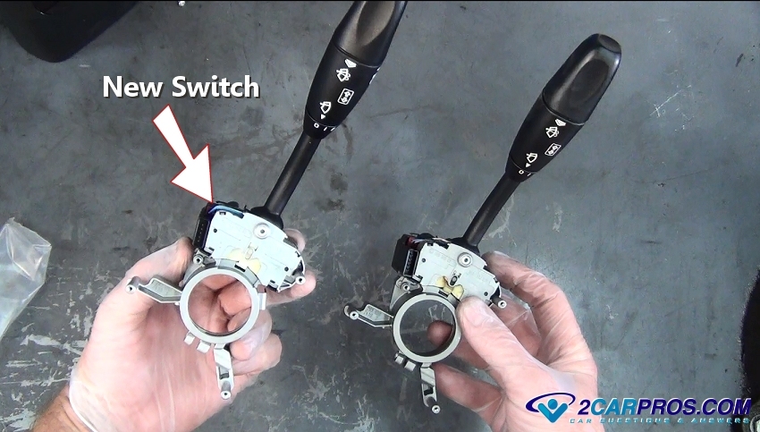

Compare the new switch to the old unit, they should match identically.
new turn signal switch

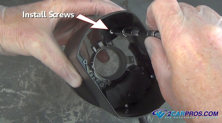

Reinsert the new switch into the bezel, install and tighten screws by hand to avoid cross threading, then tighten evenly.
install turn signal switch bezel screws

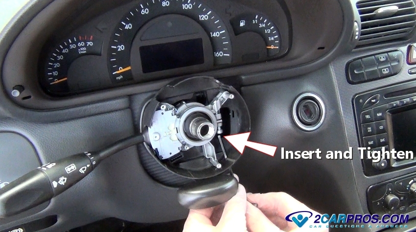

Gently place the bezel and new switch over the steering column, after pushing the switch into place, insert and tighten the mounting screws or bolt(s). Re-install fascia pieces, move the top plate back into position and gently lower it into the column, reverse the previous steps to complete the job.
tighten turn signal switch mounting bolt
