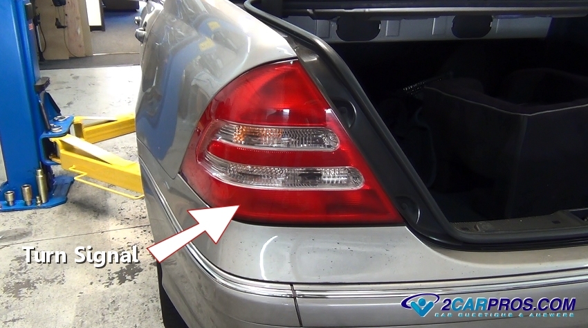

There are two different styles of bulb maintenance procedures, the first style requires the removal of the lens to access the bulbs while some manufacturers supply an access door which is the example we are using in this guide, additional configurations are featured in the videos below. First, identify the turn signal light (blinker) that has failed, inspect both front and rear bulbs to ensure the turn signal system is not the problem.
turn signal bulb

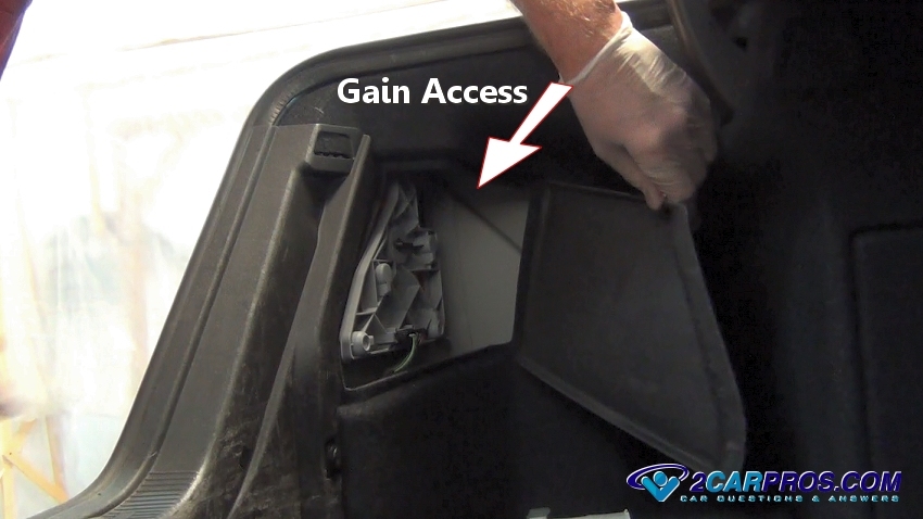

There will be an access door behind the lens to replace the bulb, if not you will need to remove the lens. Open the access door and the rear of the lens will be exposed, there might be small screws or a plastic twist fastener that may need to be undone.
gain access to turn signal bulb

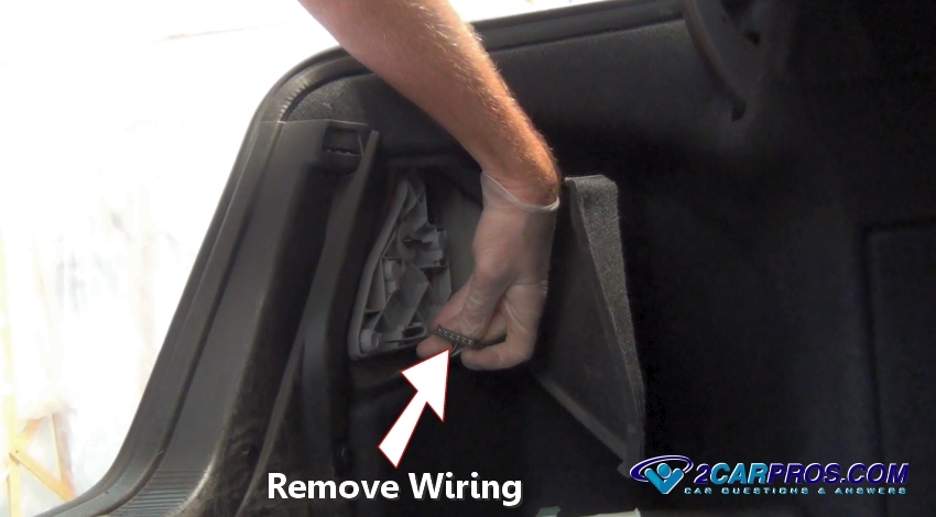

Release the wiring connector from the bulb housing, some vehicles are designed with bulb socket attached, in this case turn the socket counterclockwise to remove.
remove blinker bulb wiring connector

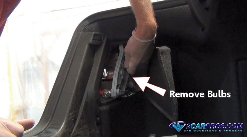

Grasp and turn the release fastener to pull the bulb housing plate from the lens, gently remove the bulb mounting plate which will expose the various bulbs including the turn signal, this configuration can be different depending on design.
remove turn signal bulb housing

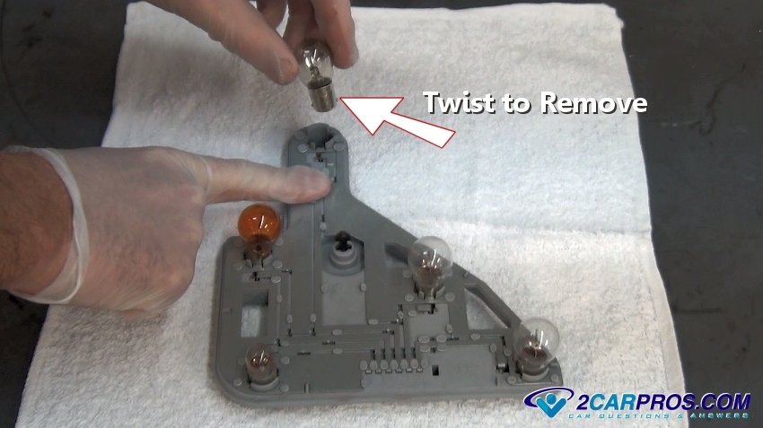

Identify the failed blinker bulb, this failure is sometimes accompanied by a darkish color inside the bulb glass. While holding the plate down, gently grasp the failed bulb and twist counterclockwise while pushing down slightly, then pull up to remove, some bulbs just pull straight out.
twist to remove blinker bulb

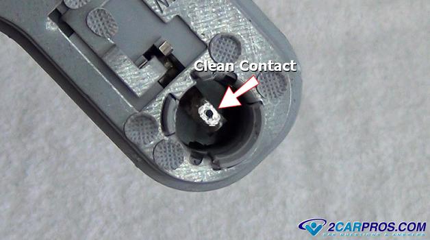

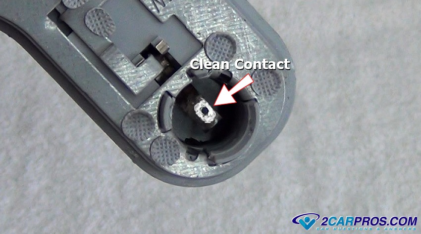

Once the bulb has been removed, inspect the bulb and socket for corrosion or damage, occasionally a bulb electrical contact can become overheated and burnt due a to high resistance of a poor connection, this will hinder the new bulb operation. Use a sharp object such as an Exacto blade or sandpaper to clean the contact by scraping the terminal exposing new metal.
clean bulb contact

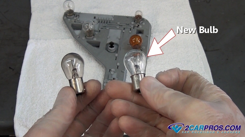

 Match the new bulb to the old unit, they should match identically, do not install incorrect bulbs this can cause lighting system electrical issues.
new turn signal bulb

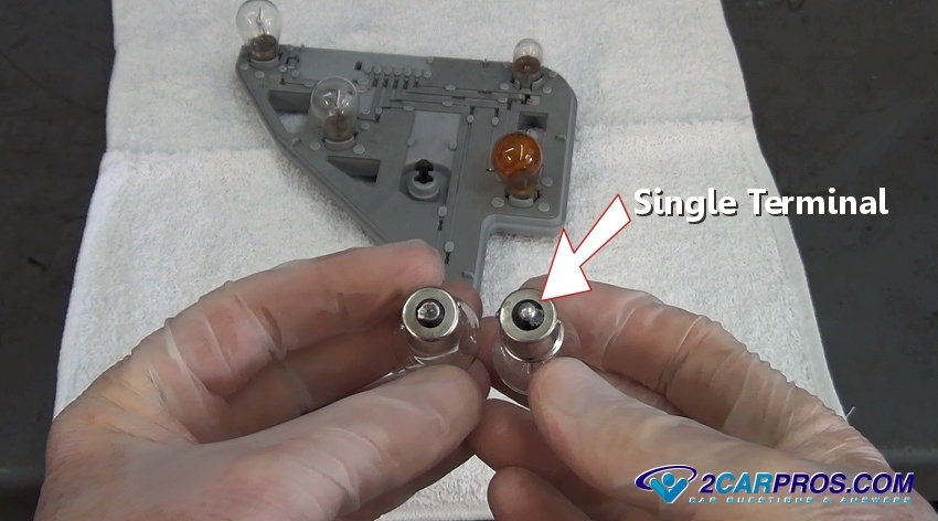

It's important that the bulb terminals are the same, some bulbs are designed with two terminals which can cause operational problems if installed.
turn signal bulb single terminal

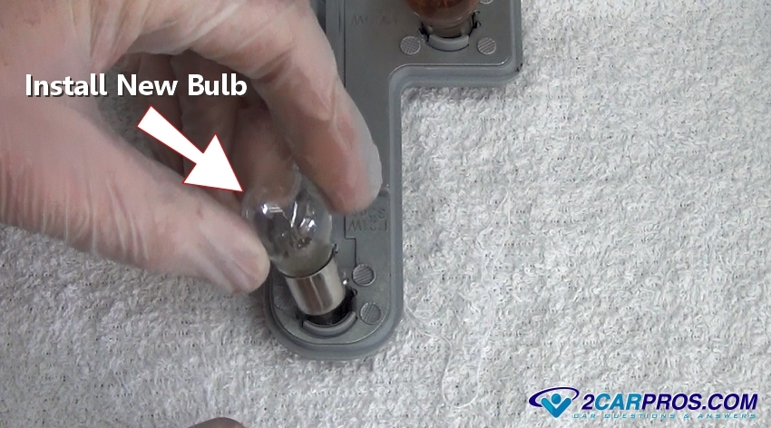

Gently install the new bulb by inserting (push down) and twisting it clockwise (or push straight in), It's also a good idea to include dielectric grease as well when installing the bulb to protect the connections.
installing new blinker bulb

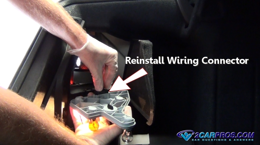

Reconnect the wiring harness connector to the blinker bulb mounting plate.
reinstall blinker wiring connector

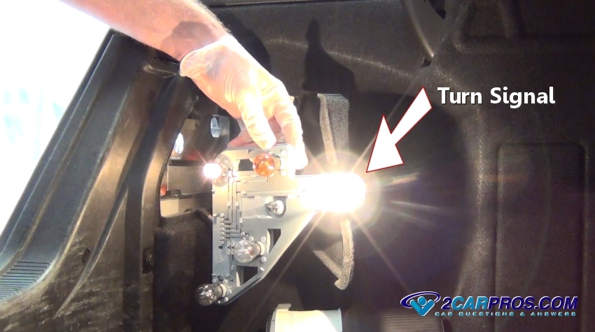

Turn the ignition switch on while engaging the blinker lever to operate the turn signal bulb ensuring the repair is done correctly and reassemble.
