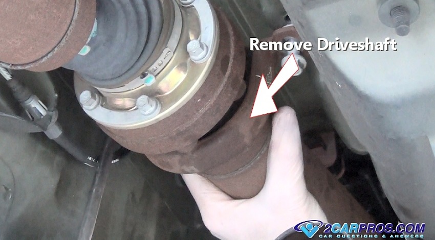

Unbolt the driveshaft at the differential and center support and it should slide out of the rear of the transmissions in most cases, in this case the driveshaft needed to be unbolted at the transmission as well, as the driveshaft comes loose keep your hands on it.
remove drive shaft

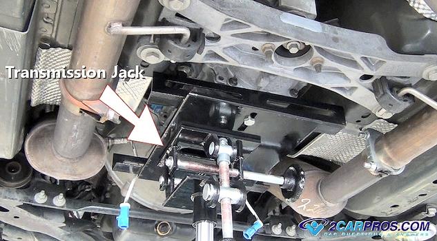

Position a transmission jack under the transmission case and raise it slightly, enough to lift the weight off the transmission mount. In this example you can see a full range jack because the vehicle is on a lift needed to film, you can rent a floor style jack from the local parts store for a small amount.
transmission jack lift

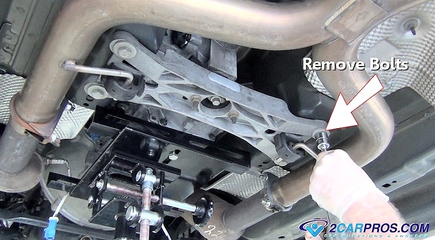

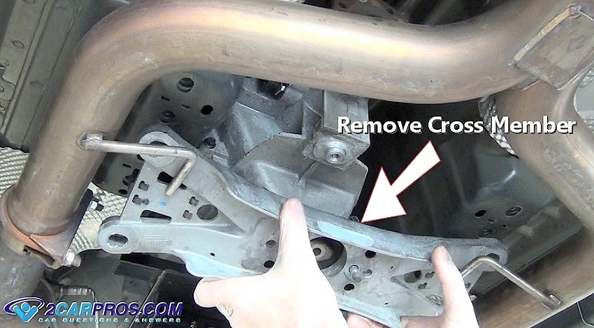

Remove the transmission crossmember mounting bolts, this will allow the transmission to rest on the jack which is needed to lower the unit while holding the transmission steady.
remove transmission cross member
Locate and remove the transmission crossmember bolts or nuts to the rear transmission mount, it will become loose so keep your hands on it so it does not fall. The jack is now holding the weight of the transmission.
remove cross member

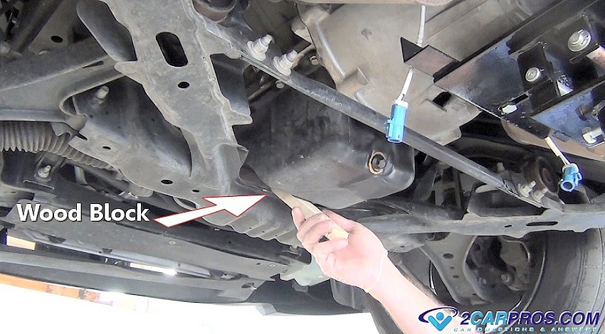

Once the transmission is removed the engine will need to be supported. If the exhaust system was removed, here we use a wood block to sandwich between the engine pan and frame, a small jack will work or any means needed to keep the engine from dropping backwards, the wood will compress slightly.

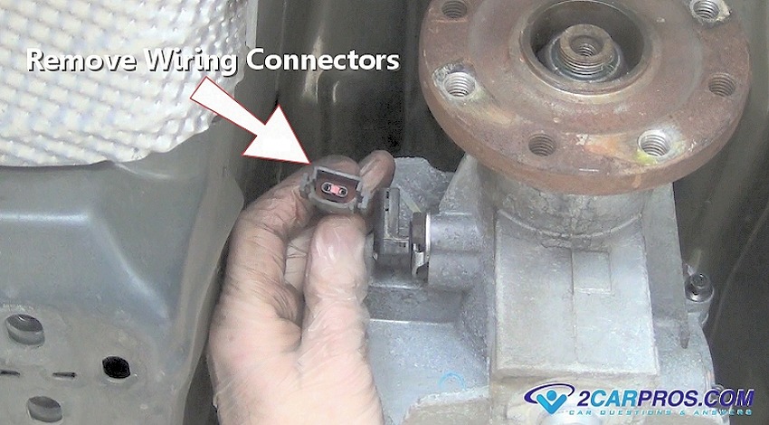

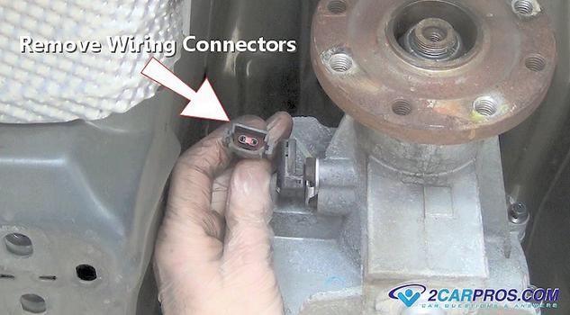

With the transmission lowered slightly remove all wiring connectors such as the vehicle speed sensor and reverse light switch.
remove transmission wiring

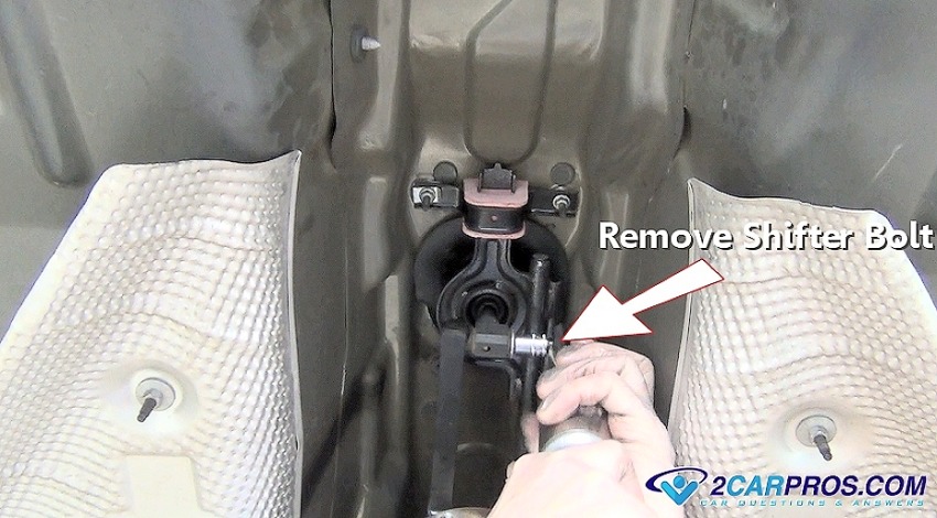

Remove the shifting linkage, this will vary, for example some transmissions have a plate where the shifter enters the transmission, this must be removed from inside the car or from the top of the tail housing.
remove transmission shifter bolt

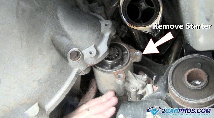

On this particular design the starter motor is bolted to the bell housing which needs to be removed, this is why we disconnected the battery in step 1. Remove the starter motor mounting bolts and gently set it to the side.
remove starter motor

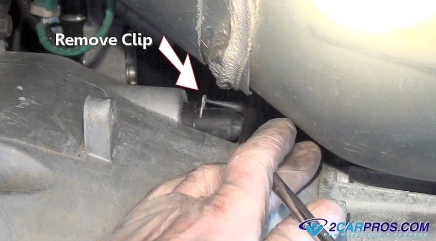

Use a pick or small screwdriver to gently pry the retainer clip from the clutch hydraulic line at the bell housing, if an externally mounted secondary cylinder or clutch cable is used, unbolt or unclip from the transmission.
remove clutch pedal line retainer clip

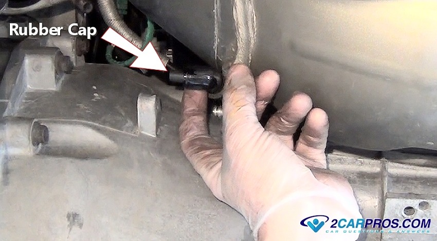

Gently grasp the line and twist back and forth to pull it from the slave cylinder, fluid will start to leak, insert a rubber cap to stop the fluid.
clutch line rubber cap

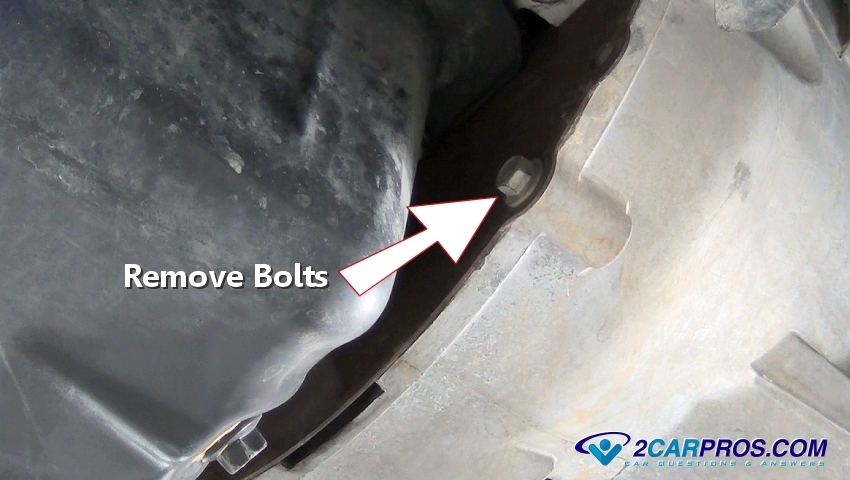

Locate and remove the engine plate or dust shield bolts from the bell housing.
remove engine plate mounting bolts

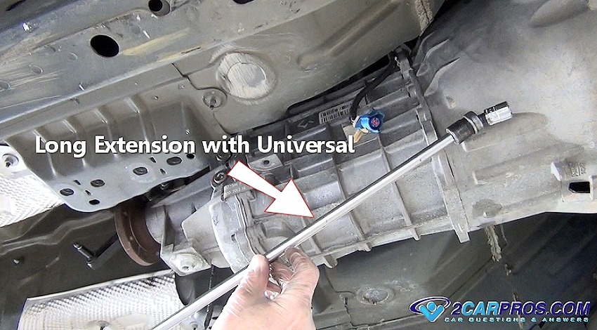

At this point everything on and around the transmission has been removed or disconnected except for the main engine to bell housing mounting bolts, the upper bolts can be difficult to remove unless a long extension with a universal is used.
long extension with universal

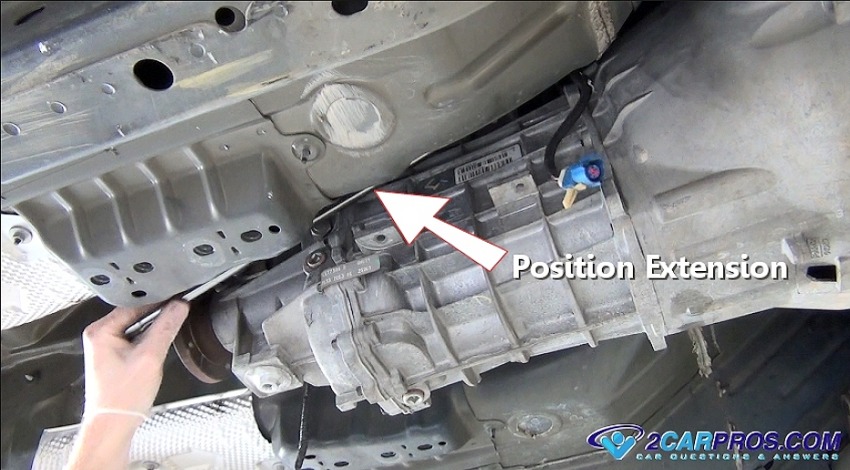

Guide the extension over the top of the transmission to gain access to the upper bell housing bolts and remove the bolts completely.
position extension above transmission

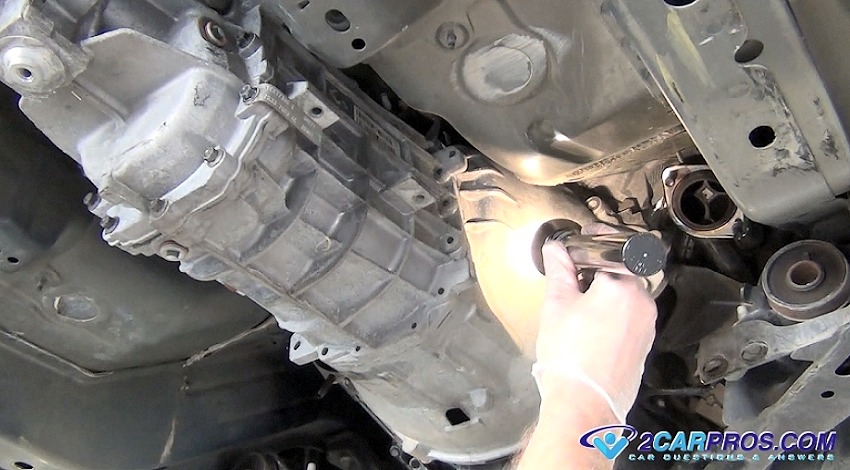

Continue to remove the transmission bell housing bolts until all but the bottom two bell housing bolts remain, use a flashlight to double check.
flashlight

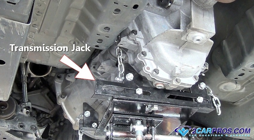

Securely reposition the transmission jack underneath the transmission and attach the safety chains around the case to avoid it from slipping off the jack.
transmission jack

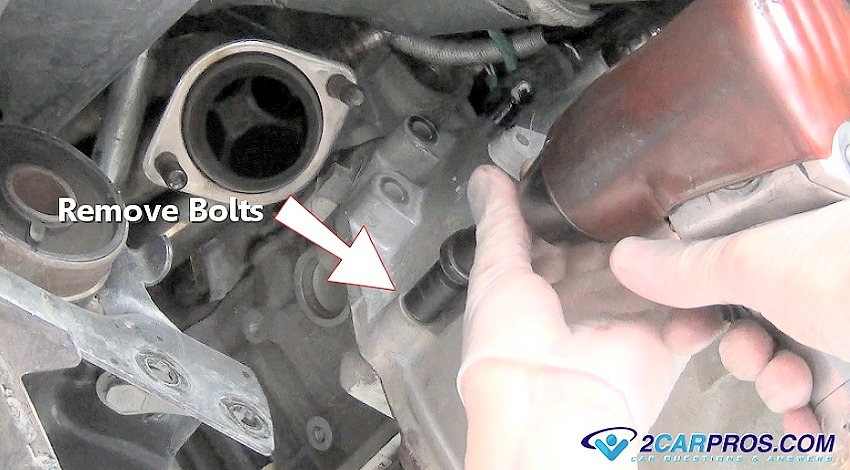

With the transmission securely supported by the jack, remove the last two bell housing bolts.
remove last bell housing bolts

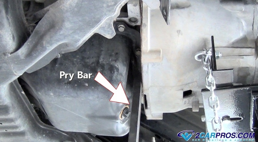

Even after all of the bolts have been removed, the housing could be stuck on the alignment dowels mounted in the engine block along with the input shaft inside the clutch disc, use a large pry bar and gently wedge it between the engine and transmission, apply pressure to "pop" it loose from the engine, further work the pry bar to fully separate. The transmission must be at a "neutral position" to separate, in other words the jack cant be too high or low, this creates a bind which will make the removal more difficult.
pry bar transmission lose

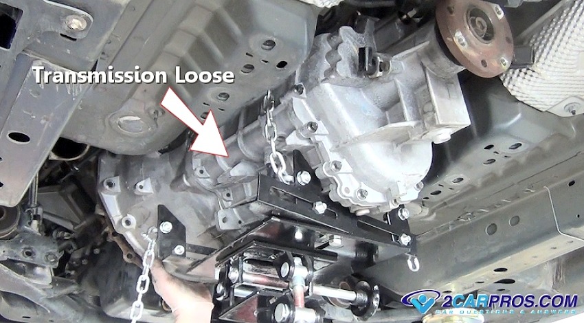

The transmission will then be loose behind the engine, keep the transmission steady on the transmission jack as you begin to lower it.
transmission loose

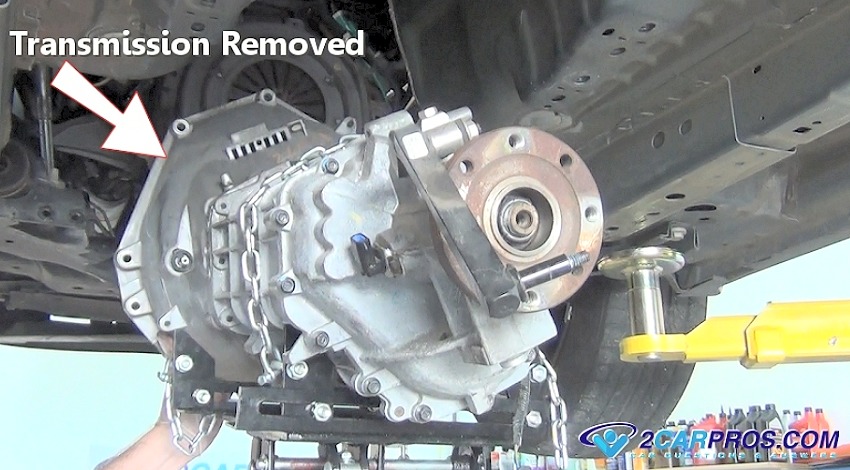

Slowly lower the transmission while keeping it steady, with a helper remove the transmission from the jack, it is now ready for a rebuilt unit or to have the original unit repaired.

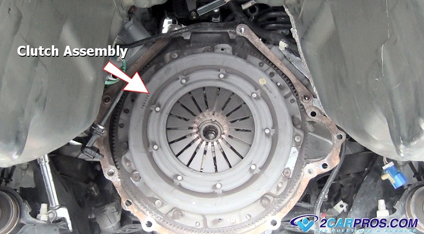

At this point the clutch will be exposed so a new clutch can be installed or the replacement of the engine rear main seal, throwout bearing, pilot bearing or flywheel. Also, if the oil pan gasket is leaking now is the time to change that as well.

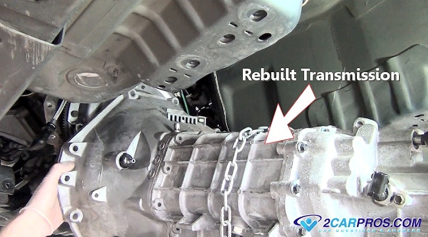

After repairs have been made or new/rebuilt transmission is ready position it on the jack, slowly raise the unit back into position behind the engine.
rebuilt-transmission

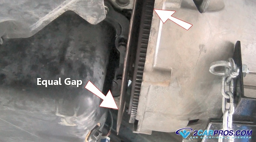

When bringing the transmission up to the engine and while the installation is in progress, keep the gap between the engine and transmission equal, clear all wiring harnesses and vacuum lines etc. from between the engine and bell housing, this is a common problem. Do not allow the transmission to "hang" on the engine at this point, it could bend the clutch disc which will cause it to not disengage.

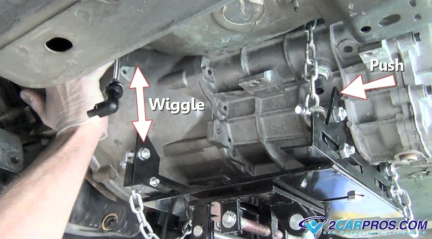

Push toward the engine while wiggling the transmission into position, the gap will close as the input shaft pushes through the clutch disc. If the transmission doesn't want to go into position, back the transmission up and slightly rotate the input shaft, repeat.
push wiggle transmission

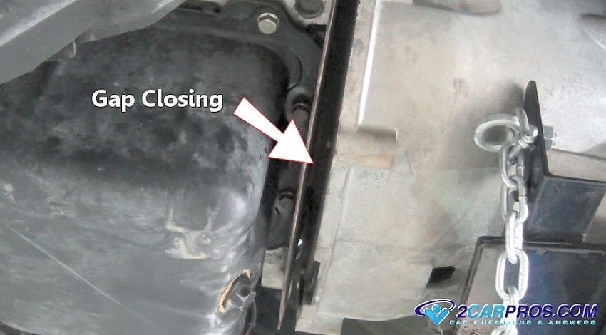

Once the input shaft is fully in the clutch disc, the gap between the engine and transmission will begin to close.
transmission gap closing

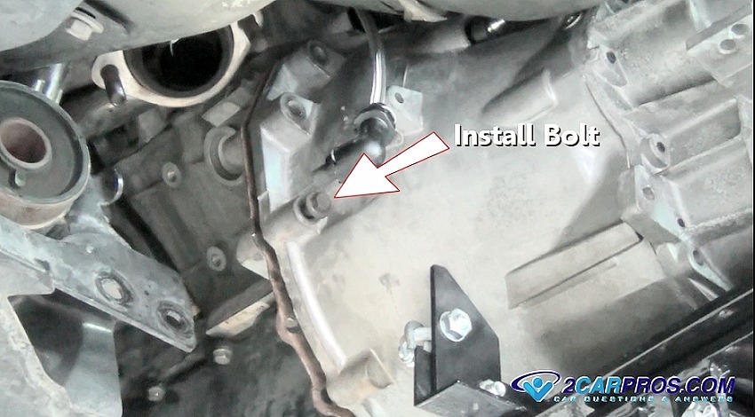

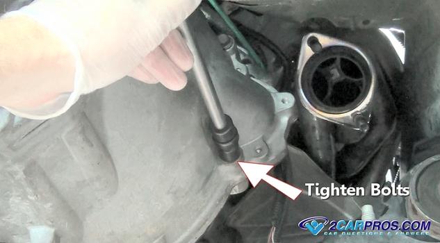

While keeping the gap even, install one mounting bolt on each side and slowly tighten (evenly) to close the gap completely.
install transmission mounting bolt

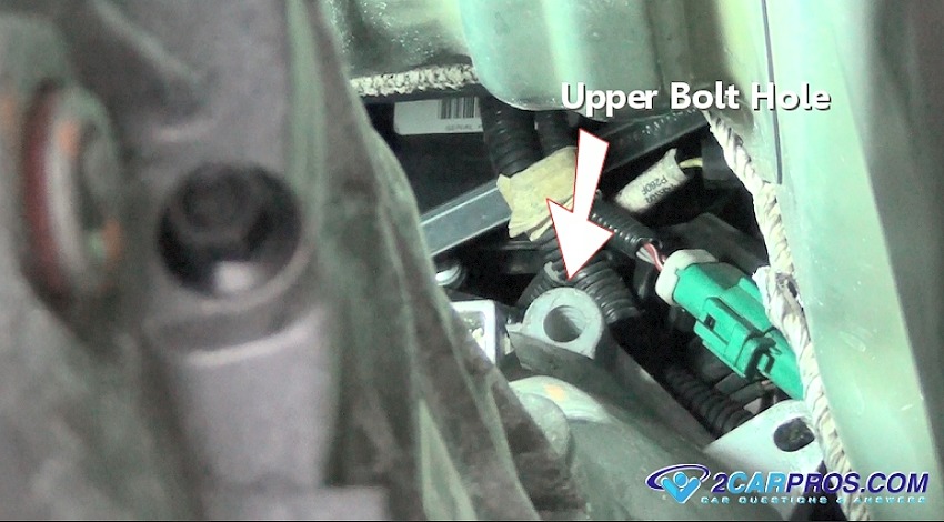

The upper transmission bolt holes can be difficult to access.

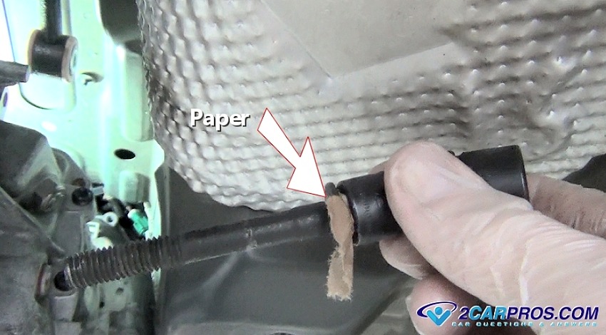

An old automotive trick is to add a small piece of paper to wedge the bolt into the socket which will hold the bolt while installing.
paper holding bolt to socket

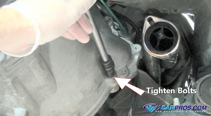

Continue to install and tighten and bell housing bolts evenly, once completed finish by tightening the bolts to the correct torque, in this case it is 34 foot pounds.
tighten transmission mounting bolts

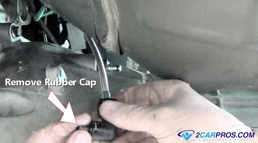

Once all bell housing and engine plate mounting bolts have been installed and tightened, remove the rubber cap from the hydraulic clutch line and push it back onto the secondary cylinder, reinstall retainer clip before installation.

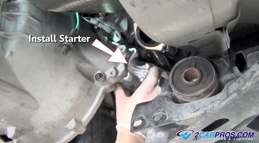

Reinstall the starter motor and attach wiring and positive battery cable, tighten the mounting bolts to spec, in this case 24 foot pounds of torque.
install starter motor

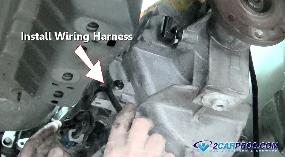

Reroute and install the transmission wiring harness and connectors to the reverse light switch and vehicle speed sensor.
installing transmission wiring harness

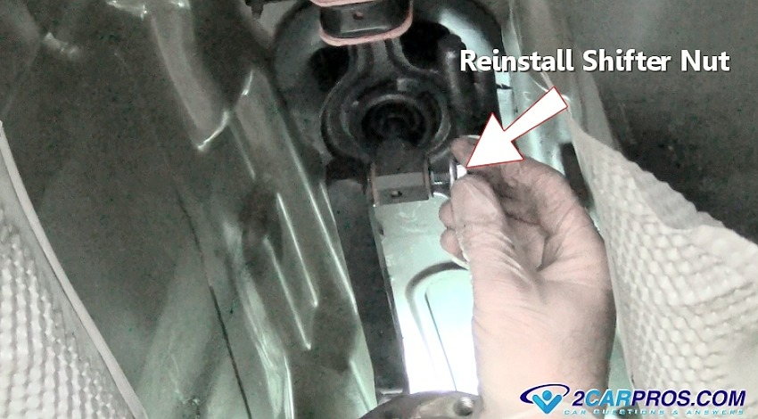

Reinstall shifter mounting nuts and bolts.
reinstall shifter nut

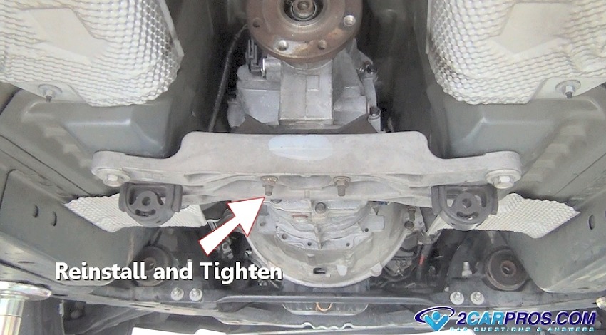

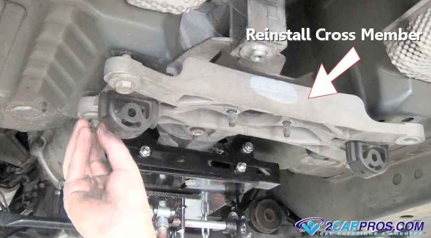

Raise the transmission jack up into position and install the transmission cross member and the mounting bolts, tighten to spec, in this case it is 36 foot pounds of torque.
reinstall transmission cross member

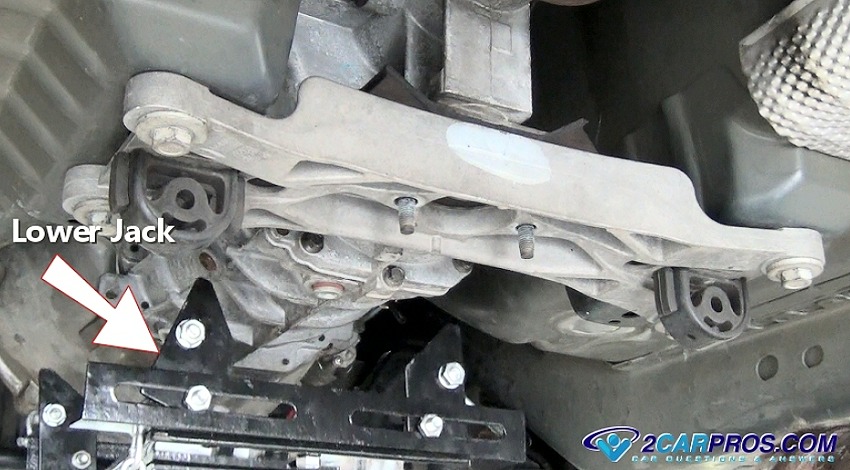

Once all cross member bolt are tight, lower the jack while guiding the transmission mount into place.
lower transmission jack

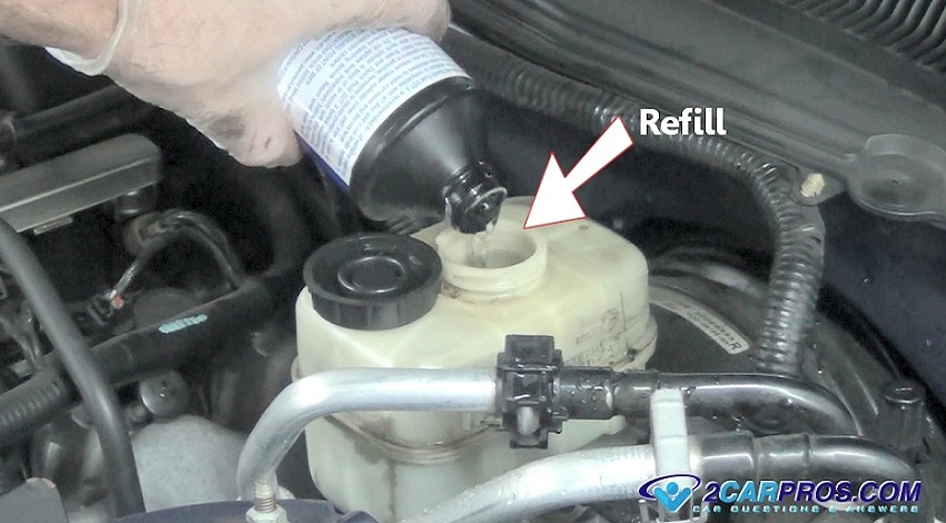

Locate the clutch fluid reservoir and refill, some vehicles use the brake master to supply fluid to the primary clutch cylinder.

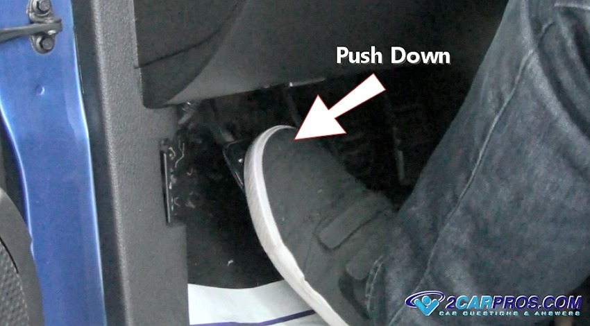

Most hydraulic clutch systems are self bleeding, just pump the clutch pedal until normal pedal operation returns, this can take up to ten minutes. The vehicle is ready for its first test drive, listening for any strange noises or sounds which can be an indication of a problem.
