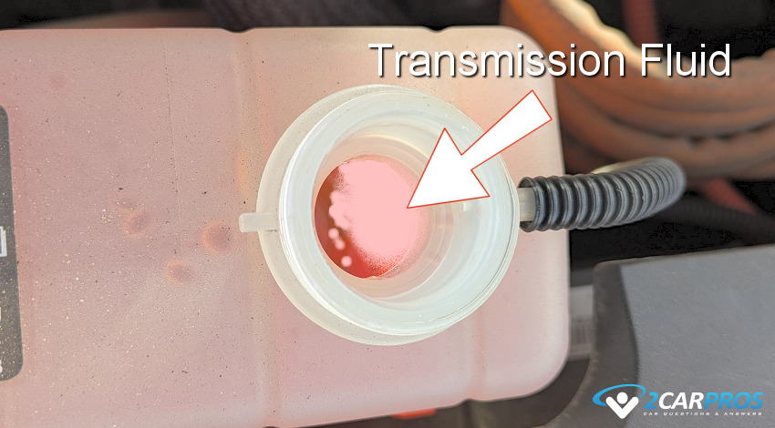

All automatic transmission vehicles are equipped with an transmission fluid oil cooler, when transmission fluid is discovered inside the coolant reservoir or the radiator it must be taken care of promptly to avoid transmission failure. In the guide below, we underline the causes and the steps required to fix the problem and help prevent costly repairs. This cooler is used to help maintain the transmission fluid temperature to avoid overheating which will damage the unit.
Causes of Automatic Transmission Fluid in the Coolant Reservoir
Because the transmission deals with hydraulic pressure which is transferred to the fluid cooler which is located inside the radiator, the failure of the cooler will result in transmission fluid inside the radiator fluid and cooling system. When the engine is started this pressure builds and will overcome the pressure inside the radiator contaminating the coolant.
What Will Happen?
After the engine is shut off, coolant can enter the transmission through the same crack in the cooler. This is because the cooling system retains it pressure, while the hydraulic pressure inside the transmission drops to 0. This is bad because this residual coolant pressure can get inside the transmission which will cause the unit to fail and the engine to overheat.

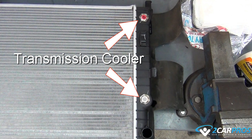

I Cant See the Cooler?
The transmission cooler line are connected to the radiator by utilizing steal tubing and fittings, the reason you can only see the fittings on the radiator is because the actual cooler is inside the radiator tank and is not visible. Here is what the automatic transmission cooler looks like in the radiator, there are incoming and outgoing fittings which the transmission fluid is allowed to enter and then exit back into the transmission.
transmission cooler line connection
After Repairs Are Completed
Once the transmission cooler (radiator) has been replaced, the cooling system will need to be flushed as well as the transmission fluid and filter. This will help remove the fluid contamination problem and protect the internal working of the transmission and engine.
