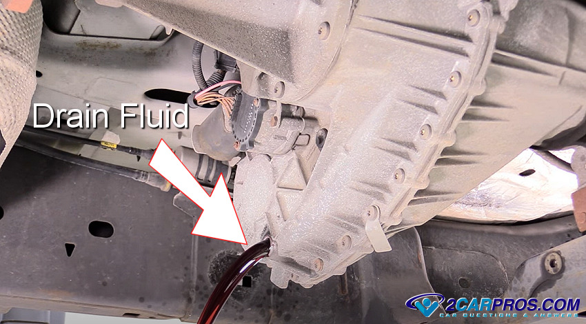

1. Drain Transfer Case: It make things easier it's best to drain the fluid from the transfer case to help minimize spillage. Position a drain pan underneath and use the appropriate socket to remove the plug. Allow all the fluid to drain completely, once drained, replace the drain plug.
drain fluid from transfer case

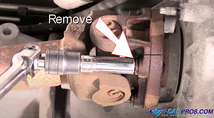

2. Remove Both Driveshafts: Before removing the driveshafts, mark the orientation of the shaft fanged onto the differential yoke, this will preserve their balance characteristics. Then remove the mounting bolts, these may have thread lock-tight on them so be ready because they are snug. A torch maybe used to help dislodge the lock-tight. Use a plastic hammer to "shock" the driveshaft flange loose.
remove driveshaft mounting bolts

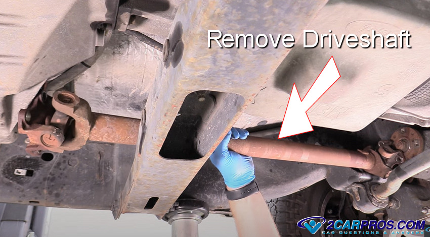

The driveshaft can be a little awkward so be careful not to damage, drop or dent the shafts. Once removed, slide the rear shaft from the transfer case tail housing, and remove the front shaft from the vehicle.
remove driveshaft

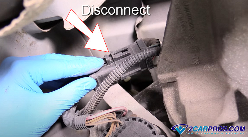

3. Disconnect Electrical Connectors: Most transfer cases will have electrical components that will need to be disconnected, make sure they are out of the way to prevent damage during the removal, also, remove any rubber vent tubes as well. Note: Some older transfer cases will have linkage as well which needs to be disconnected.
disconnect transfer case electrical connector

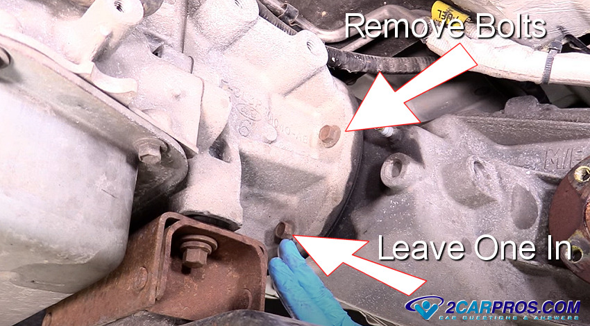

4. Remove Transfer Case Mounting Bolts: At this point, remove all of the transfer case mounting bolts except for one, (important) preferably one that is easy to get to. This particular transfer case has a total of 6 bolts, but your application may vary.
remove transfer case mounting bolts

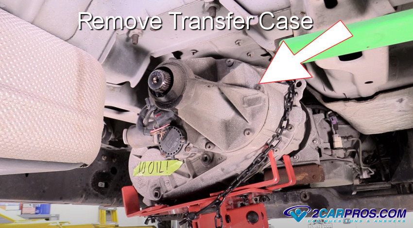

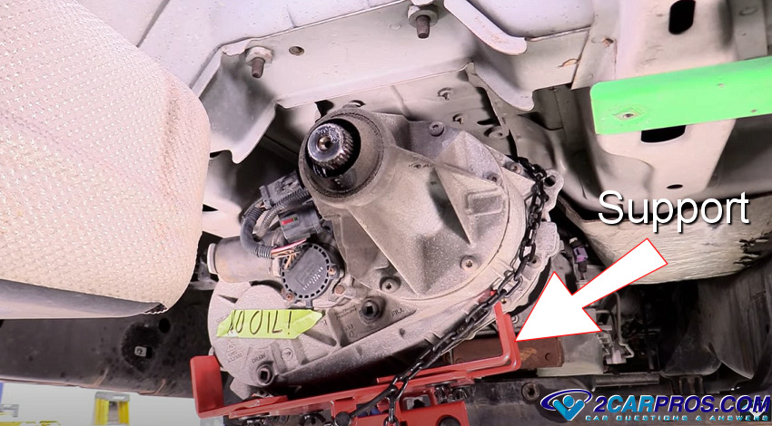

5. Support Transfer Case: The key here is to support the the transfer case because it is heavy, use a floor jack with a helper or a transmissions jack to help shoulder the load.
support transfer case

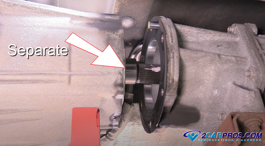

6. Remove Transfer Case: Once supported, remove the last remaining mounting bolt and give the transfer case a slight wiggle to break the seal loose, and then slide the transfer case back from the transmission, (Be mindful of the transfer case weight).
separate transfer case from transmission

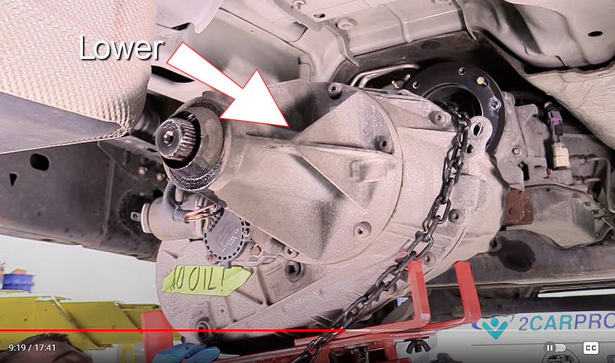

7. Lower Transfer Case: While watching for any wiring, linkages or vent tubes start to lower the transfer case from the vehicle as you steady the load and keep it centered onto the support apparatus. With the old transfer case removed, inspect the mating surfaces on both the transmission and the new transfer case for debris, old gasket material, or damage.
lower transfer case from vehicle
