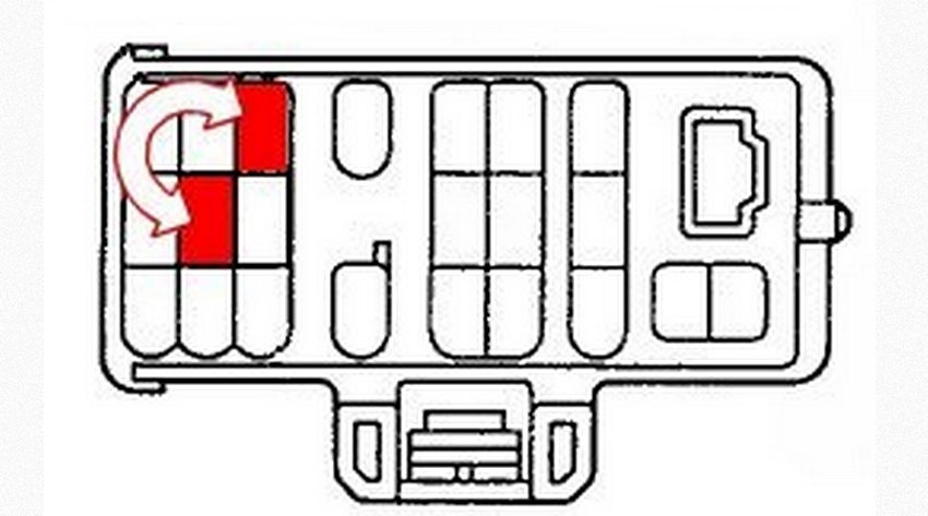

Locate the diagnostic connector under the hood near passengers fender, or under the dash on the driver’s side, it will have a small plastic cover over the connector which is about 1 inch by 3 inches.
Use a small jumper wire to connect the TE1 and T1 terminals, for Tercel and MR2 use the T and E1 terminals.
toyota obd1 connector
