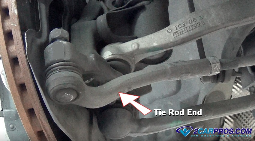

It is easier to replace the tie rod end if the tires have been removed, also the vehicle must be raised and supported on jack stands. In the image below we show you what a tie rod end looks like.
tie rod end

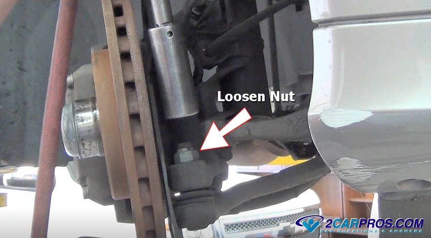

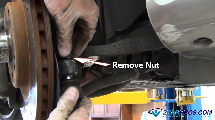

To start, use a wrench or air impact to loosen the tie rod nut at the spindle, leave the nut on about 3 threads to protect the threads and to hold it in place during removal. Because the tie rod is being replaced it doesn't matter if the threads get damaged while removing, but it's good practice while working with steering and suspension parts.
remove tie rod nut

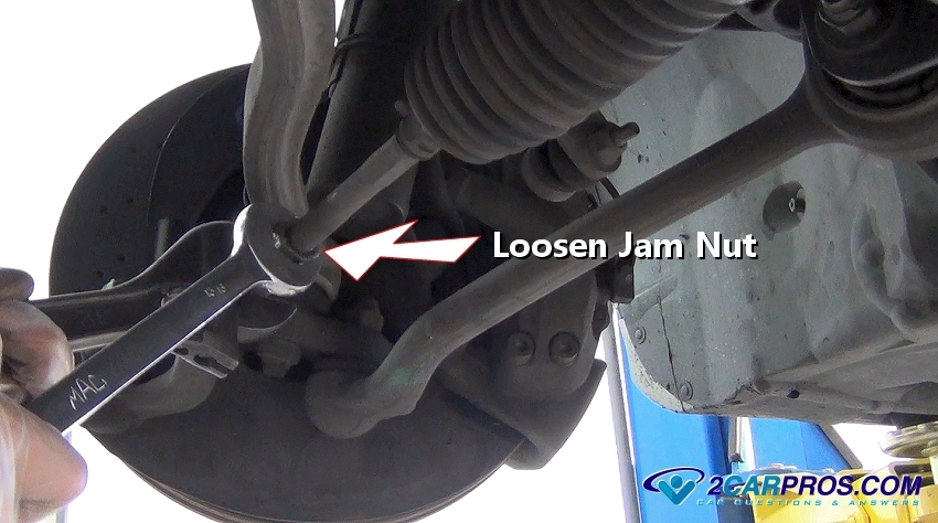

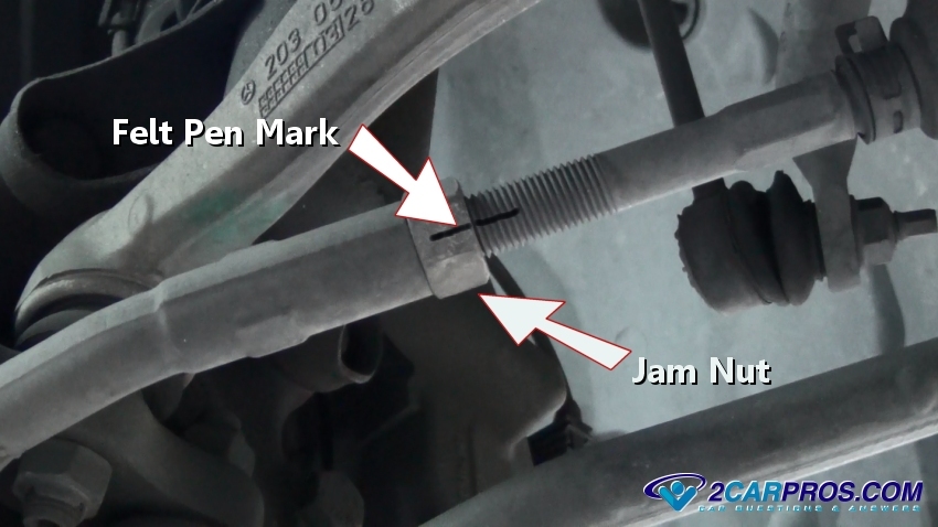

The tie rod has a jam nut which is used to hold the tie rod in place while connected to additional steering components, use a felt pen to mark the position of the jam nut, this will give you an idea on where to position the new tie rod.
tie rod jam nut
Use a large wrench to hold the tie rod in place while using an additional wrench on the jam nut to loosen, in this case the wrench size is 13/16, on some tie rod ends the threads are reversed, tightening will be loosening, so look at the threads to be sure which way to loosen the nut.
loosen jam nut tie rod

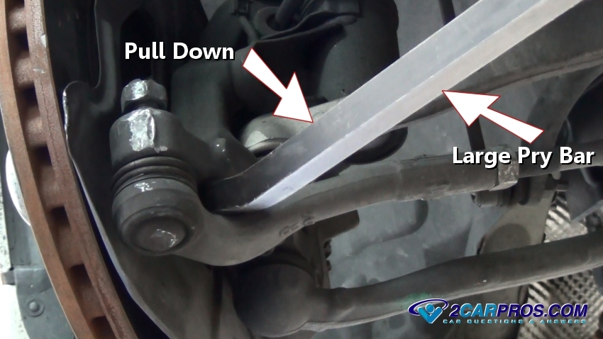

While leaving the nut loose about 3 turns use a large pry bar to apply force and pressure downward.
apply pressure tie rod

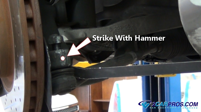

While holding downward pressure on the tie rod end, use a hammer and strike the spindle bulk head to "shock" the taper fit loose.
hammer tie rod end

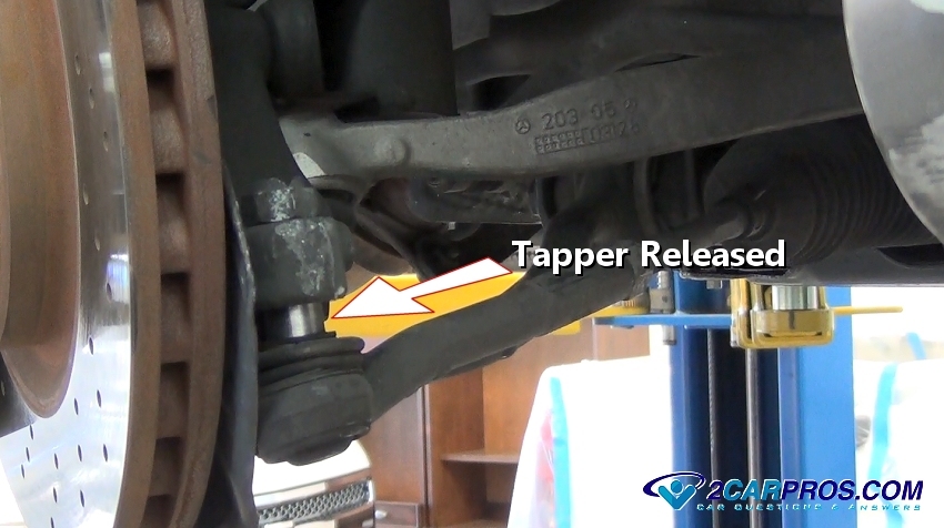

When the taper fit is released it will drop down and show the tapered rod of the tie rod ball.
taper released tie rod

Now you can fully remove the tie rod end nut.
remove tie rod nut

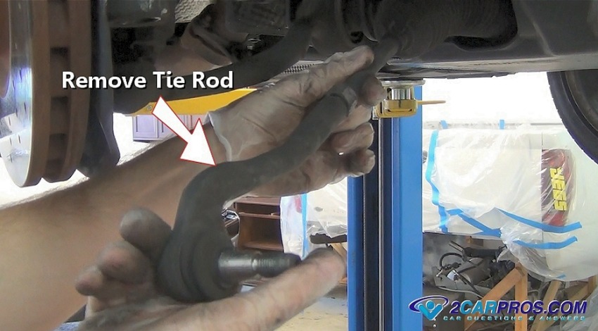

Once the nut has been removed the tie rod will become free and ready for removal, grasp the tie rod and turn either clockwise or counterclockwise depending on right or left hand threads.
removing tie rod end

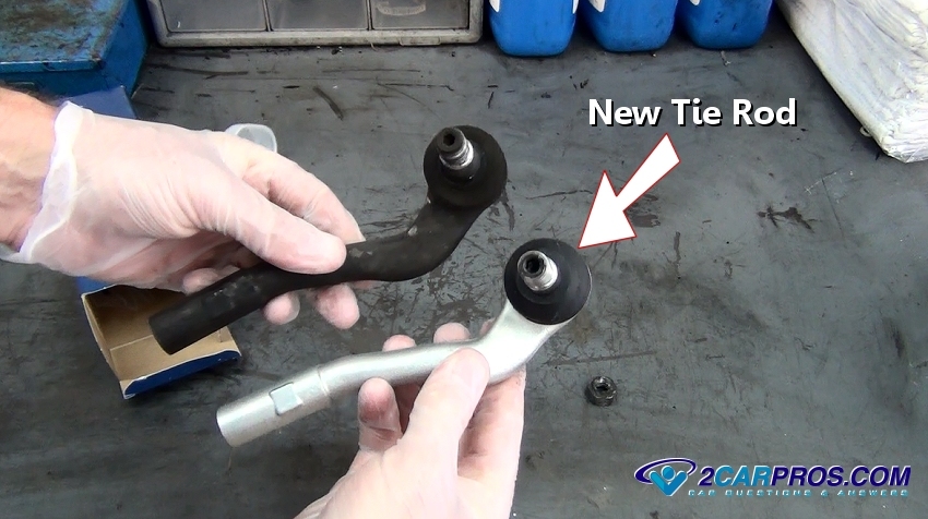

Match the old tie rod to the new unit, they should be identical.
new tie rod

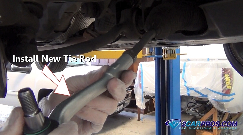

Carefully install the new tie rod into place stopping when the jam nut has been contacted, be sure to keep the location of the jam nut in place.
installing new tie rod

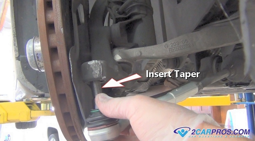

Insert the tapered part of the tie rod end into the spindle bulkhead.

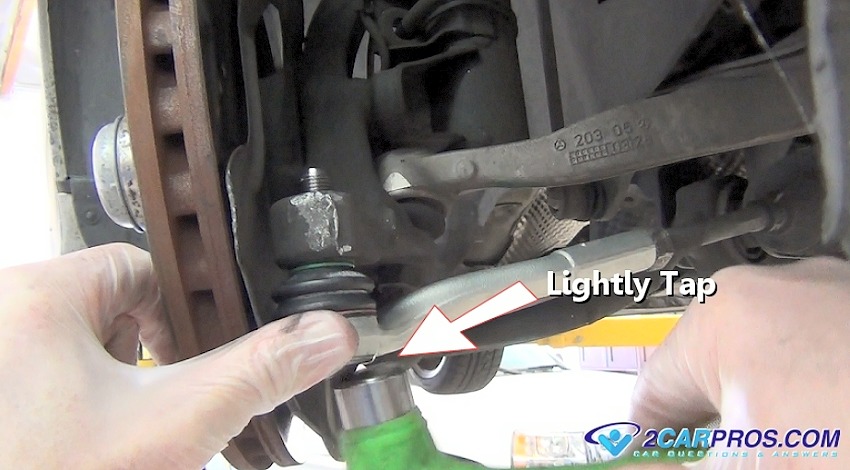

Use a small hammer and tap the tie rod end into place, this will set the tie rod taper which stops the stud from turning while tightening the nut.

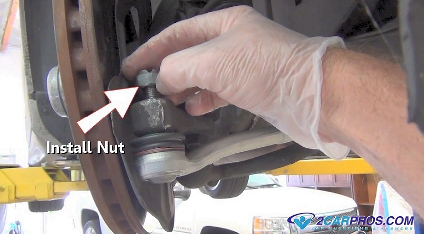

Thread the nut on by hand to avoid cross threading and tighten to spec which in this case is 28 foot pounds of torque. Some nuts will require a cotter pin to be positioned through the nut for additional security.
install tie rod nut

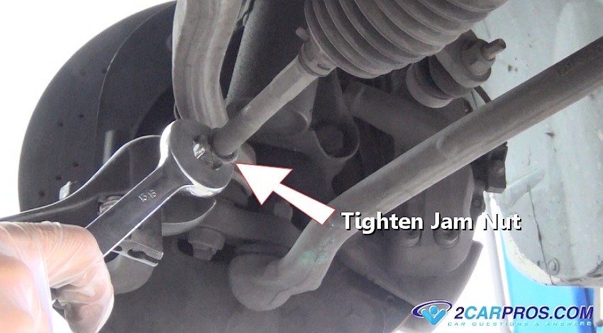

Snug and tighten the jam nut against the tie rod end, there is no torque setting for this nut but we like to say full arm tight, now the vehicle is ready for alignment.
tighten jam nut
