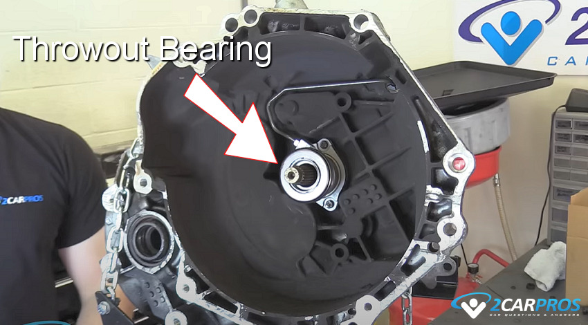

A throwout bearing/secondary cylinder is used to apply force against the clutch pressure plate to release the clutch disc and should be replaced as part of the normal clutch job. Its a good idea to see how a throwout bearing works in its relationship to the clutch, so you can fully understand it's importance. The throwout bearing sits inside of the transmission's bell housing and is held in place by a clutch fork or a secondary cylinder.

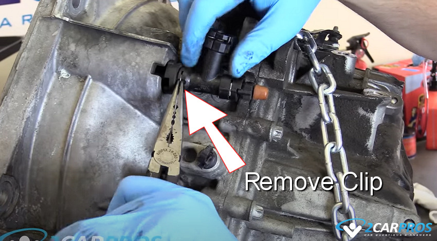

1. Remove Retainer Clip: Use a pair of needle nose pliers to remove the secondary cylinder hydraulic line retainer clips which will free the metal fluid line from the bell housing.

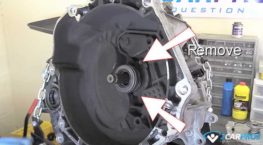

2. Remove Mounting Bolts: There will be three or four mounting bolts that hold the throwout bearing and secondary cylinder to the transmission bell housing that need to be removed, in this example the bolts are a 35 torx bit.

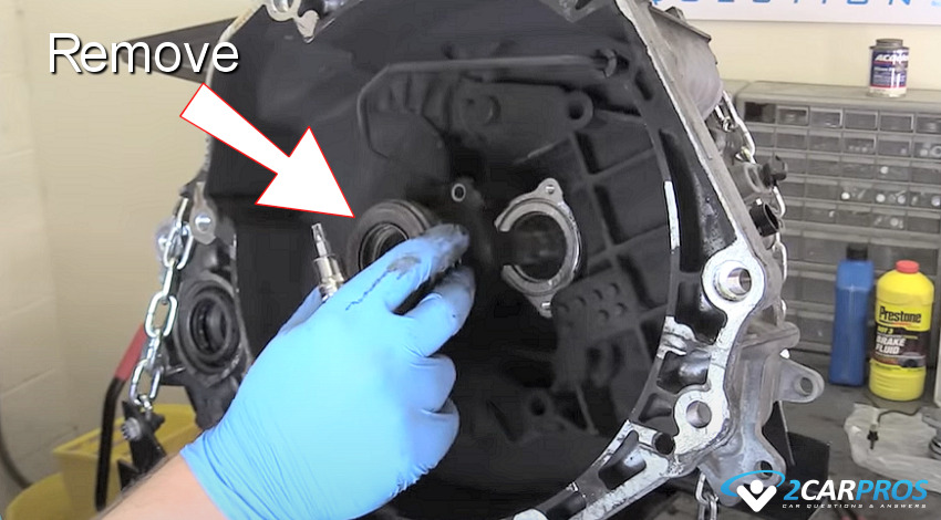

3. Remove Throwout Bearing/Secondary Cylinder: Grasp the bearing/cylinder firmly and pull outward from the input shaft bearing retainer, you may need to remove a plastic clip which supports the hydraulic clutch line. At this point the bearing may already be in pieces if it has failed, be sure to remove all remaining bearing parts. Match the old bearing/cylinder to the new part which should match identity.

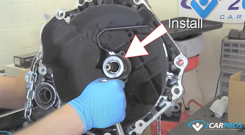

5. Install New Throwout Bearing/Secondary Cylinder: Install the new part and hand thread the mounting bolts to avoid cross threading. Using a socket evenly tighten the mounting bolts to factory specifications which is usually between 7 to 12 foot pounds. Reinstall any plastic clips that were removed in the process to re-secure the hydraulic line. Spin the bearing by hand to make sure it moves freely and with no irregular noises. The new bearing and cylinder is ready for the transmission to be reinstalled.
