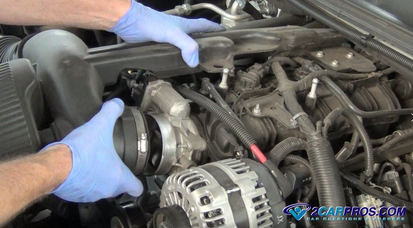

Locate the air intake tube and loosen the clamps and mounting bolts to remove it. (Leave the wiring connected if newer than 2009). Older vehicle's utilize a throttle cable which must be removed, along with transmission and cruise control cables.
remove air intake tube

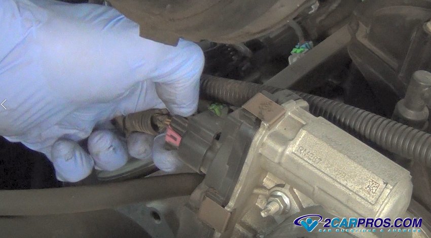

Remove the actuator wiring connector which could have a safety clip that will need to be removed before the connector can be disconnected if applicable.
remove throttle actuator connector

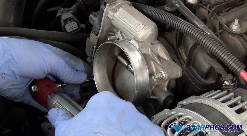

Some actuators have coolant running through them which will need to be drained and then refilled once the job is complete. Disconnect the hoses and continue removing the mounting nuts. Remove the sealing gasket or "O" ring seal and clean or replace. Use a carburetor cleaner and a shop towel to clean the intake inlet.
Clean the throttle actuator bore housing and butterfly both the front and rear sides including the pivot shaft. Looking at the rear of the throttle bore coking deposits, again this is caused by impurities in the air causing the engine to idle erratically etc. After re-installing the throttle bore, re-insert and evenly tighten mounting bolts or nuts and tighten to spec which in this case is 4 foot pounds of torque. Reinstall vacuum, bypass and breather tube lines while reconnecting the electrical connectors if applicable. Reconnect throttle cables and reinstall the air intake boot, clear any codes if necessary. The engine could start a little rough because of excess cleaning solvents that remain, it should clear up within 15 seconds.
