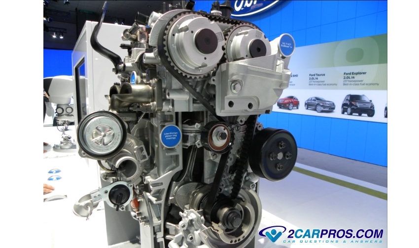

1. Broken Timing Belt or Chain: Every car engine needs a timing belt or chain to keep the camshaft in correlation with the crankshaft. When these parts fail the camshaft stops turning which causes the intake and exhaust valve not to open and close. Without the camshaft rotating the engine cannot make compression and timing belt or chain must be replaced. In the example below there is timing belt which is made of rubber and will usually fail at about 110,000 miles.

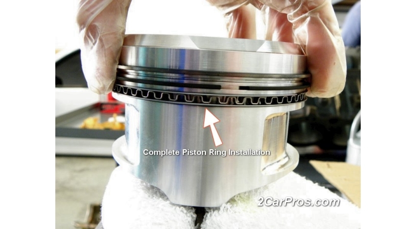

1. Worn Piston Rings: Each piston has a set of rings that help seal the piston to the cylinder walls. These rings include a top ring that handles most of the sealing, a secondary ring that help catch what the first ring misses and an oil control ring that helps wipe anyway engine oil which is splashed onto the cylinder walls while the engine is running. As miles are put on an engine these rings will wear at a common rate between all cylinders and fail about the same time which is a sign that the engine is worn out and the rings will need replacement.

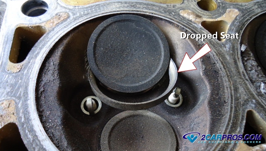

1. Dropped Valve Seat: A valve seat is a super hard metal ring that is pressed into the cylinder head. Most cylinders heads are made of aluminum and expand from heat at a different rate, compared to the metal valve seat. This variance in expansion rate can cause the seat to fall out of the head. Once this has occurred the cylinder will have no compression as the air escapes into the valve port. Once detected the cylinder head must removed and replaced or repaired.

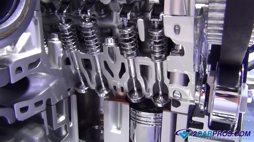

4. Broken Valve: An intake or exhaust valve is constructed into two parts, the stem and the head. The stem protrudes through the cylinder head and connects to the valve spring while the head of the valve seals against the valve seat. When these valve parts fall apart, the head will drop from the stem and allow compression to leak from the cylinder while causing extreme damage to the piston and cylinder head.
