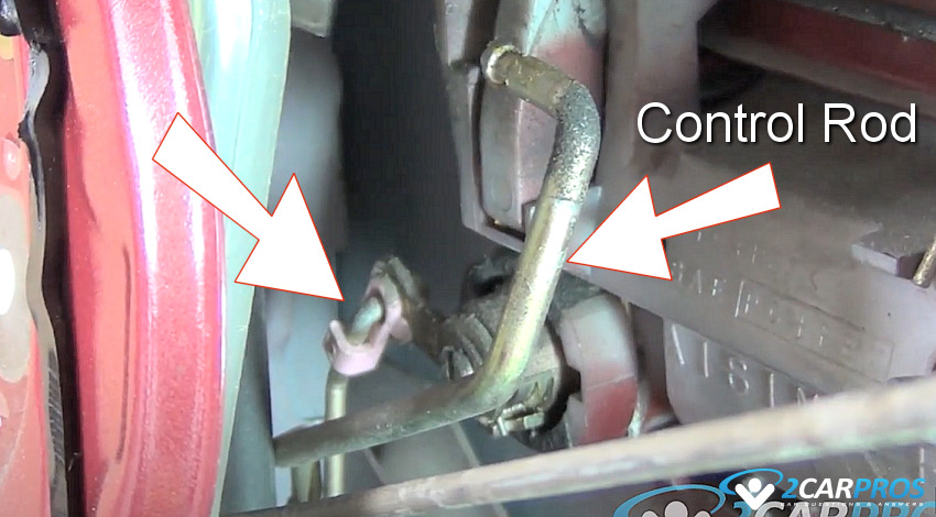

1. Remove Control Rods
Use a flashlight to locate the inner door access and locate the main handle control and lock rod and un-clip them.
door lock tumbler control rod

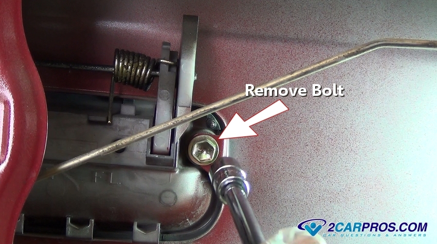

2. Unbolt Outer Door Handle
Using a 10mm socket or wrench remove the inner door handle lock mounting bolts, this will vary with each manufacturer. Some applications offer a door handle mounting bolt access hole which can aid in the removal.
remove door handle bolt

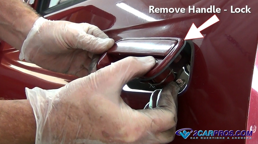

3. Remove Outer Door Handle
Place masking tape around the door handle to avoid damaging the paint. Once the mounting bolts have been removed, gently grasp the handle and lock assembly and lift up to remove it. This can take some jostling so be careful not the scratch the paint.
remove outer door handle

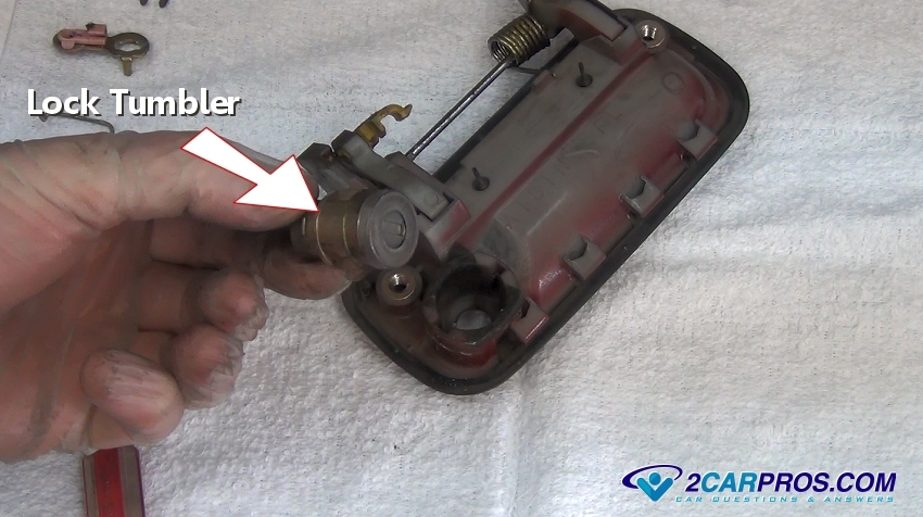

4. Door Lock Removal
Use a small screwdriver, or pick remove the retainer clip that holds the lock inside the handle housing, the lock cylinder will become loose and ready to be removed. Push the lock tumbler out from the outer door handle and use a shop towel to clean the handle cylinder to get ready for the new lock to be installed.
door lock tumbler removed

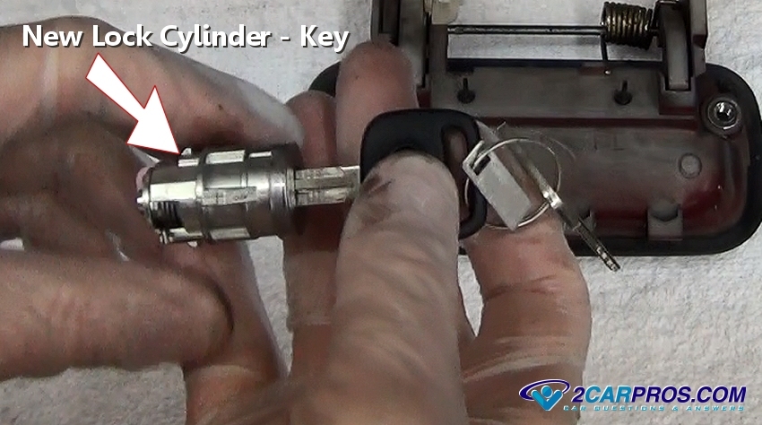

5. Install New Door Lock
A new key will be included with the new lock assembly that will be different than your old door key, (If you want the same key, the lock will need to be taken to a locksmith with the old key and rekeyed). Gently insert the lock into the door handle being careful to line up the keyway timer in the handle, this is so the orientation of the lock is correct. Grasp the lock clip and slide it back into place. Once the control rods are connected, use the key and work the lock to confirm it's proper operation, operate the door handle as well. To reassemble just reverse this order and you are all set, happy wrenching!
