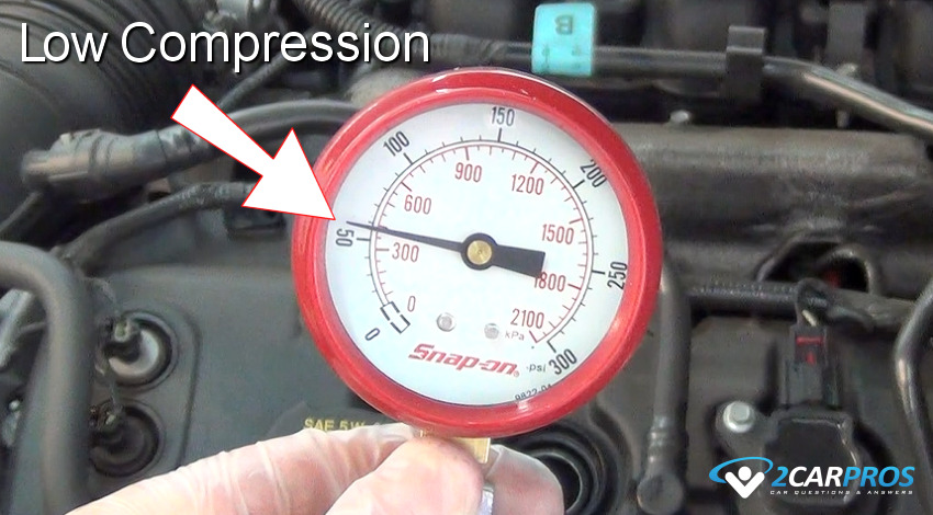

1. Check Engine Light: The car's computer system can detect if a cylinder is misfiring which can be caused by low compression, for example: If you get a P0301 code it means cylinder #1 is having a misfire issue. The normal course of action is to replace the spark plug, fuel injector and ignition coil but, if these repairs do no fix the problem the next step is to check for low compression.
2. Engine Misfire: Compression is essential for the combustion process and will make an engine cylinder misfire is the compression is too low, (below 90 psi). Misfires will trigger the check engine light and may feel like a jerking or stumbling sensation during driving.
