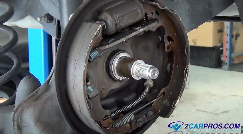

There are four brake shoes per car, two on each side, right and left. These shoes are forced against the rotating brake drum via the brake system to slow the car down in a braking event. Friction material is mounted to the metal frame of the brake shoe and it what wears out as the car is driven. The activation of the emergency brake uses the same principle of forcing the shoes outward against the drum helping to hold the car in place. Vehicles with rear disc brakes will use a smaller drum brake in the center of the rotor for the emergency brake.

Performing a Visual Inspection
If you are unsure of the brake shoe condition it is best to remove the tire and then the brake drum to inspect the shoe linings directly. Check the thickness of the friction material. If it's less than 1/8 inch (3 mm), it's time to replace the brake shoes. Also, inspect the surface of the brake shoes for cracks, glazing, or contamination with oil or grease. Please follow this guide for more information - Brake shoe replacement guide
