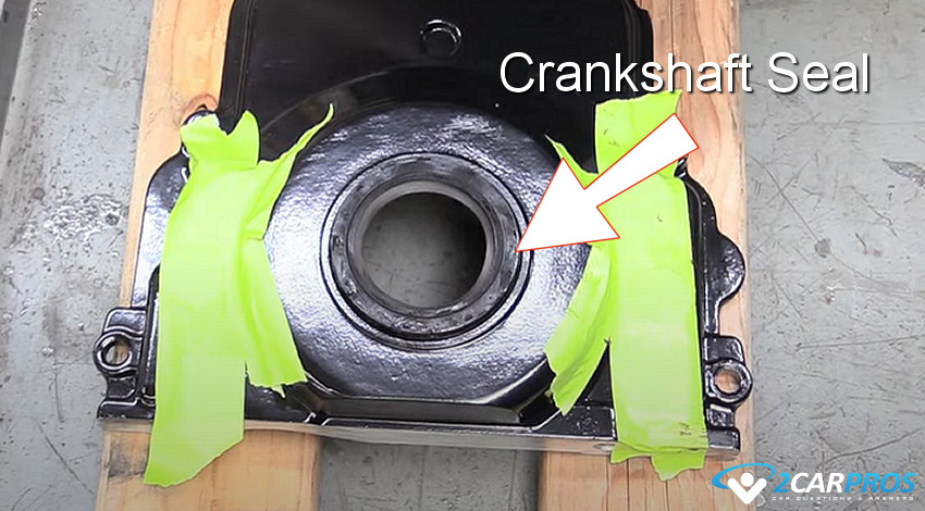

A crankshaft seal located at the front and rear of your car's engine, and is designed to control motor oil from leaking as the engine is running and the crankshaft is turning. There are two main seals, the front seal which is located in the timing chain cover or front seal plate, and the rear main seal which is located at the rear of the engine block mounted within the seal plate which also bolts to the oil pan. In this guide, we will cover the detailed symptoms of a front main seal leak and how to diagnose it.

The most common symptoms of an main shaft oil leak is obviously, oil leakage. Raise the front of the car up and use a flashlight to confirm the oil leakage is coming from the front or rear seals. Though you might find oil leakage in a particular area, you will not be able to see the "rear" main seal directly, but most of the time the front seal is visible. If the rear main seal is leaking oil will drip from the transmission bell housing.
If the front seal is leaking you will be able to see oil dripping from the crankshaft pulley, harmonic balancer, or timing cover. If the leak continues, it will affect the serpentine belts ability to perform and you will lose water pump, alternator or AC compressor operations. If the problem is further neglected, oil will begin to saturate the cooling hoses and cause a coolant leaks which will cause engine overheating.
