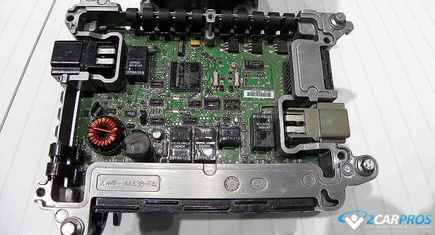

2. Bad Fuel Injector or Ignition Coil Drivers: The engine computer is designed with electrical drivers which act like switches inside the computer's circuit board. When one of these drivers goes bad the engine will misfire or stall out completely, this is can be checked by testing the output voltage of these circuits to confirm the failure in which case the engine computer will need to be replaced.
3. Multiple Codes: When there is an error or glitch in the computer firmware it can trigger several codes at once, one of the more popular occurrences of this problem is to get codes for all four oxygen sensors at once on a v8 engine. Since it is virtual impossible for all oxygen sensors to go bad at once, the computer is to blame.
4. Dead Computer: If the computer power and grounds sources have been confirmed and are working correctly included the data port connector, the computer has died. This can happen due to vibration or an electrical surges caused by the alternator, battery or starter. Rain and humidity will also take it's toll on these items.
5. Reduced Fuel Efficiency: Inside the engine computer is a mapping program which tracks various sensors to optimize the fuel delivery and ignition timing. When these maps fail to update or stop optimizing the fuel mileage will suffer, often without a code.
6. Failed 5 Volt Reference: On the sensor side of the engine computer, a 5 volt circuit is used to provide power to the various sensors within the computer network. This 5 volt network system is unique to the engine computer which provides this lower voltage via an internal transformer which can fail rendering the computer no good.
