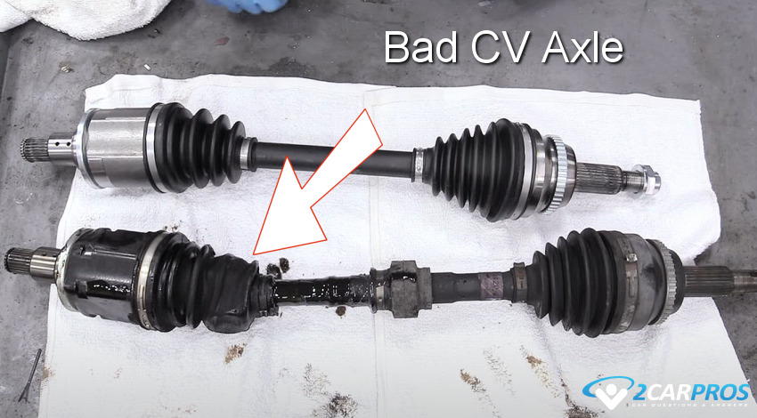

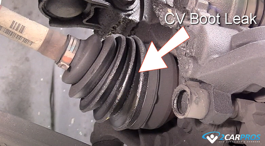

Most of the time when a CV axles goes bad it will do so in one of two ways, the CV joint will wear out and make noise/vibration, or the CV axle shaft will break and stop the vehicle from moving. Though there is not much that can be done to prevent the shaft breakage inspection can help prevent a failure. The CV joint is protected by a grease retaining rubber boot, this boot should be inspected to ensure there is no leakage. Look for grease splattered around the wheel well or under the vehicle. If you see any signs of grease as in the image below the CV axle should be replaced.
