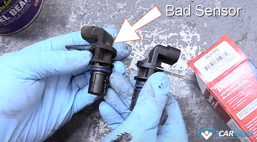

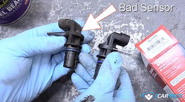

Sensor Failure With No Codes!
That's right! This sensor can fail and not have any codes, here is why:
If the engine is cranking and the computer does not see engine rotation, it will assume there is some kind of mechanical issue such as a broken crankshaft. Even thought the sensor is not working, the computer will not know this even though the engine will not start. This is because there are some things that can stop the crankshaft position sensor's signal that will have nothing to do with the sensor going bad, such as running out of gas, transmission operation problem, (converter clutch stuck on) or stalling the engine by letting the clutch pedal out too quickly.
Failure When Hot!
As with all sensors, heat can play a roll in their performance because of the thin wire windings which can expand with heat and short out to one another greatly changing the sensors resistance, stopping the signal to the engine computer. Once the sensor cools down, it can start working again, the most common failure for these sensors is when the engine is idling, it will just stall. This is because the pulse-width is at its widest at slower engine speeds.
Scanner Readings
It is easy to check if the crankshaft sensor is working using a scanner. Simply plug the scanner in and follow the prompts until you find "crankshaft revolutions" which should be at zero, then crank the engine over and it should give a reading of 120-300 RPM if the sensor is working, (cranking speed). Though you can test the sensors resistance using a voltmeter, the true way to test the sensor is to use an oscilloscope and check the waveform when the sensor is hot, the sign wave should be clean and clear.
