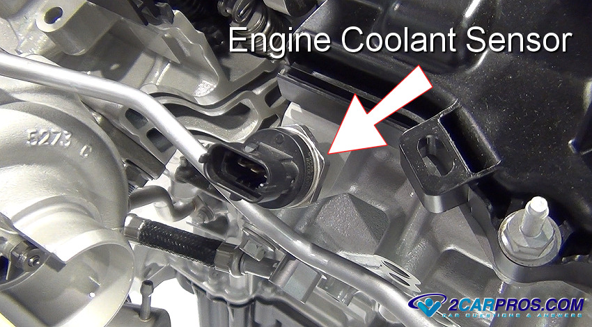

Introduction
An automotive engine coolant temperature sensor, (ECT) sensor, or sometimes called a cylinder head temperature sensor is used to generate feedback information to the PCM while make adjustments to the fuel mixture, cooling fan operation and ignition timing. When this sensor goes bad it can cause various issues that we will go over in the following guide which outlines the symptoms of a bad engine coolant sensor, helping you diagnose, address and repair potential problems.
