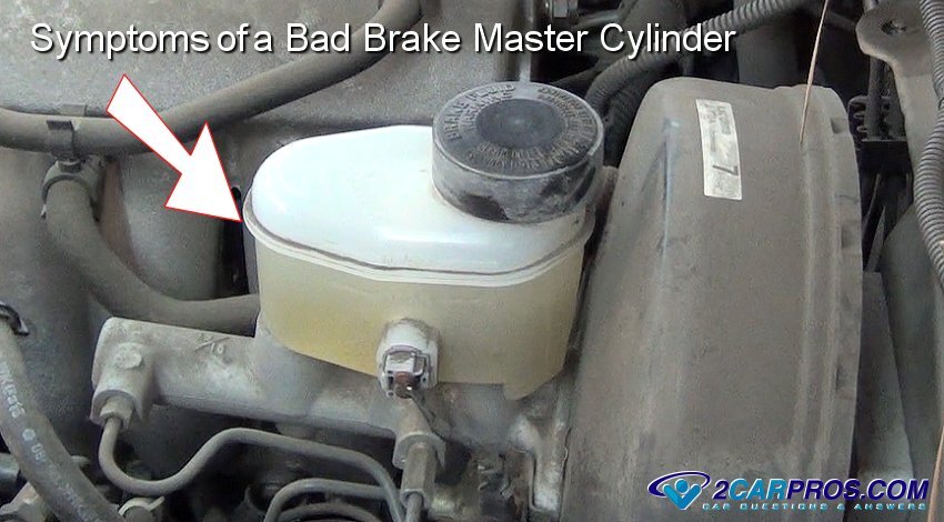

The brake master cylinder is at the heart of the automotive braking system which is responsible for converting the physical force from the brake pedal into hydraulic pressure to engage the brakes, when this part goes bad it can hinder the braking performance which is a safety hazard. In this guide we discuses the failures and what to look for when this brake components goes bad.

The brake master cylinder has two main places it can leak form, one is the main seal at the rear of the unit and the other is the seals that attach the fluid reservoir to the brake master housing. When the main seal fails it can fill the brake vacuum booster with brake fluid, at this point the vacuum booster should be replaced as well. This can be detected by using a flashlight to inspect the rear of the master cylinder and the bottom of the brake booster.
