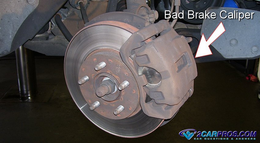

A hydraulic brake caliper is used to help stop your car by converting hydraulic pressure that forces the brake pads onto the brake rotor. When this part goes bad it can hinder the braking performance of the car and cause safely issues. In this guide we go over the potential problems the brake caliper can cause.
What Goes Wrong?
A caliper will typical leak between the piston and seal, or the piston will seize in the caliper bore causing the brake to lock up and not release.

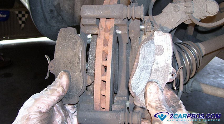

Uneven Brake Pad Wear:
Most brake caliper are "floating" meaning they can move in a linear fashion. This allows the brake to apply force and then release, if the caliper slides have friction due to lack of lubrication it will cause irregular braking or pad wear characteristics.
uneven brake pad wear
