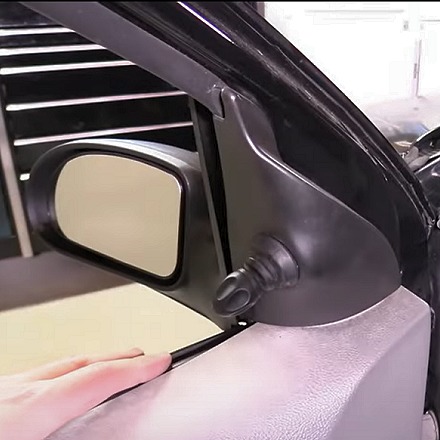

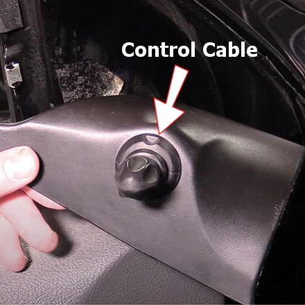

There will be electrical wires or a control cable which adjusts the mirror position inside the mirror's housing, here is what it looks like in this case.
mirror control cable knob

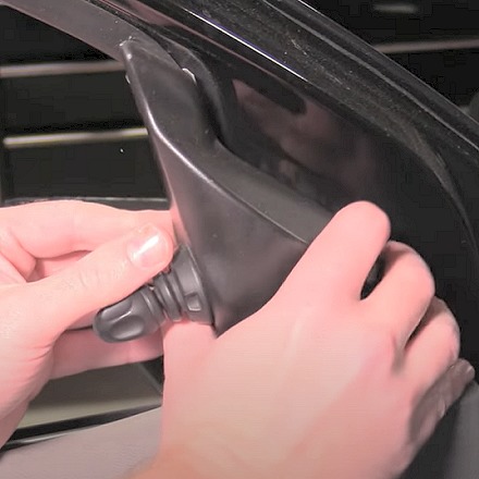

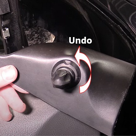

Remove the cable by twisting the retainer counterclockwise, this can be done by hand or you might need a pair of pliers to help.
mirror control cable knob undo

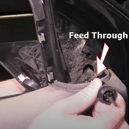

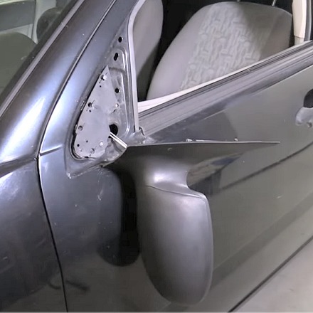

Because the mirror in this example is broken off, the only thing holding on the car is the control cable which now can be fed through the access hole.
mirror control cable feed through

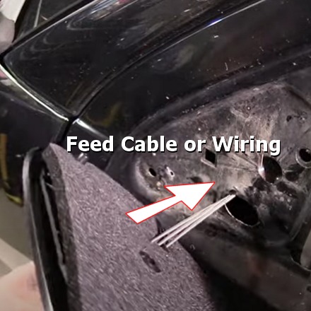

Match the new mirror to the old unit to make sure they are the same, then feed the control cable or wiring harness through the access hole.
install new mirror controls

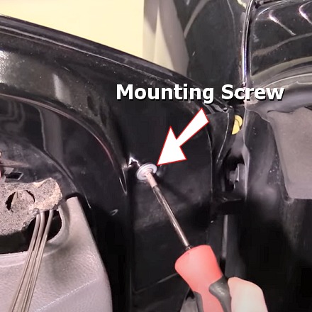

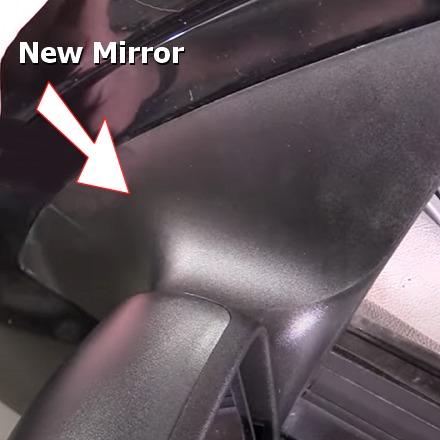

Push the new side view mirror into place while aligning the plastic tangs with the matching door holes.
While holding the mirror from the outside, install the mounting bolts or screws to hold the mirror from falling, wait until all screws or bolts are threaded before tightening them. A torque spec is not provided for this repair, so remember the mirror is plastic so be careful not to strip out the threads.
mirror mounting screw installation
Reassemble and tighten the control cable and plastic bezel, then pop the bezel into place and you are all set.
new side view mirror installed
