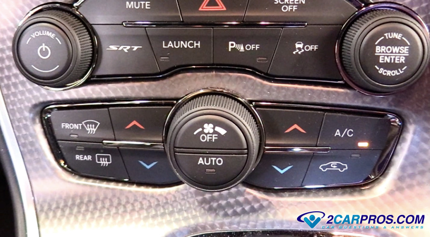

Resetting the HVAC System
1. First, make sure the ignition switch or system is shut off. This will power down the HVAC system and begin the rebooting process, allow the car to sit for about 30 minutes.
2. Locate the interior fuse panel which should be under drivers or passengers side of dashboard in most cars, some fuse panels will be in the trunk as well.
3. Inside the fuse panel there will be one fuse labeled "HVAC system" or "AIRCON" each manufacturer labels their systems differently, this is why you need an identification label on the fuse panel or owners manual. If you do not have either of these, fear not, you can ask one of our experts, we are happy to help.
4. Once you have located the fuse, use a pair of needle nose pliers to remove the fuse.
5. Turn the ignition system on without starting the engine, allow the car to sit for about 5 minutes. This will tell the HVAC computer that the rebooting process has begun.
6. Turn the ignition system off and replace the HVAC system fuse.
7. Turn the car back on and start the engine, then power on the air conditioner and adjust the temperatures to the max settings, and do the same for both the defroster and heater. This will run through the "maximum" parameters for the vent position and temperature settings. You might hear noises as the process continues while calibrating which is normal.
