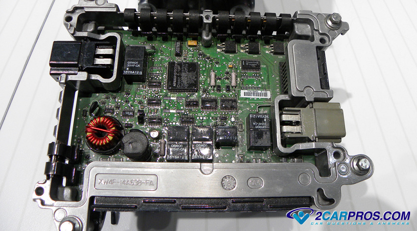

There are various levels of a hard rebooting due to the number of capacitors in any given module. If a device has many capacitors it can take longer to reset and may need a more abrupt reboot, we will go over the simplest method to most extreme.
Method 1. Disconnected the Battery: This is the most basic reboot method, simply remove the negative (-) battery cable over night to ensure the capacitors within the electrical systems are discharged. Then reconnect the battery cable in the morning, this works well for security system issues.
Method 2. Turn Ignition System On: With the battery disconnected, turn the ignition system on either by turning the key or using the push button. Nothing will seem to happen, which is normal, but internally capacitors are being drained to help erase system memory files. This only needs to be done for about 10 minutes, then turn the system off before reconnecting the battery. You can also push the horn, or turn on the headlights as well.
Method 3. Connected Battery Cables: This is the most abrupt reboot process meant for the last resort. This will quickly drain all capacitors, remove the negative battery cable form the battery. With the negative cable disconnected use a jumper wire to connect the negative cable to the positive battery cable. This will not cause a short circuit because the battery is disconnected from the car. Leave the jumper wire connected for 5 minutes and then remove and reconnect the battery, this should reset everything to factory presets and allow the systems to reboot to start the adaptation process.
