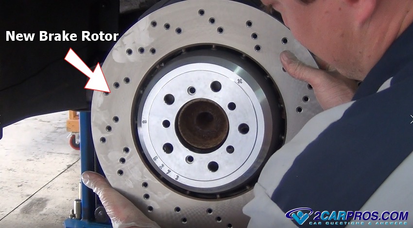

Brakes Applied: If the steering wheel shakes when the brakes are applied it means the front brake rotors can be warped due to excessive heat from heavy braking or normal wear. To check for this problem, remove the tire and rotate the brake rotor by hand, the rotor should move freely without hard spots, this problem is easily fixed by replacing the front brake pads and rotors. For specific instructions on your car, please ask one of our experts to help, it's free.

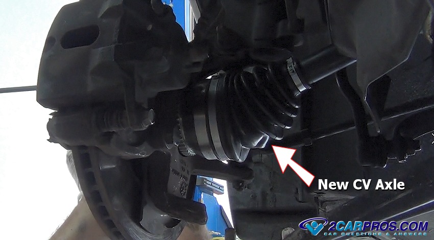

Slow Speeds While Turning: This issue is for front wheel drive cars only, there are right and left side CV axles which drive the front wheels of your car, when a CV joint starts to go out it will try and lock up forcing the steering wheel to move back and forth until the wheel is straight. To confirm this issue remove the CV axle to check the CV joints movement capabilities, the joint should move freely in all directions and if not the CV axle must be replaced.

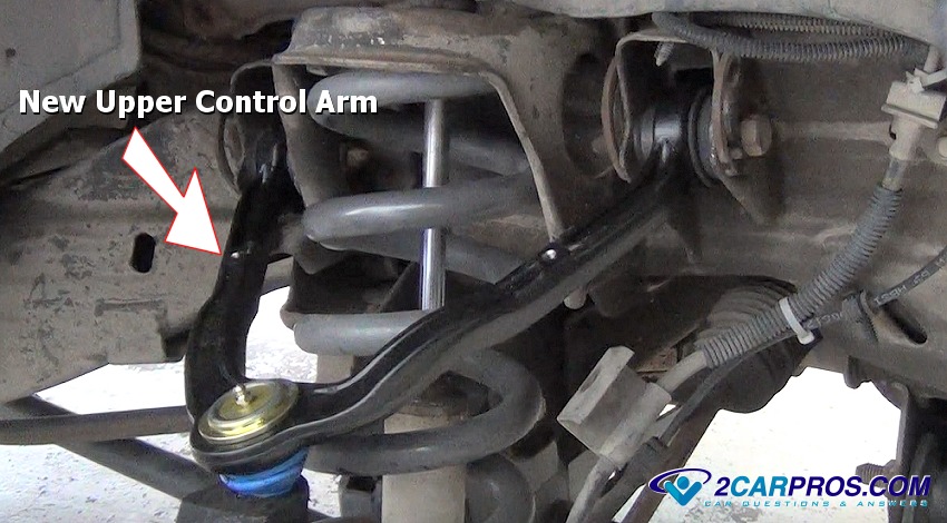

Bumpy Roads: Control arms are used to hold the spindle steady while the vehicle is in motion. These arms are constructed with bushings and when they fail it allows excessive movement causing a shake in the steering wheel. To check for this condition raise the vehicle using stands for safety and while using a flashlight inspect the rubber bushings where the control arm attaches to the frame, if the rubber has started to bulge or is missing the control arm must be replaced.
