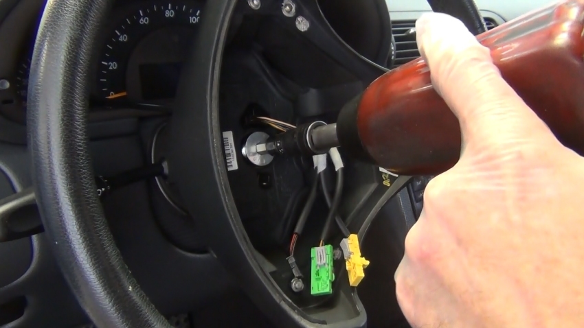

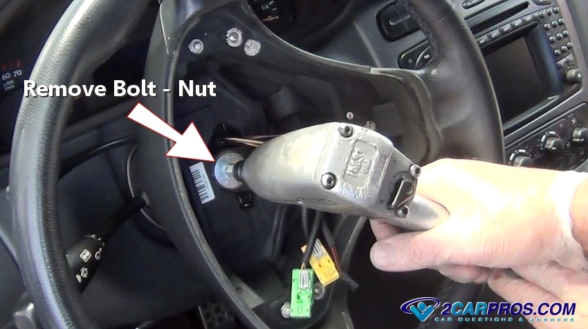

Locate the steering wheel mounting bolt or nut, usually if the wheel is held on by a bolt, no puller is required. An air impact gun makes this step easier but is not necessary, loosen the bolt by turning it counterclockwise.
remove steering wheel mounting bolt

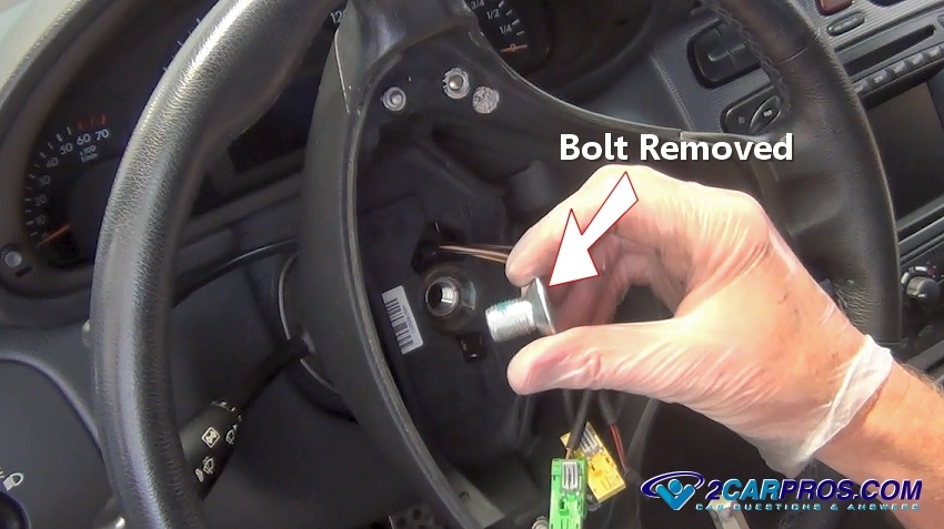

Once the bolt has been removed, inspect threads for damage and store the bolt in a safe place. These fasteners are specific for each manufacturer so replacements can be troublesome.
steering wheel mounting bolt removed

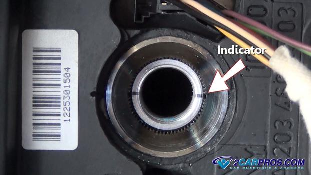

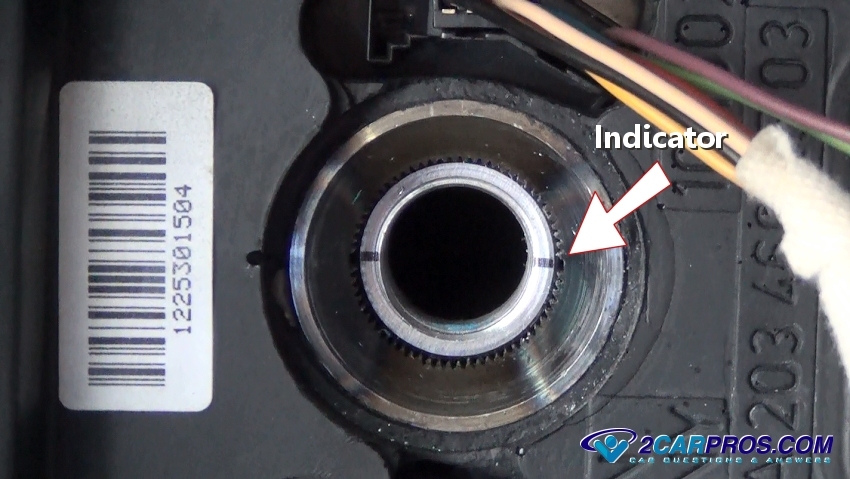

To locate the steering wheel correctly upon the steering shaft, look for an alignment indicator which is used when the wheel is re-installed, if no marks are found create a visible mark for your own reference, some steering shafts are equipped with a flat spot so no marks are needed.
steering wheel indicator

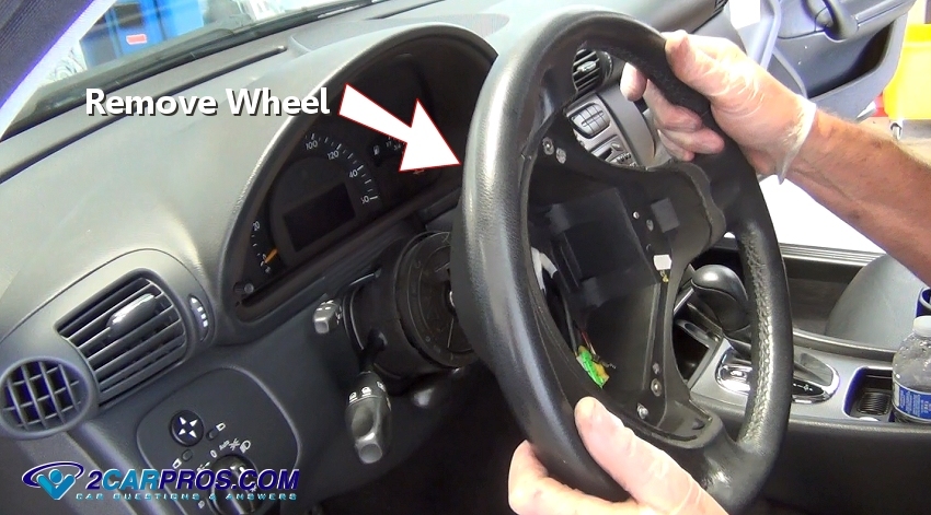

Firmly grasp the wheel and pull outward, it will side off the steering shaft and become free, if your steering wheel requires a puller there will be two threaded bolt holes near the main mounting nut.

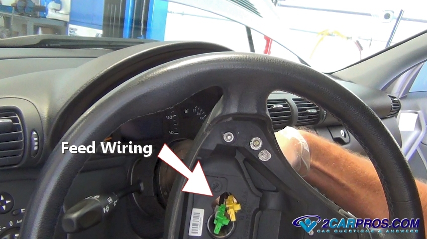

Once the wheel is loose, carefully feed the wiring harness and connectors through the access hole in the center of the wheel.
feed wiring through steering wheel

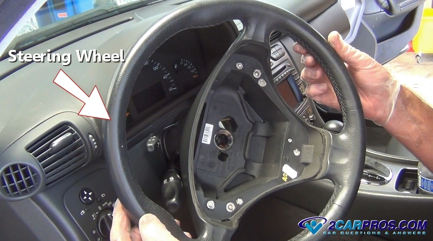

After further repairs are completed, or if you are replacing the steering wheel, match the steering wheels to each other.
steering wheel removed

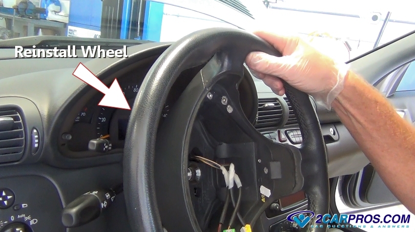

The steering wheel is ready to be re-installed, gently feeding the wiring and connector through the access hole in the wheel. While noting the alignment marks, gently place the steering wheel onto the column shaft.
reinstall steering wheel
The indicator marking should be aligned to avoid the steering wheel being offset while driving straight.

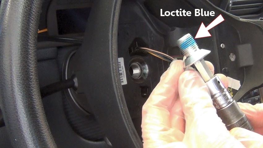

Apply a thin layer of lock tight (blue) on the mounting bolt, this will prevent the bolt from backing out and becoming loose.
loctite blue

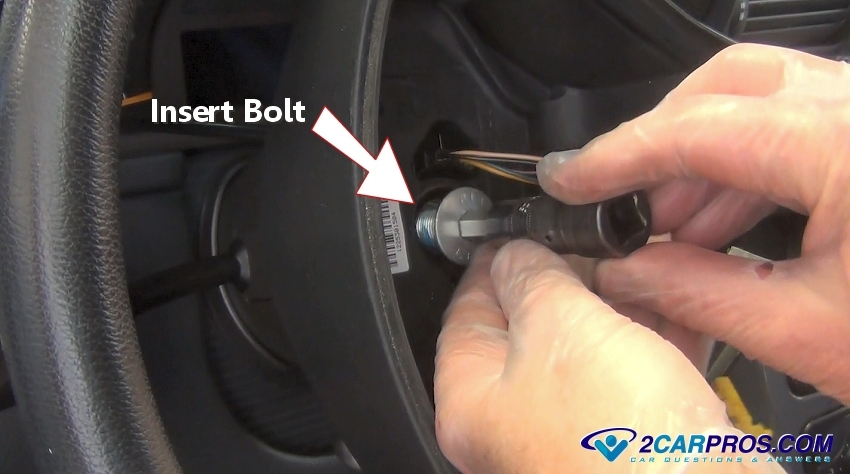

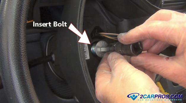

Insert the mounting bolt or nut by hand to avoid cross threading.
insert steering wheel mounting bolt
Tighten the mounting bolt or nut to the manufacturer's recommendation, usually 50 to 60 foot pounds of torque.
tighten steering wheel mounting bolt
