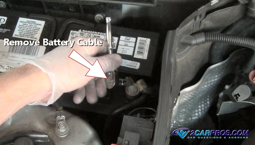

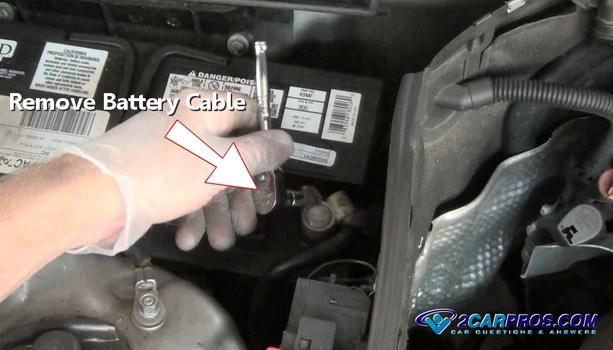

1. Remove the Negative Battery Cable: You must start the air bad clock spring removal by disconnecting the negative side of the battery. This will help prevent electrical short circuits while the job is being done. After the battery has been disconnected wait 5 minutes to make sure the airbag safety system has powered down.
remove negative battery cable

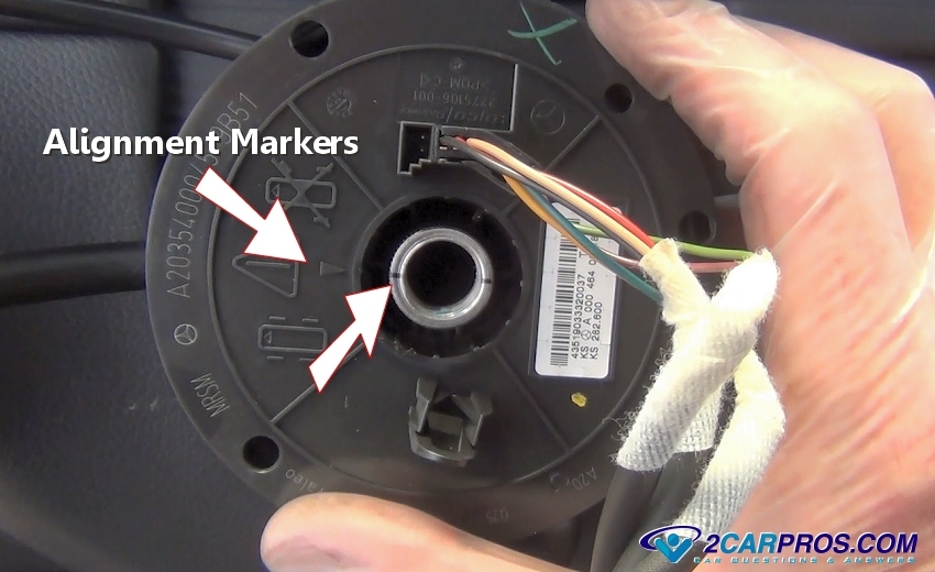

Take note of the alignment markers of the clock spring and the steering column shaft. These marks must be close when reinstalling the clock spring.
steering wheel clock spring alignment marks

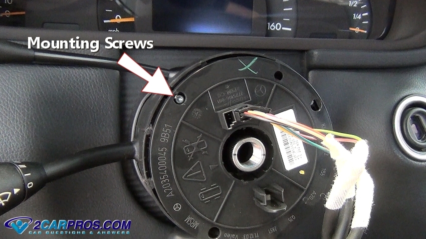

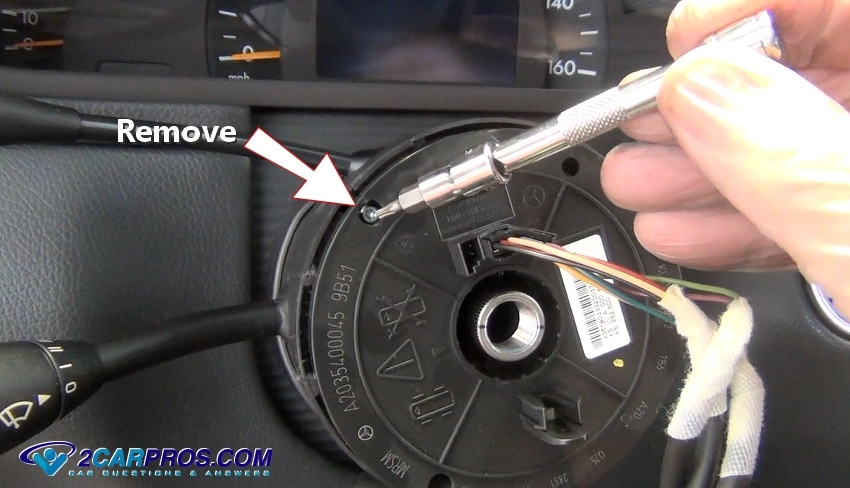

Locate the clock spring mounting screws which will be accessed through a series of small holes. The clock spring outer plate may need to be rotated slightly to access the screws. These screws are a number 15 Torx head.
Using a Torx head screwdriver or socket to remove the mounting screws by turning them counterclockwise. Use caution as not to drop the crews down inside of the steering column.
remove steering wheel clock spring mounting bolts

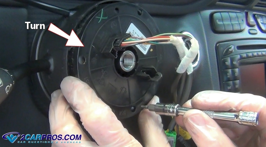

The top plate may need to be moved slightly in either direction to access all of the mounting screws.
turn steering wheel clock spring

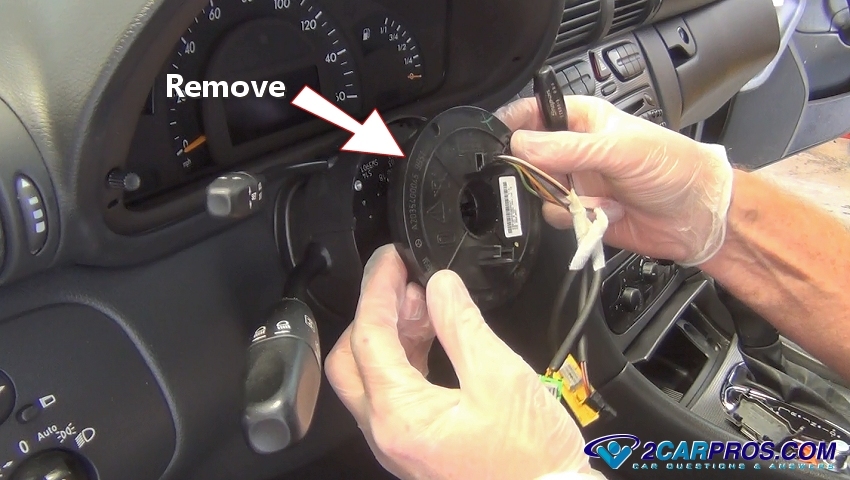

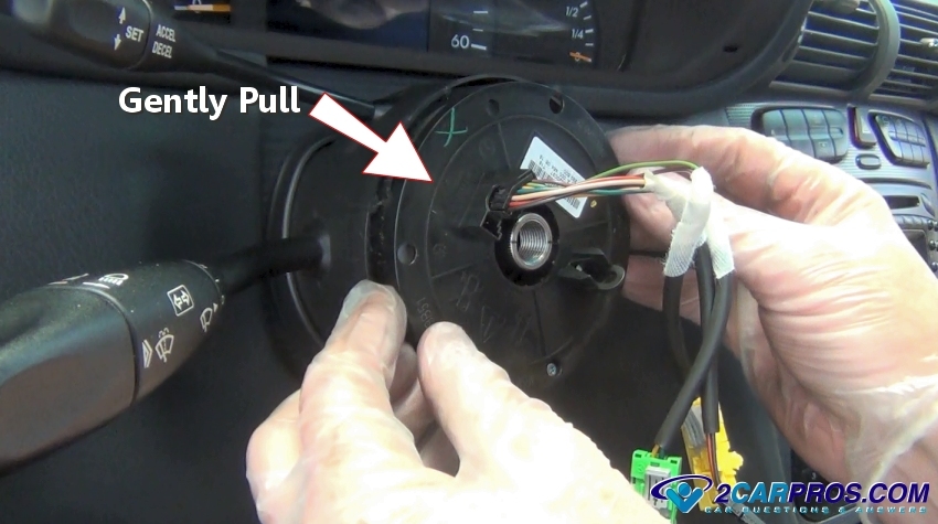

Once all mounting bolts have been removed gently grasp the clock spring and pull it from the column shaft. Some designs have a lower wiring harness that will need to be disconnected near the bottom of the column before removal. This particular unit just plugs into a lower connector.
gently pull steering wheel top plate

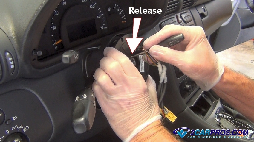

Using a small pick or screwdriver to release the plastic retainer clips while pulling the unit outward. This is required on some models.
release retainer steering wheel clock spring

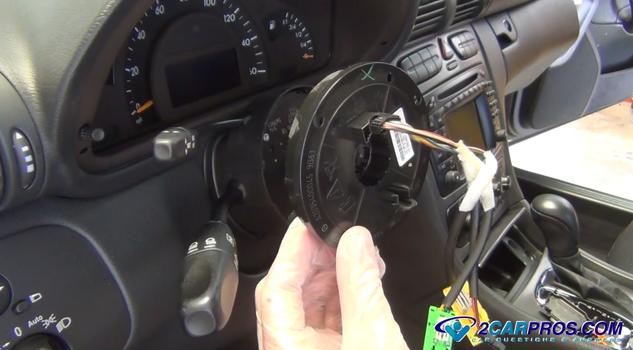

Gently work the clock spring back and forth and outward from the steering column shaft and gently remove.

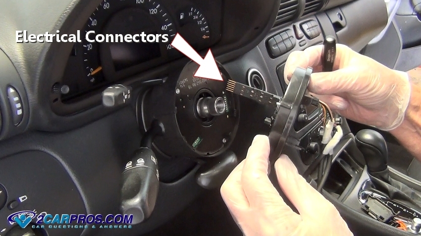

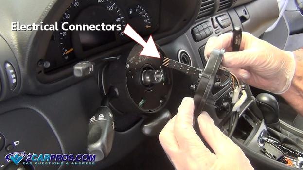

Electrical connectors are attached to the bottom of the airbag clock spring to transfer signals and controls to the steering wheel and airbag. This can also be a wiring harness on some models.
steering wheel clock spring electrical connectors

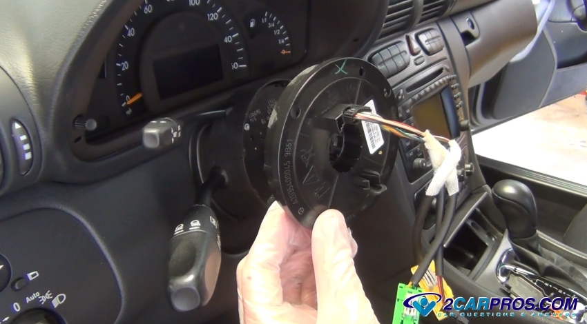

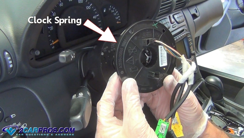

Once removed inspect the clock spring for damage. When replacement is required match the new part to the old part, they should match identically. It is sometimes difficult to tell visually if the unit has been damaged because the wires are all internal. Amazon is a great place to get a replacement part. If they don't have it you will need to visit the dealer.
steering wheel clock spring removed

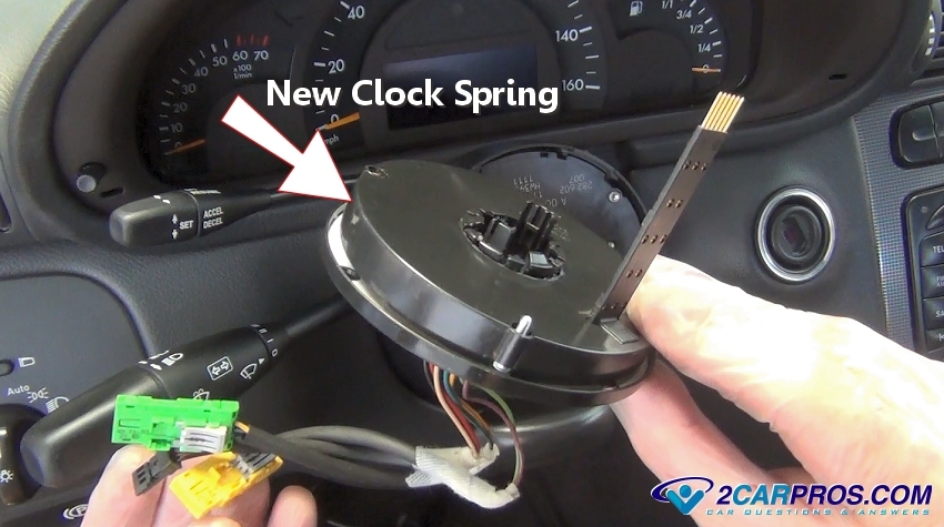

5. Install the New Air Bag Clock Spring: Here is the new steering wheel clock spring assembly that is ready to be installed.

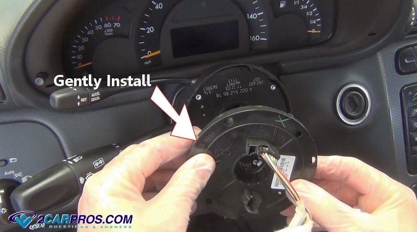

Being mindful of the electrical connectors or wiring harness gently lower the new unit into place.
install new steering wheel clock spring

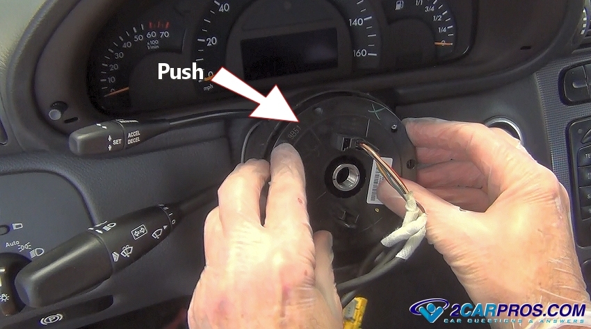

Continue by gently pushing the unit into its mounting plate and into the electrical connector below.
push steering wheel clock spring

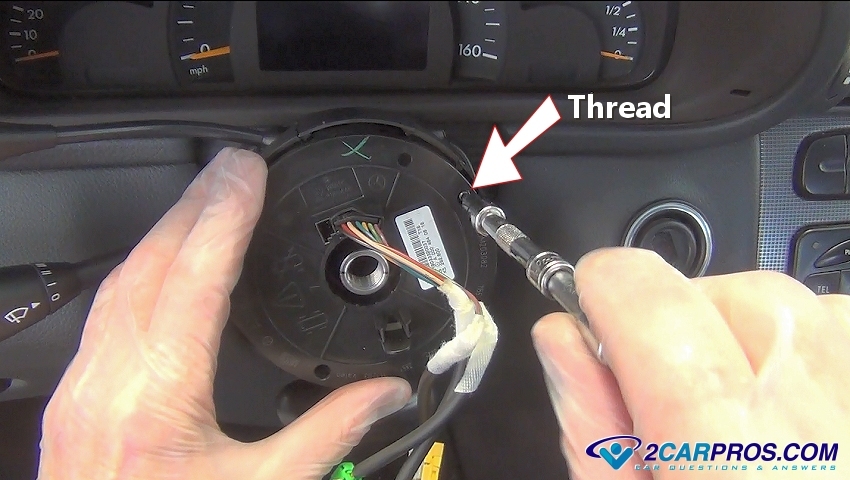

While inserting the mounting screws gently hand thread them to avoid cross threading. Install all of the screws before tightening them completely.
thread steering wheel clock spring screws

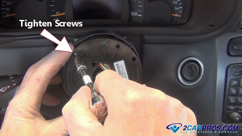

In a cross pattern evenly tighten the mounting screws but do not over tighten because they are in plastic and can strip out.
tighten steering wheel clock spring mounting screws
Complete the job by putting the alignment markers in place and then the steering wheel is ready to be re-installed and you are all set. Reconnect the batteries negative cable and you may need to clear the airbag trouble codes once the job is completed.
