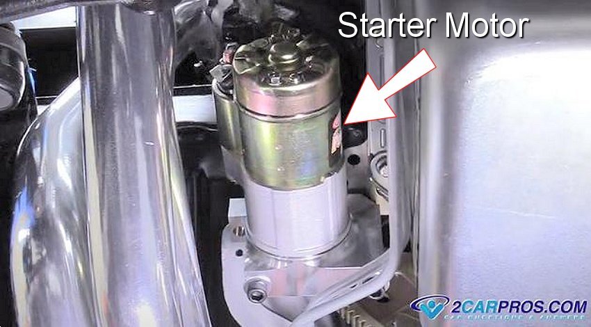

The starter motor is used to rotate the engine over so it can begin the combustion process. The starter motor will fail to operate if:
  • Starter trigger wire is not getting a signal.
  • Starter solenoid has gone bad
  • Starter motor armature has shorted out
  • Worn out starter motor brushes
  • Motor housing magnets have broken apart

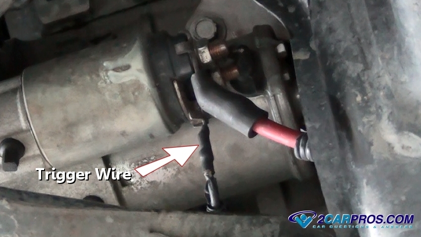

1. The first thing you want to do is use a test light to see if the starter solenoid is getting 12 volts (power) when the ignition key or system is in crank mode. To do this the starter motor needs to be located, next locate the solenoid which acts as the switch for the motor section of the starter which is mounted to the motor casing in most cases, (Some Ford products will have the solenoid mounted near the battery). Use a test light or voltmeter and test the trigger wire, the test light should light up or have 12 volts, if not you have an issue with the electrical system which is not a starter motor problem.
starter trigger wire

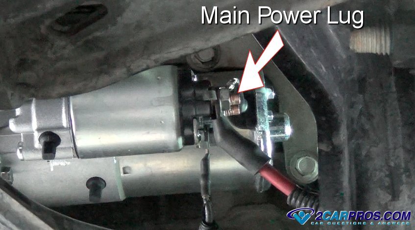

2. If there is power to the trigger wire use the testing light or voltmeter to test the large terminal on the starter motor. This should have power at all times and can be load tested when you command the starter to engage with the ignition key or button, (crank mode). If you have power at the large power cable and then it stops when the key or button is used the problem could be:
  • Bad connection at the battery
  • Shorted battery cable (positive or negative)
  • Bad battery
  • Bad starter control relay
