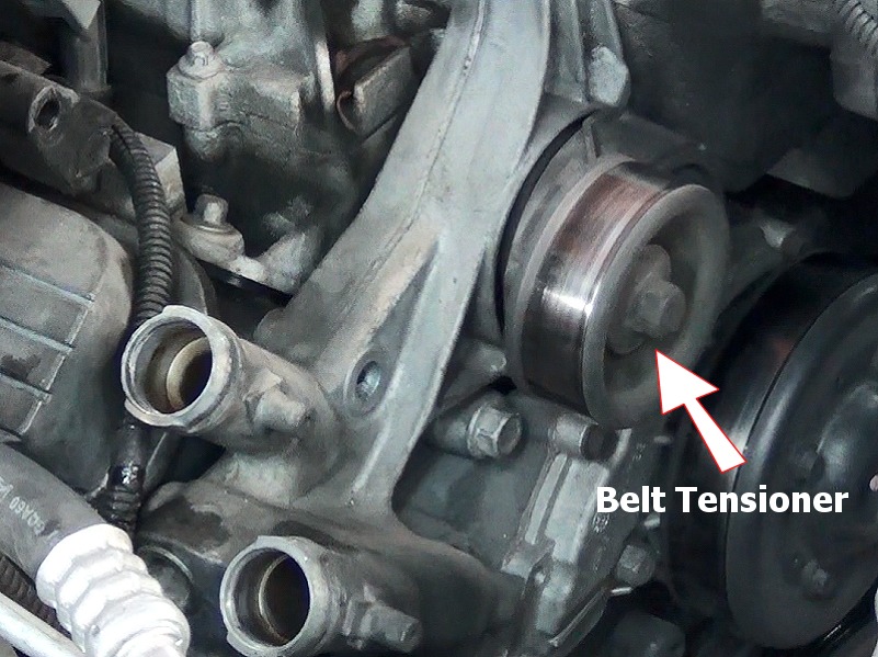

Step 1 - You may need to disconnect the battery before you start the job if electrical wiring is involved, and in some cases you will need to drain the cooling system as in the example below. Also, the serpentine belt, heater hoses and alternator have already been removed. Most cars will not have heater hoses running through the tensioner.
serpentine belt tensioner replacement

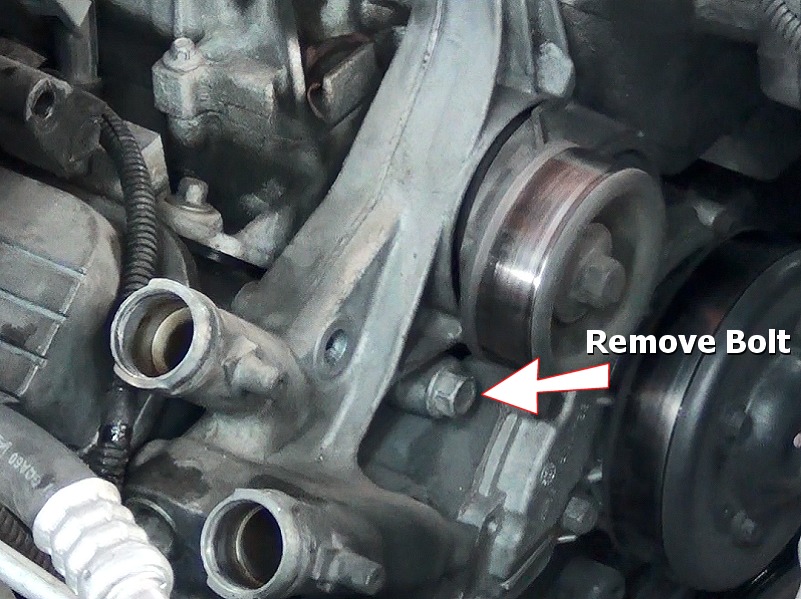

Step 2 - Locate and remove the belt tensioner mounting bolts, in this case there are two bolts which are 13mm and 15mm, most tensioners will have one to three mounting bolts.

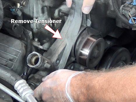

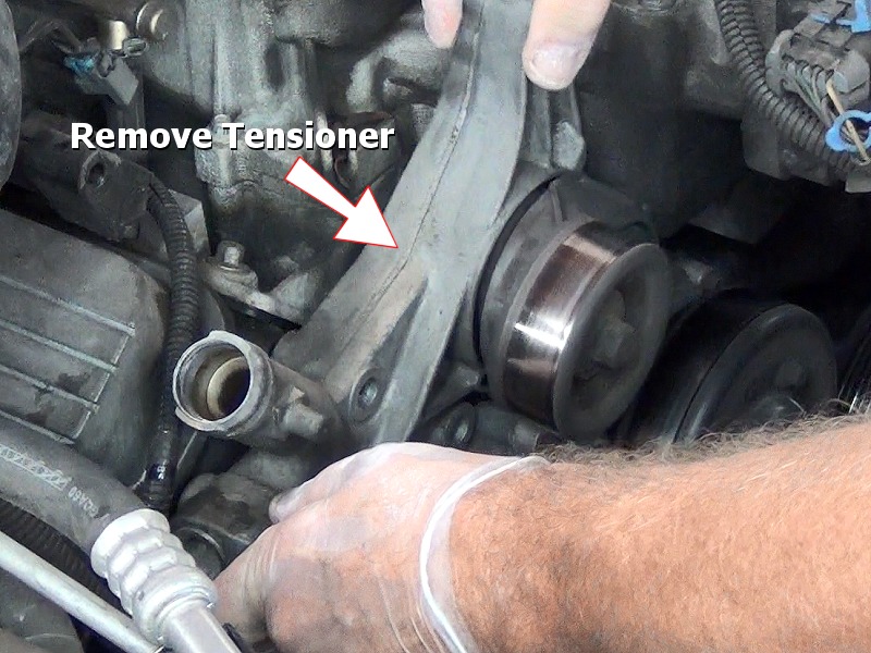

Step 3 - Here, our mechanic is removing the tensioner so it can be matched up to the new unit.

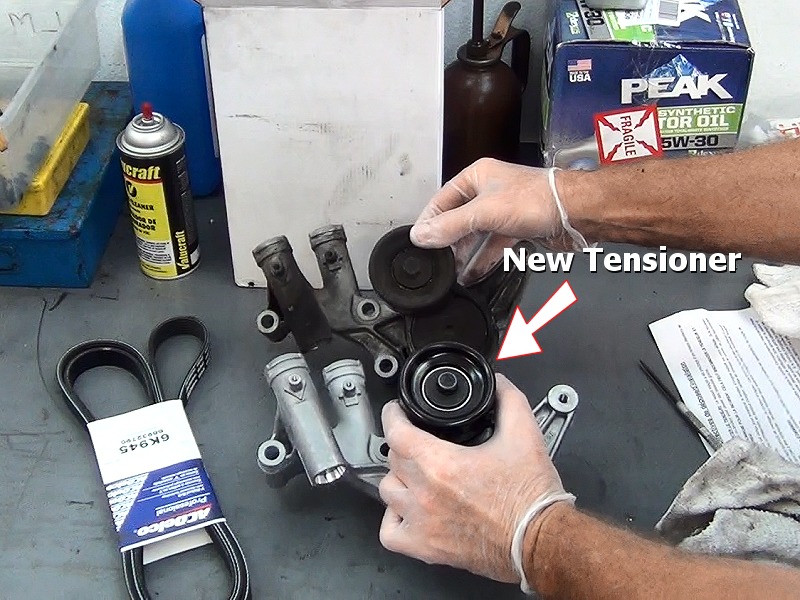

Step 4 - The old unit and new tensioner need to match identically to ensure a proper installation. You can also see we are installing a new serpentine belt which is highly recommended when doing the job.

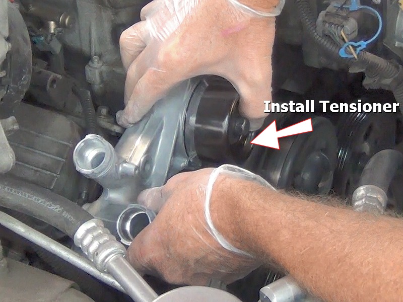

Step 5 - Lower the new part down into the engine bay and onto the engine, line up the mounting bolt holes.

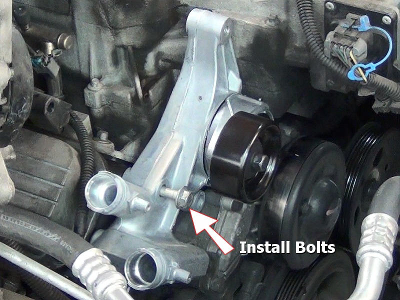

Step 6 - Reinstall the belt tension mounting bolts and tighten to specification which in this case was 23 foot pounds of torque, then continue with the reassemble and you are all set.
