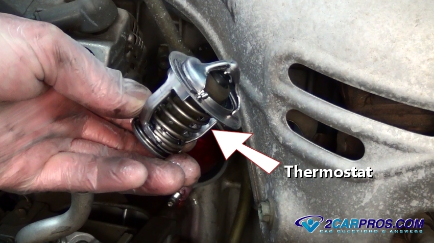

Step 1 - If the engine thermostat has stuck open, the engine operating temperature stays too low, causing the computer to stay in open loop. The computer is now constantly waiting for the engine to heat up for closed loop computing. Learn more

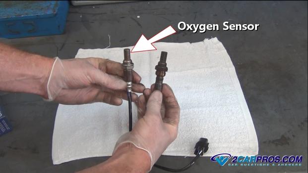

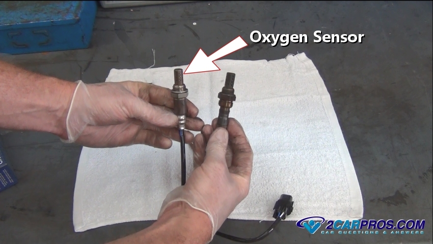

Step 2 - The powertrain computer relies on feedback information via the oxygen, mass air flow, throttle position, crankshaft position, coolant sensors etc. to operate, if one of these sensors becomes severely shorted it can cause the computer to stay in open loop, causing the code gathering to be incomplete. Learn more
