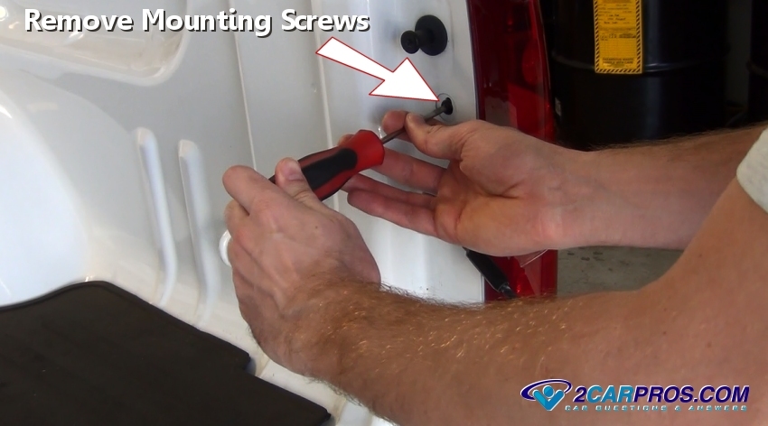

Start by locating the reverse light bulb that has failed and remove the lens mounting screws.
remove reverse bulb lens

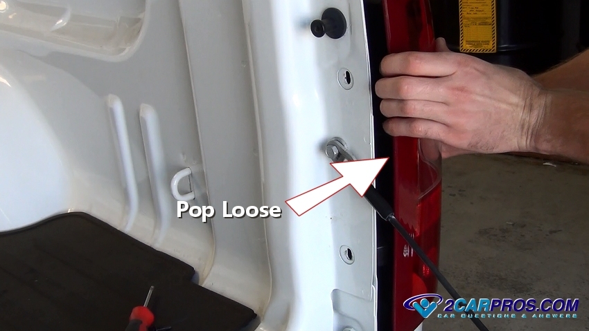

After the screws have been removed, grasp the lens and pop it from the mount, this procedure will vary per manufacturer, please ask one of our experts for help, its free.
pop reverse light lens

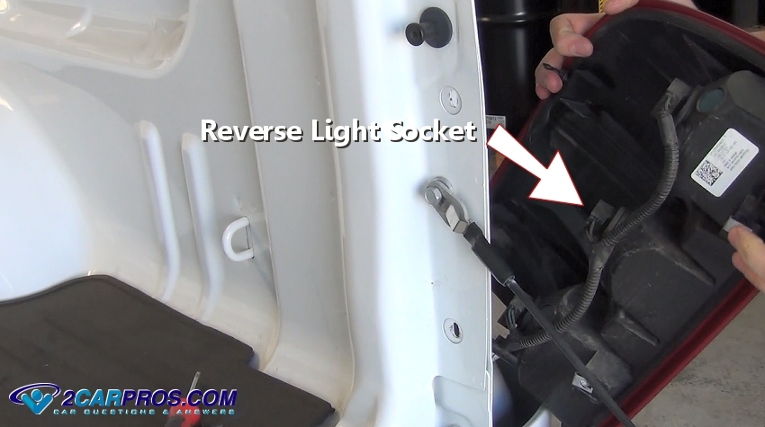

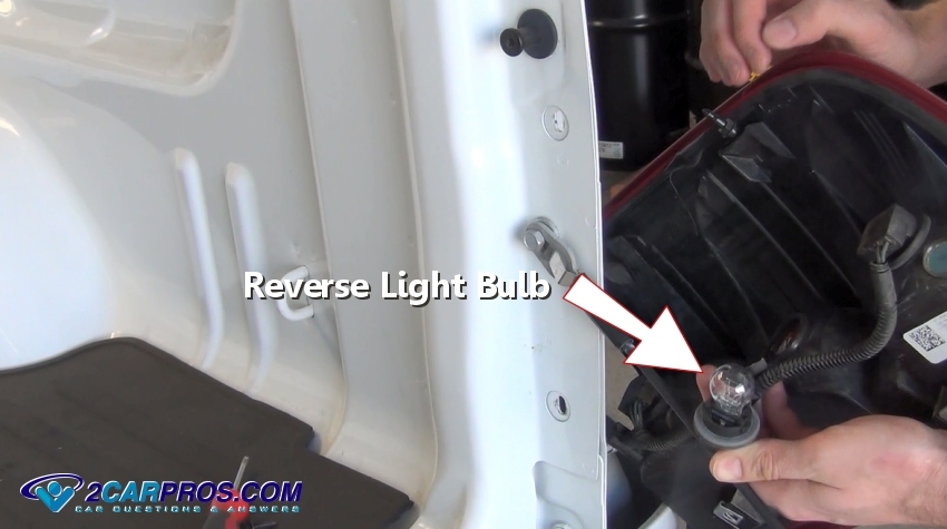

Once the lens is loose, locate the reverse light bulb socket.
reverse light socket
Grasp the socket and gently twist it counterclockwise to remove.
reverse light bulb

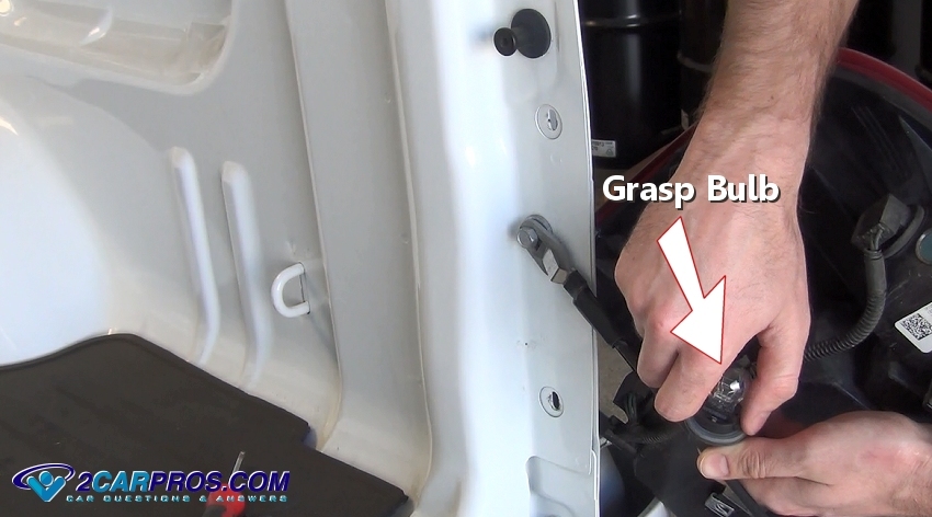

Gently grasp the bulb and firmly pull upward while holding the socket downward, some designs require a counterclockwise twisting motion while pushing slightly downward and then lift upward to remove the bulb.
grasp reverse light bulb

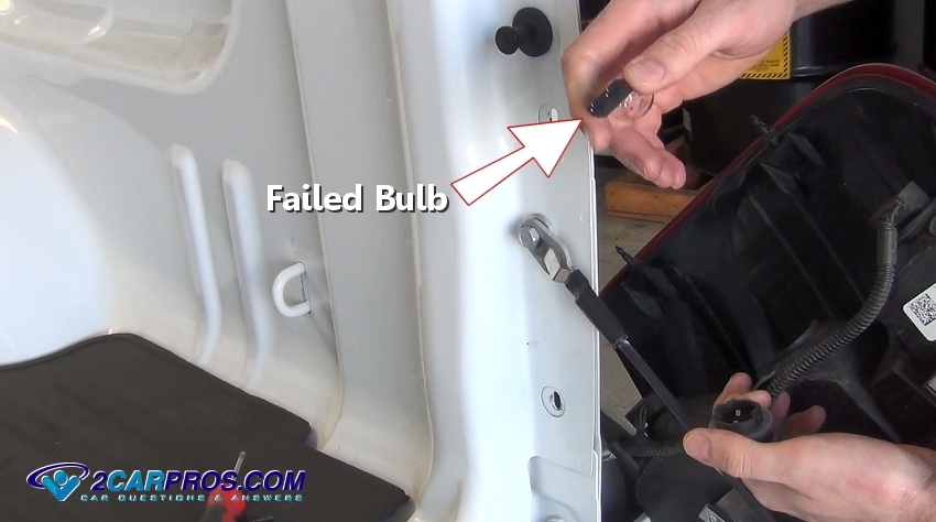

The bulb will pull out of the socket and be ready for replacement.
bad reverse light bulb

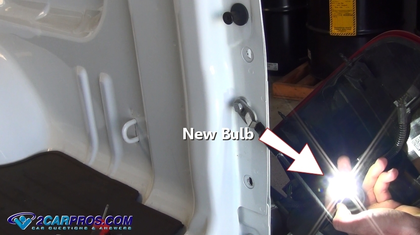

Match the new bulb to the old unit, they should match identically, reinstall the new bulb, turn the ignition switch on with out starting the engine, put the transmission in reverse to test the repair.
new reverse light bulb

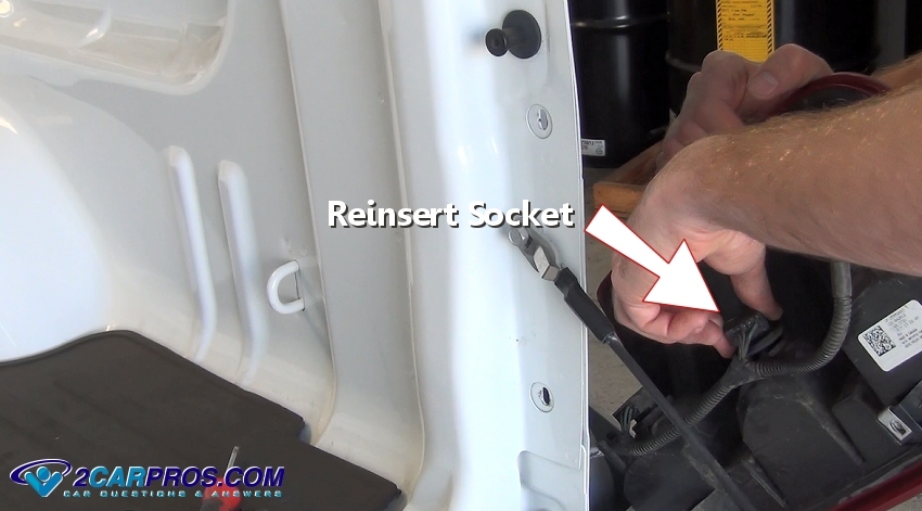

After checking the bulb operation, position the socket back into the lens and twist clockwise to tighten.
reinsert reverse light bulb socket

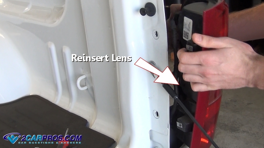

Next, reposition the lens and insert it back into its holder.
reinsert reverse light lens

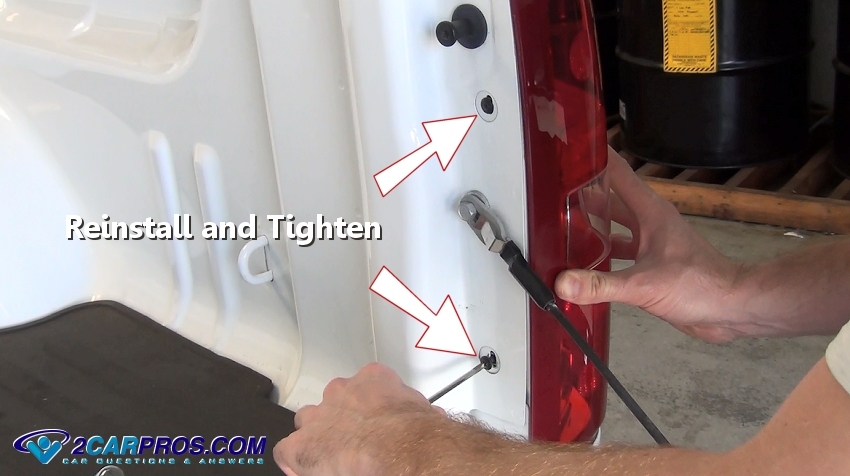

After the lens is in place, install the mounting screws and tighten.
reinstall reverse light bulb lens screws
