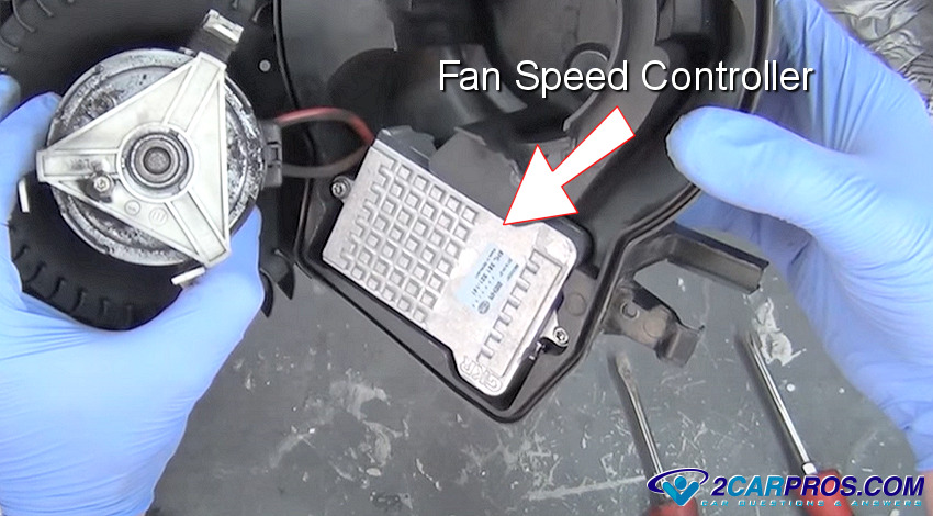

1. If you have located the blower motor then you have found the speed control-resistor because the these parts will always be close to, or included in the blower motor housing or location. The blower motor will be under the hood or dash on the passengers side, use a flashlight to help you locate the controller if visibility is low. You may need to remove the lower dash trim to access the location. In this example the fan motor speed controller is intergraded into the blower fan motor itself which may be serviced as a unit.
hvac blower fan motor speed controller

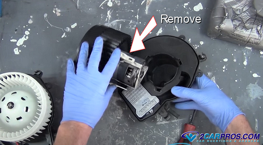

2. In this case the blower motor itself needs to be removed from the HVAC housing before the speed controller can be accessed.
remove hvac blower fan motor from housing

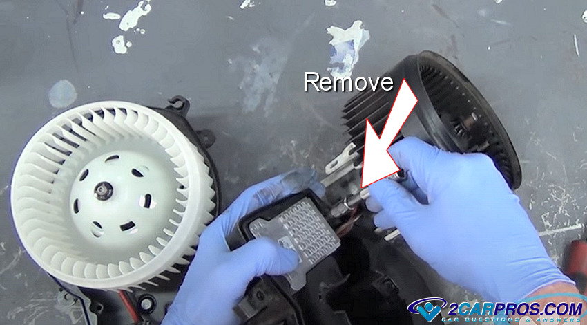

3. Remove the mounting screws and set them to the side for easy access when reassembling.
remove mouting screws from blower fan motor speed controller

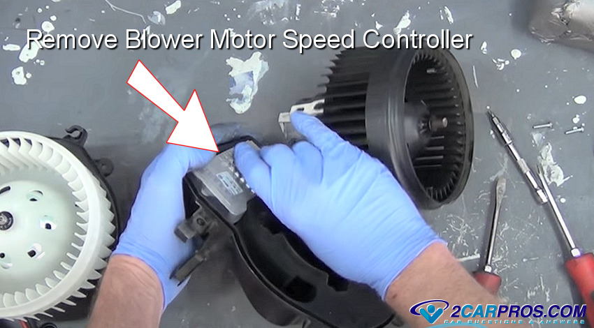

4. Grasp the speed controller firmly and lift it from the blower motor housing while being mind full of the electrical wiring on the backside.
remove hvac blower fan motor speed controller

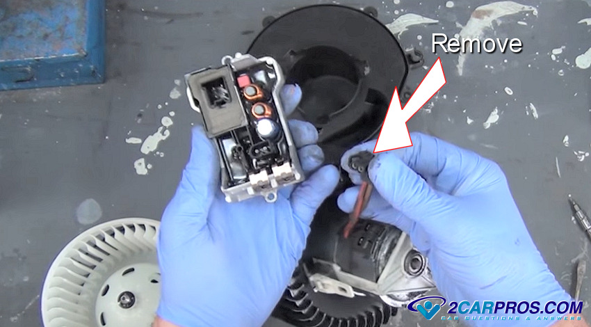

5. Once the fan speed controller is loose from the housing turn it over and remove the electrical connector by gently releasing the connector safety clips and wiggling the connector from the main body of the unit.
remove hvac blower fan motor speed controller wiring

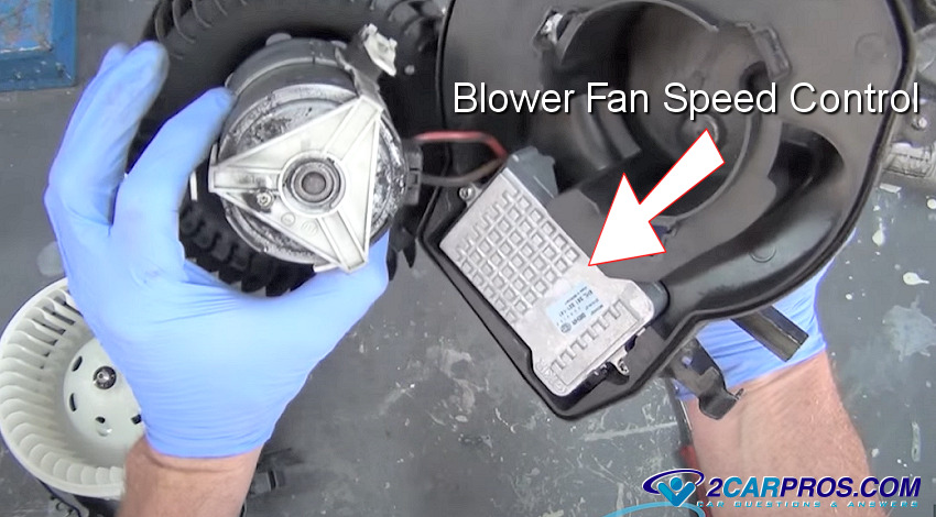

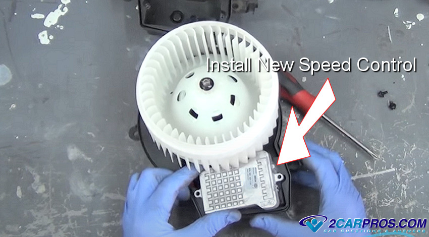

6. Once the old part has been removed match it to the new blower fan motor speed controller, they should match identically, reinsert the wiring connector and mounting hardware. Once completed turn the HVAC system on and cycle the fan speed switch to confirm the repair has been done correctly.
Pro Tip: Use dielectric grease inside the electoral connectors before installation to help prevent bad connections.
install new hvac blower fan motor speed controller
