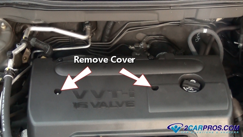

Some engines have a decorative plastic cover over the engine that must be removed, start by removing the mounting nuts or bolts then remove the engine cover to gain access to the valve cover.
remove cover

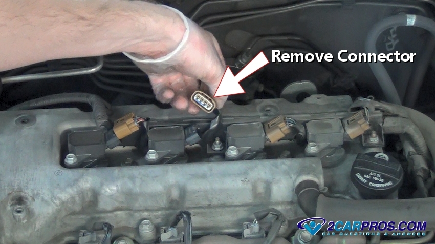

A valve cover may or may not have ignition coils mounted to it, in this case it does, start by disconnecting the electrical connector from the ignition coils.
remove coil connector

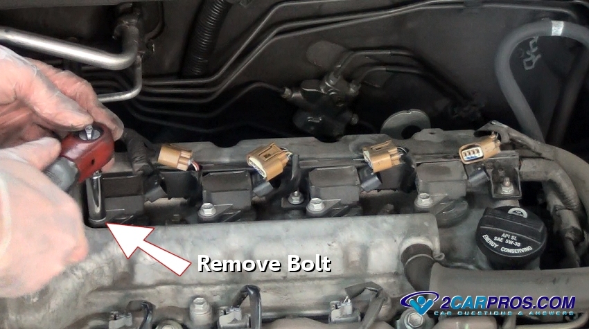

Remove the mounting bolts from the ignitions coils (4), in this case they are 10mm.
remove coil bolt

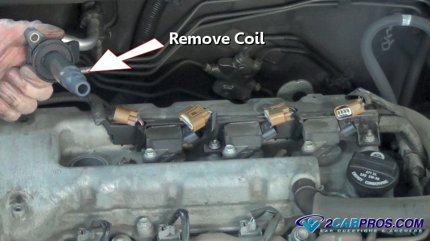

Lift and remove the ignition coils and inspect for oil or burn marks. If oil is present it means the valve cover gasket is leaking into the spark plug well.
remove coil

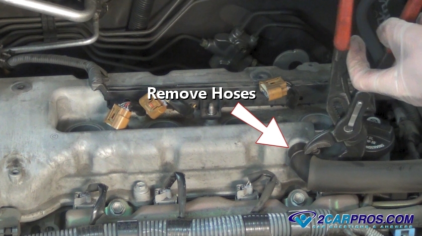

Look around the valve cover and  remove any breather hoses or plastic clips that are attached by releasing the clamps using pliers.
remove hose valve cover

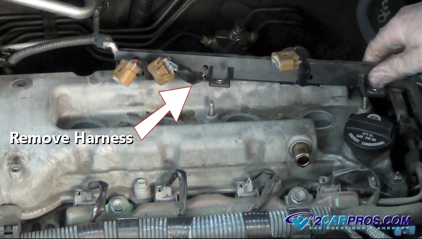

Clean the valve cover before removal to avoid dirt contamination then remove the wiring harness mounting bolts (10mm), remove the harness from the valve cover.
remove wiring valve cover

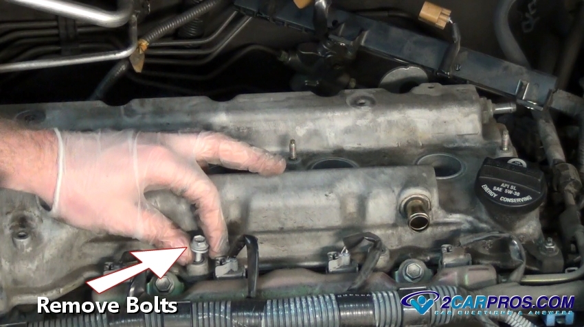

Locate and remove all valve cover mounting bolts (10mm), these will be located around the outside lip of the cover.
remove valve cover bolts

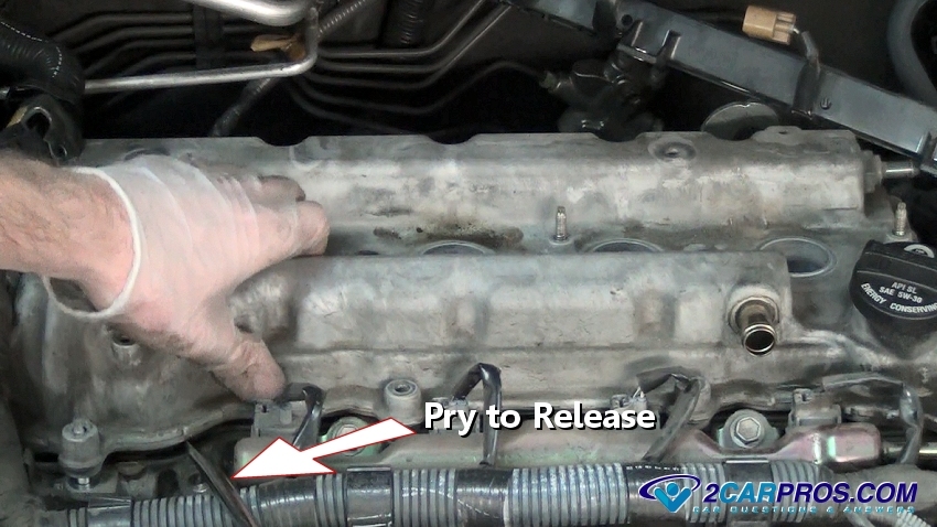

Double check to make sure all of the valve cover mounting bolts have been removed, use a screwdriver or small pry bar and wedge in-between the cover and cylinder head to pop the cover loose.
pry release valve cover

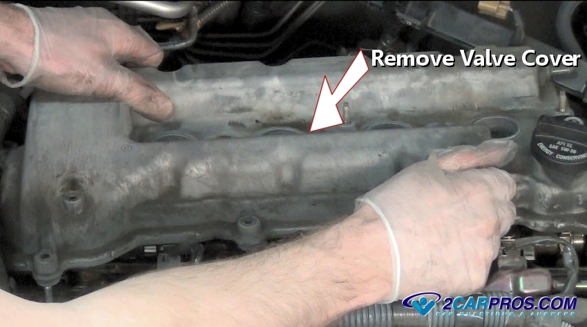

Firmly grasp the valve cover and lift it from the engine bay, a small amount of oil will be present, avoid gasket material and dirt from getting into the engine.
remove valve cover

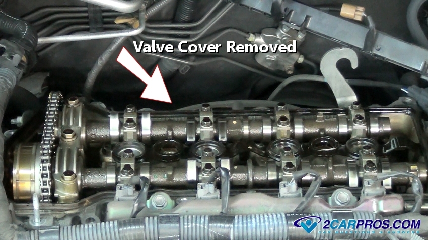

Once the valve cover has been removed, the valve train will be exposed, be sure to keep dirt and debris from this area, check the area for excessive sludge build up and clean if needed.
valve cover removed

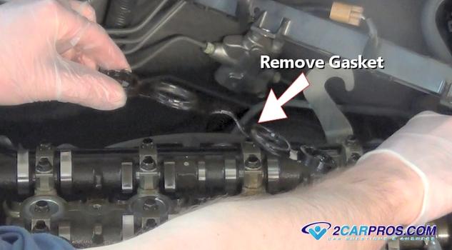

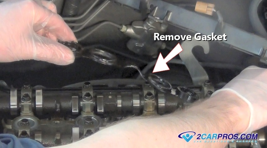

The cover gasket will either be stuck on the cylinder head, or the valve cover itself, remove the old gasket.
remove valve cover gasket

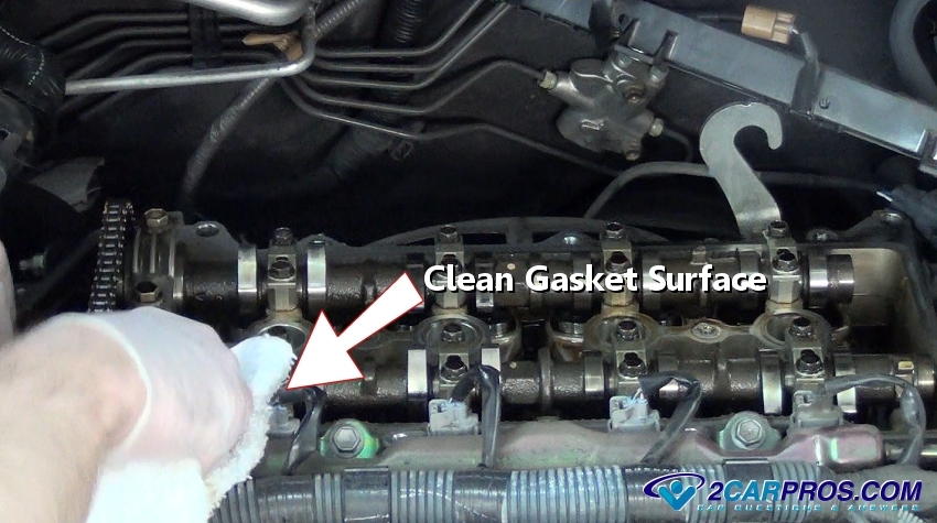

Use a shop towel and carburetor cleaner to wipe the gasket surface clean, this will ensure a proper reseal of the new gasket, a gasket scraper may be needed.
clean gasket surface

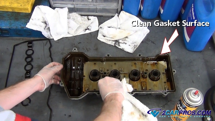

Again, use carburetor cleaner and a shop towel to clean the gasket surface of the valve cover.

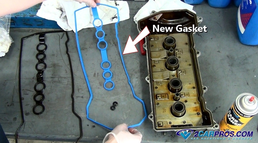

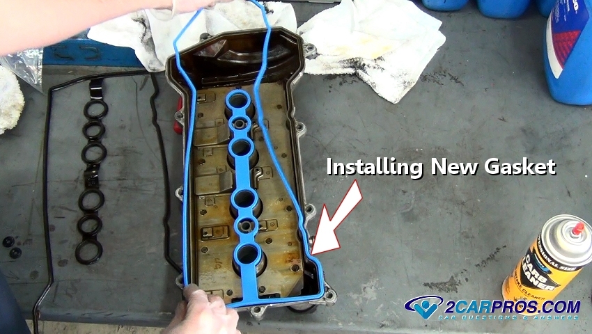

Remove the new valve cover gasket from its packaging, match the old gasket to the new unit to ensure a proper installation.
Gently install the new gasket avoiding bends or folds to preserve its integrity, push into place, some applications require spray contact cement to hold the gasket while installing which keeps the gasket from coming loose from the cover.
installing new valve cover gasket

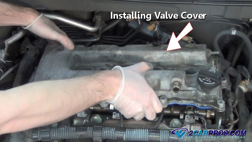

Gently lower the valve cover into place while ensuring nothing is caught under the gasket during installation.
installing valve cover

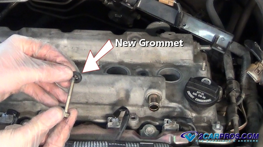

Some valve cover bolts may require a new grommet or gasket which should be included in the new gasket kit.
new grommet valve cover

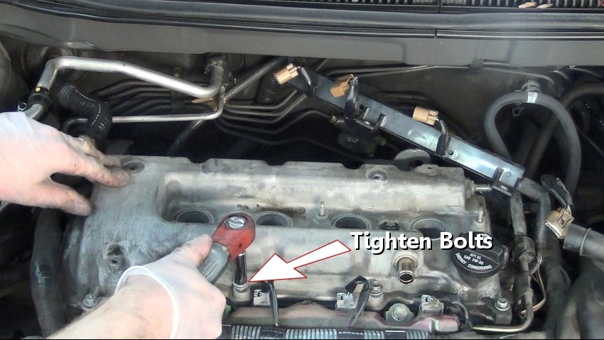

Install all valve cover mounting bolts by hand, do not tighten until all bolts have been installed. Gently tighten the bolts down evenly, in small increments, using a star pattern, bolts should be snug but not super tight. Look up the torque setting if needed, in this case it is 5 foot pounds, do not over tighten valve cover, this can damage the gasket.
tighten valve cover bolts

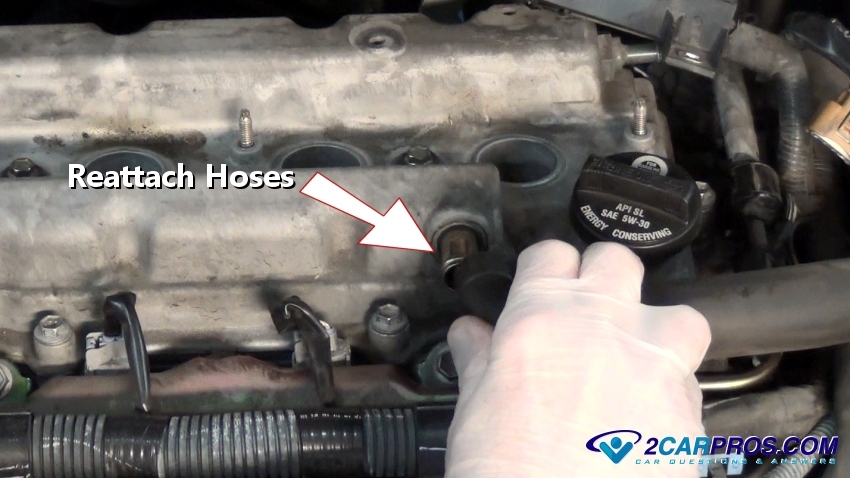

Reattach all hoses and plastic clips which were removed earlier.
reattach hoses

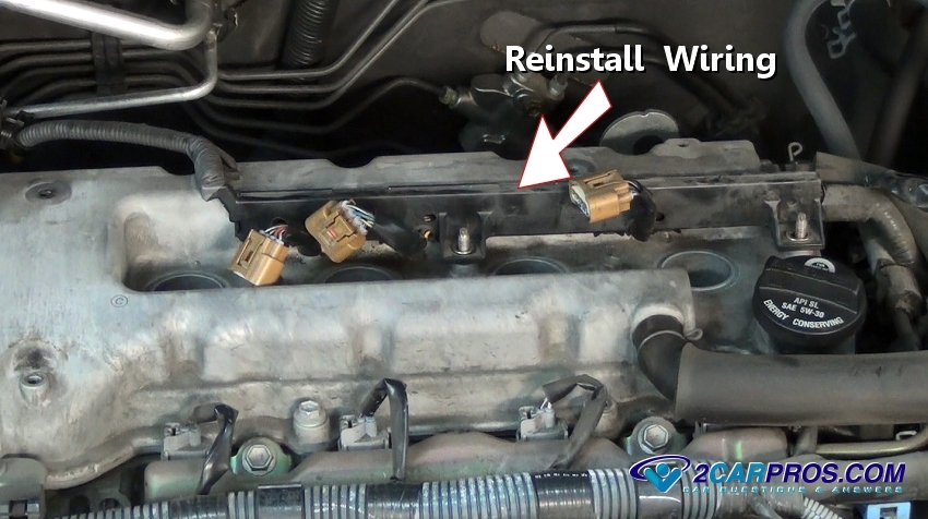

Reinstall ignition coil wiring harness mounting nuts and tighten.
reistall coil wiring connector

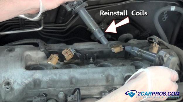

Reinstall ignition coils and mounting bolts, tighten and reattach wiring harness connectors. Position the plastic cover back into place and install the hold down nuts and tighten, recheck valve cover bolt tightness after a short time.
reistall ignition coils
