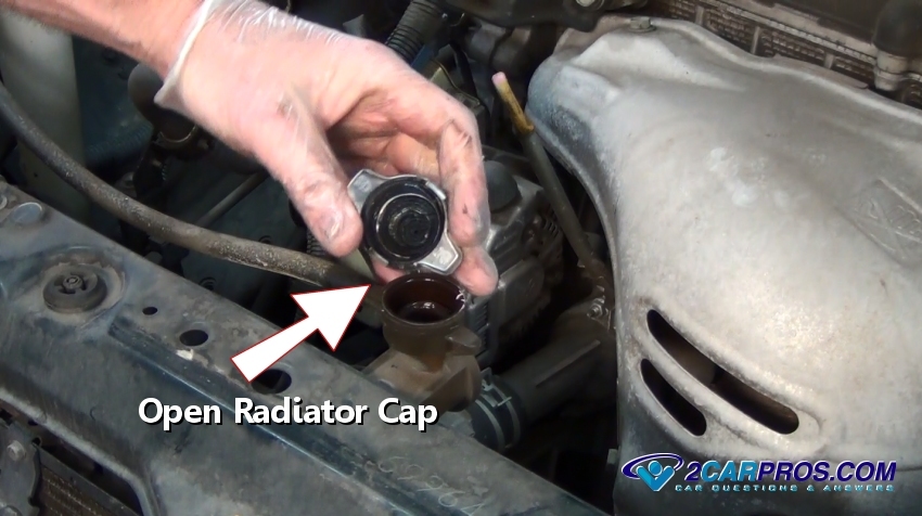

With the engine cold, slowly open the radiator cap to relieve pressure inside the radiator and cooling system.
open radiator cap

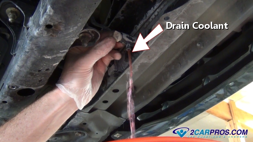

Remove the vehicle's under shielding to locate the radiator drain valve, loosen the valve to begin draining the coolant, close the valve once complete, if a drain plug is not found remove the lower radiator hose to drain the coolant.
drain coolant

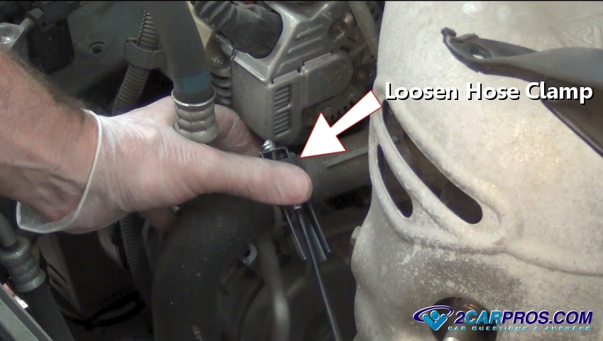

The thermostat is located in the lower radiator inlet of the engine, loosen the hose clamp which holds the radiator hose to the thermostat housing and remove the radiator hose.
loosen hose clamp

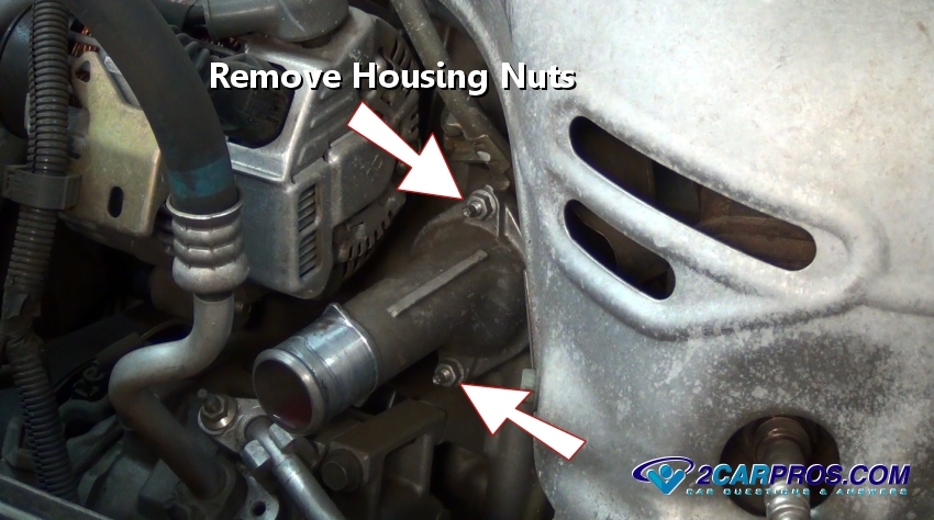

Use a wrench or a socket to remove the housing mounting nuts or bolts.
remove housing thermostat nuts

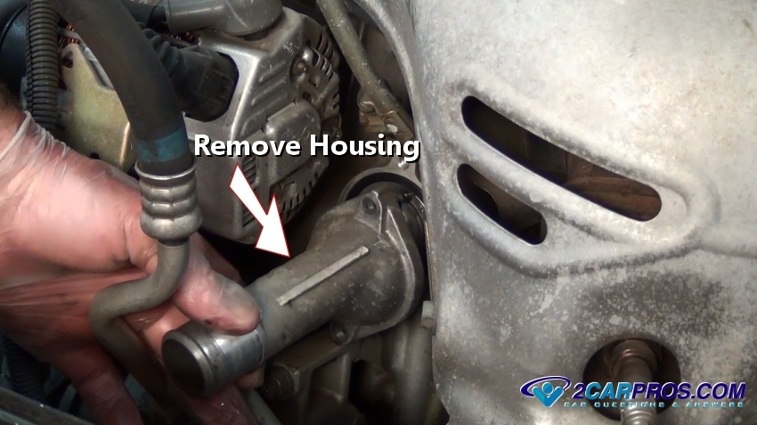

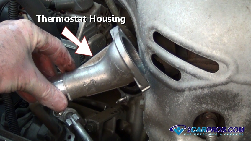

Gently tap on the housing using a small hammer to break the seal loose and remove the housing, the thermostat will now be exposed.
remove thermostat housing

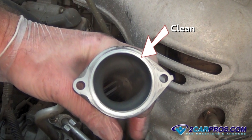

Once the housing has been removed, clean the gasket sealing surface and inspect for corrosion which will impede the new gaskets ability to seal correctly.
thermostat housing

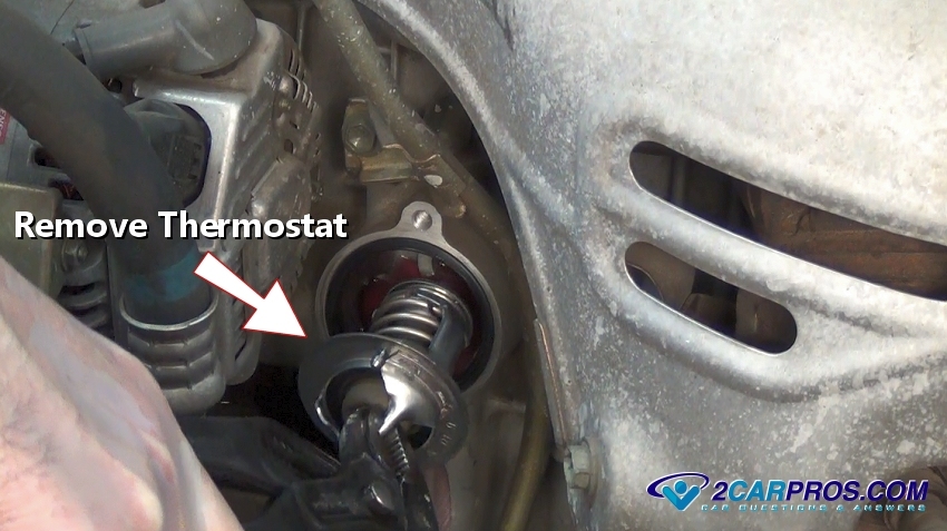

The thermostat might be stuck in the block or intake manifold so pliers may be needed to remove, note the direction of the thermostat, the spring always goes towards the engine.
remove thermostat

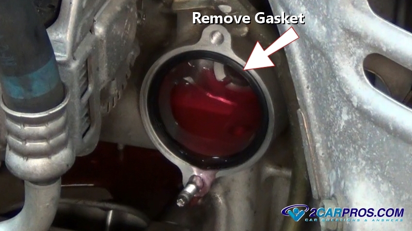

Here is what it looks like when the thermostat is removed and the sealing gasket or O ring exposed. Clean the area using a shop towel and remove all debris which will enable the new gasket to seal completely.
remove gasket

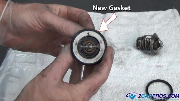

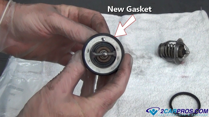

Match the new thermostat to the old unit, designs may vary so if there is a large difference recheck the application information.
new thermostat
On this application the sealing O ring is installed onto the thermostat itself, this design will vary, but the principle is the same.
installing new thermostat gasket

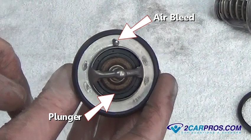

On some thermostats there is an air bleed valve on the face of the thermostat body. This allows air to escape from the block when refilling the cooling system and must be located at the top of the thermostat. The plunger is the part that opens to allow the coolant to flow.
air bleed thermostat

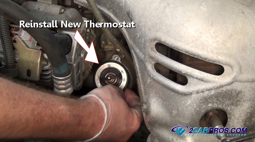

Once the sealing surfaces are clean, install the new thermostat with the bleed hole facing upwards and the spring toward the block or intake manifold, push the thermostat into place.
reinstall new thermostat
Before reinstalling the thermostat housing, clean the sealing surface using a gasket scraper or sand paper.

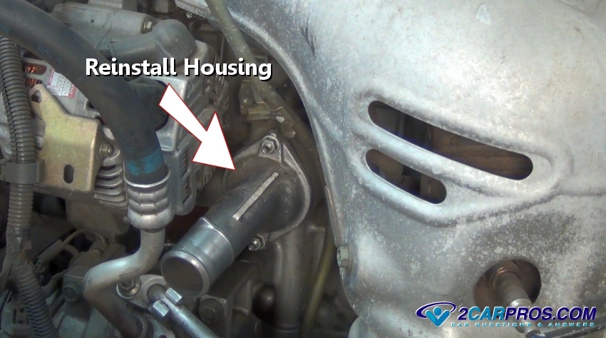

Reinstall the housing onto the block or intake manifold, install mounting bolts or nuts and tighten to spec, in this case it is 12 foot pounds of torque.
reinstall thermostat housing

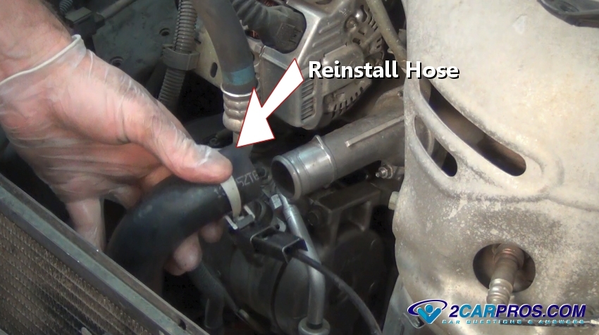

Reinstall the radiator hose and you are all set, refill the cooling system and start the engine, while the engine is warming up check for coolant leaks.
reinstall hose
