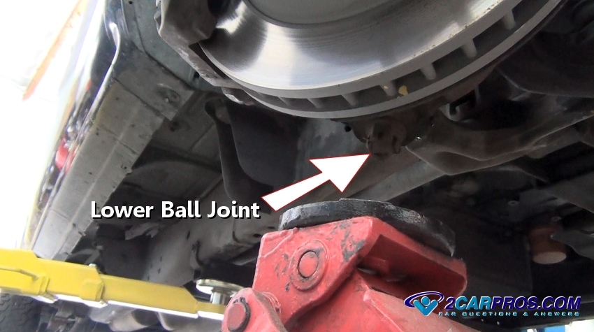

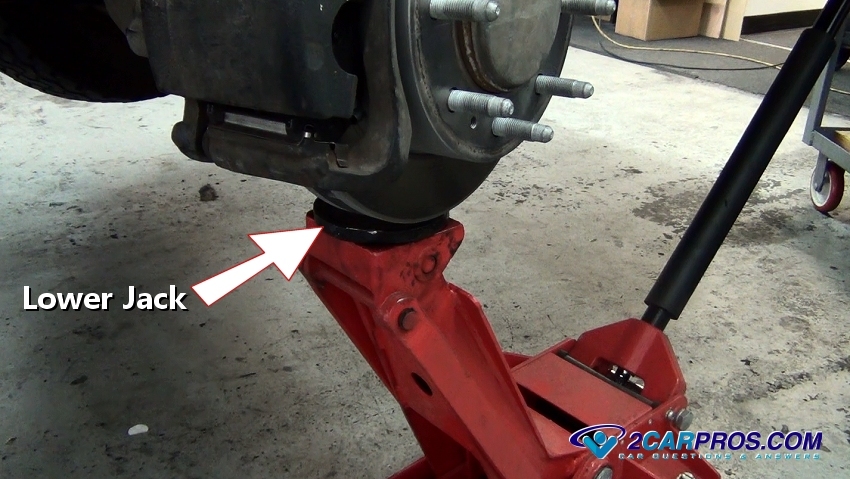

Step 1 - Before removing a shock absorber its important to know that a shock limits the downward travel of the suspension. Start by relieving the tension of the suspension by positioning a jack under the lower ball joint or control arm while raising the jack upward slightly. Not performing this step can make shock replacement difficult as the weight of the suspension can hold the mounting bolts from being removed.
lower ball joint

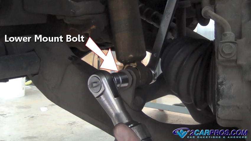

Step 2 - Once the suspension tension has been relieved, remove the lower shock mounting bolt.
remove lower shock mount bolt

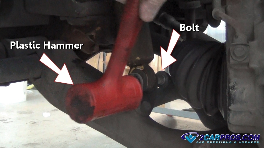

Step 3 - A plastic hammer or block of wood and a regular hammer can help push the bolt through if it can't be removed by hand.
remove lower shock mount bolt hammer

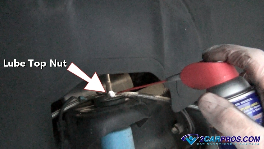

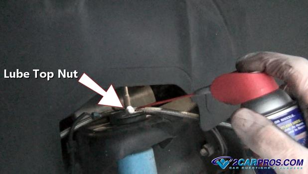

Step 4 - Use WD40 or equivalent to lubricate the shock top mounting nut.
lube shock nut

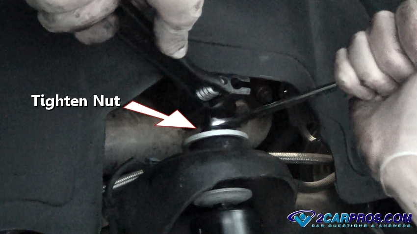

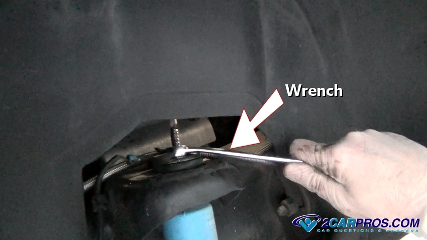

Step 5 - Slide a normal wrench over the top of the shock stud and place it securely onto the mounting nut.
wrench

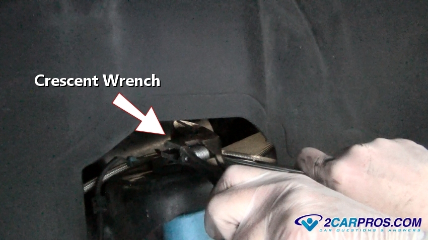

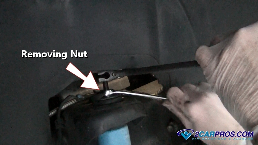

Step 6 - Adjust a crescent wrench to hold the top of the shock stud to prevent the shaft from turning while using the wrench.
crescent wrench

Step 7 - While holding the shock shaft with the crescent wrench, turn the nut counterclockwise to loosen.
removing upper shock nut

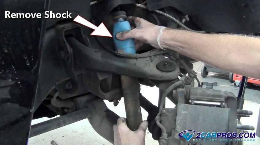

Step 8 - Once all mounting nuts and bolts have been removed, grasp the shock and remove it from the suspension.
remove shock

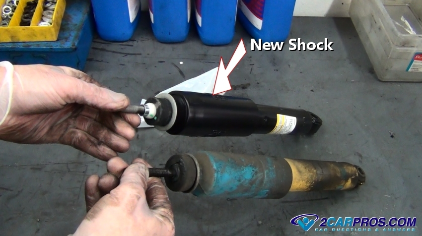

Step 9 - After the shock has been removed, match the old shock to the new unit to ensure a proper installation. Confirm the top insulator (bushing) is installed correctly.
new shock

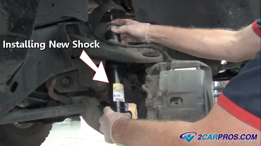

Step 10 - After the new shock has been matched to the old unit, gently install the new shock into the upper mounting bracket while confirming the upper isolator position.
installing new shock

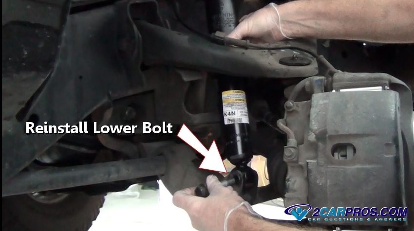

Step 11 - While holding the shock in place, install the lower mounting bolt into place.
reinstalling lower shock mounting bolt

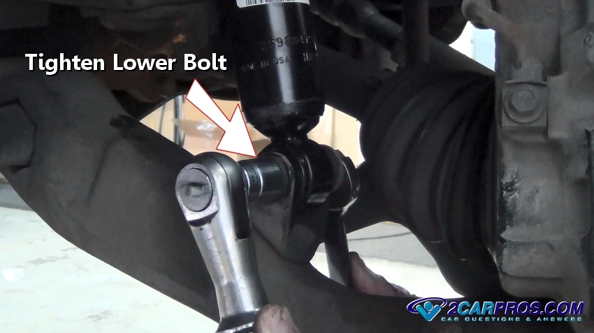

Step 12 - Once installed, use a wrench to hold the nut tight while turning the bolt clockwise until tight.
tighten lower shock bolt

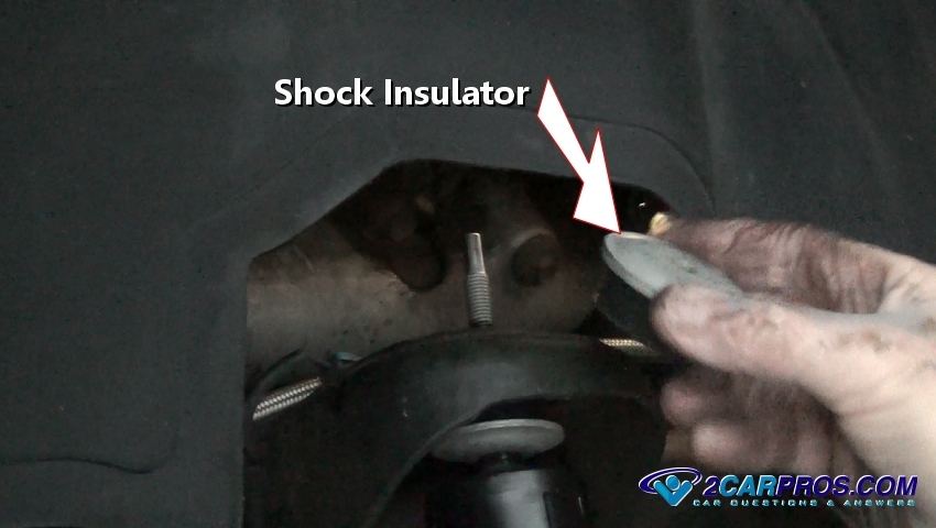

Step 13 - After the shock is positioned, install the upper part of the shock insulator set. This step is important for the shock to operate without abnormal noises, ie. popping, rattling and banging.
shock insulator

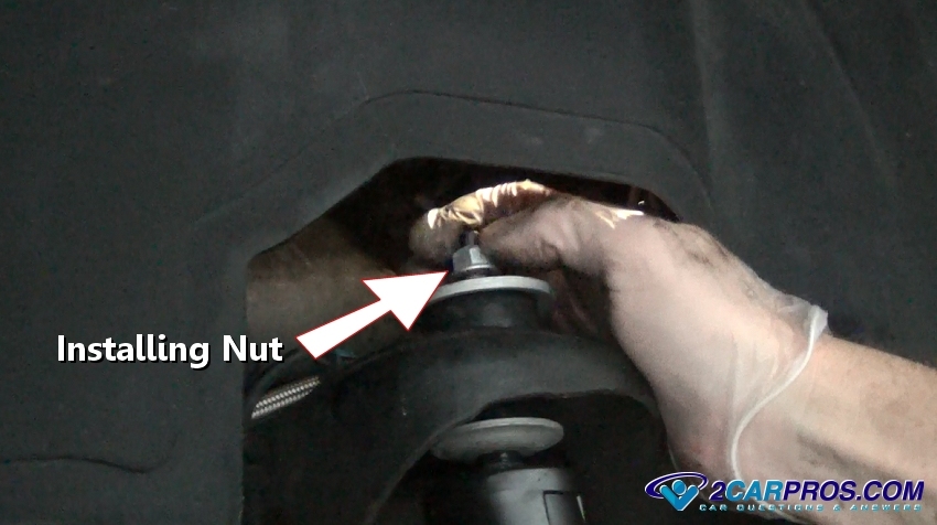

Step 14 - When installing the upper nut, avoid cross threading by winding the nut on by hand.
installing shock nut

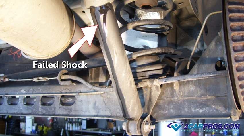

Step 17 - Anytime oil is leaking from a shock or strut it has failed and replacement is required.
failed shock
