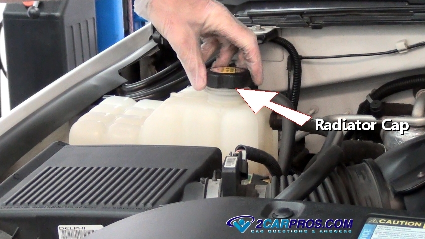

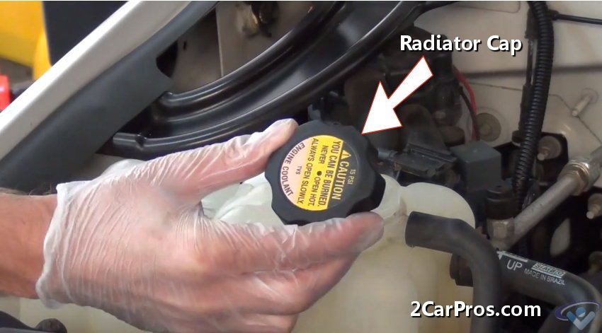

Open the radiator cap to release any residual pressure and to allow the coolant to flow freely when drained.
removing radiator cap

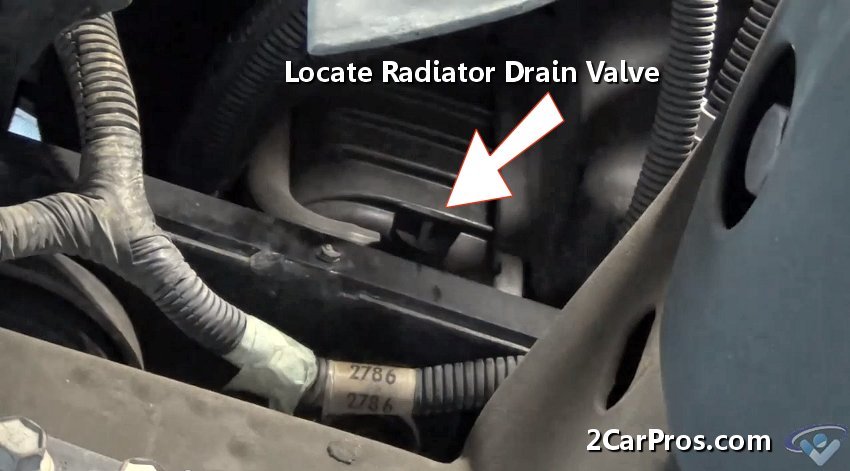

Locate the radiator drain plug which is where the system coolant will be drained from, some cooling systems do not have a drain valve, the lower radiator hose should be used to drain the system.
locate drain valve

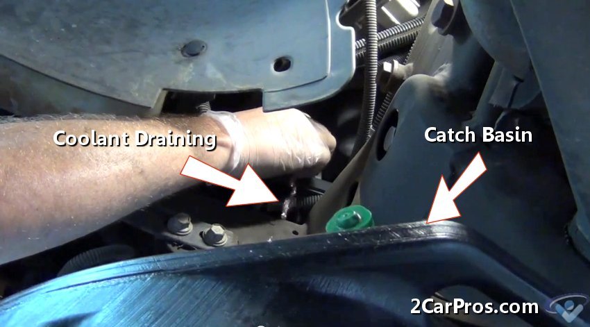

Loosen the drain plug allowing the coolant to flow into a catch basin, tighten the drain plug once the coolant has completely drained.
drain coolant

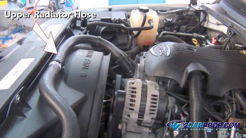

Identify the radiator hose that needs to be replaced.
upper radiator hose

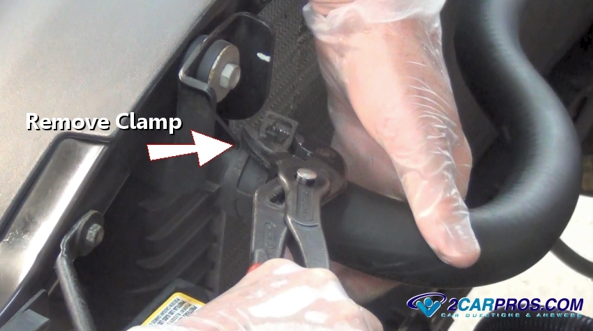

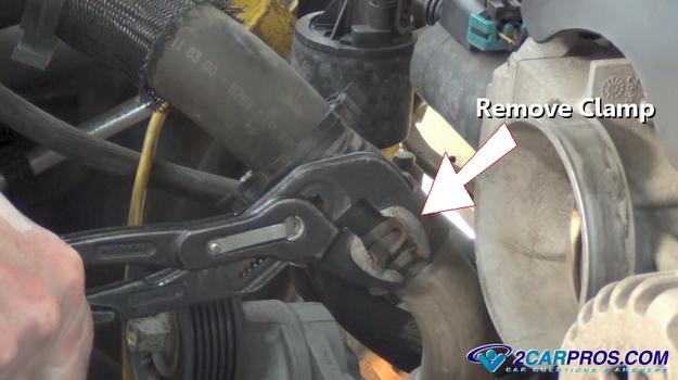

At each end of the hose clamps are used to secure the hose to the radiator and engine. Use pliers, channel locks or a hose clamp installation tool can be used to loosen the clamp, a twisting motion will help loosen the seal of the hose.
removing hose clamp

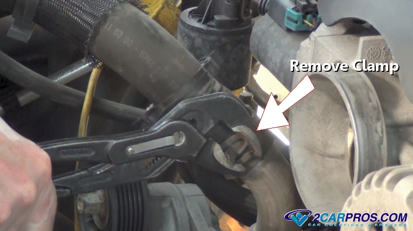

Remove the remaining hose clamps at the opposite end of the hose.
removing hose clamp

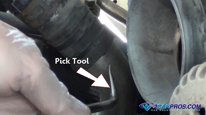

After the hose clamps have been removed from the clamping area, use a pick or screw driver to "break" the seal by forcing it between the hose and fitting.
hose removal tool

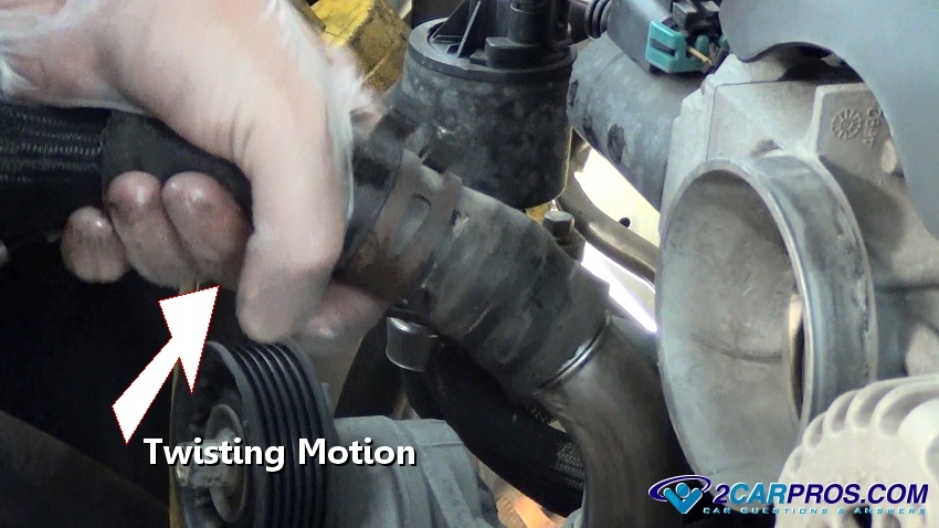

Grasp the hose and twist the hose which will fully release the hose seal.
twisting hose remove

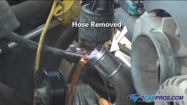

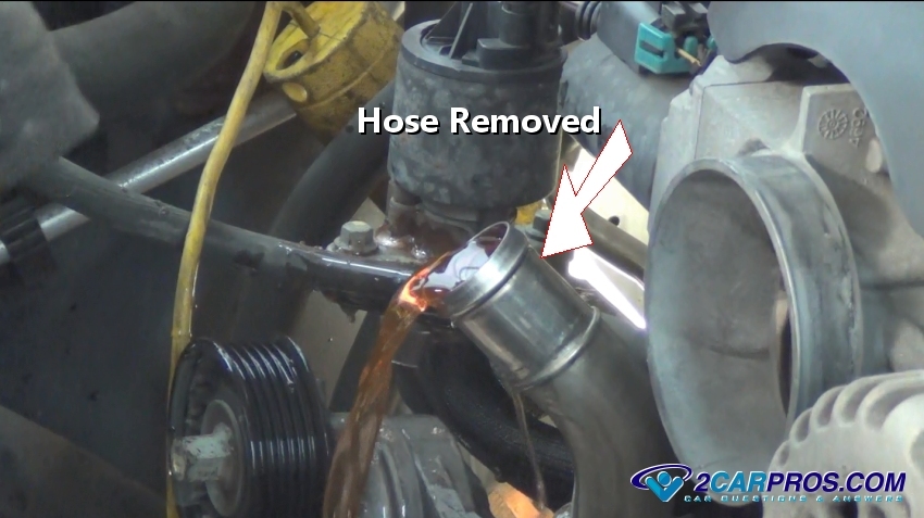

The hose will pull off the fitting, a small amount of coolant maybe present which is normal. A small amount of coolant can be trapped on top of the closed thermostat.
hose removed

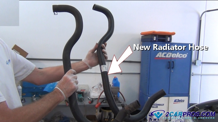

Match the new radiator hose to the old hose to ensure a proper installation.

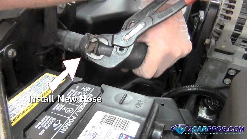

After transferring the hose clamps to the new hose and cleaning fitting ends, push the new hose onto the fitting while squeezing the clamp open, repeat this for action the opposing hose end. Replace any clamps that are broken or worn.

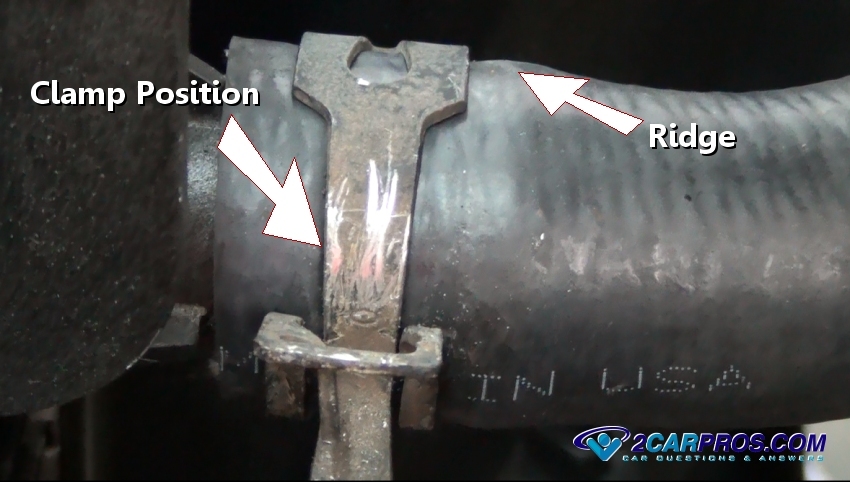

When installing the hose clamps position the clamp in front of the fitting ridge, this ridge is designed to help the hose and clamp stay secure under pressure. The alignment of the clamp should be "square" (not crooked) to hold pressure needed to successfully seal.
