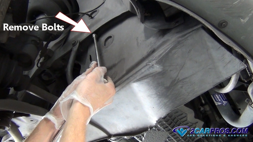

1. Remove Plastic Covers
To clear access to the engine mounts locate and remove the lower cover bolts and the plastic engine covers. Put the bolts in a container so they don't get lost during the job.
remove under cover bolts

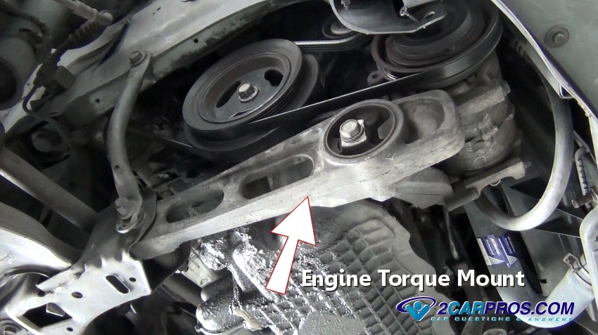

Using a flashlight identify the engine mount to be replaced. In the image below we show a torque style of engine mount which have a high failure rate due to excessive engine movement under load. You can see the right side bushing is worn allowing the engine to have excessive lateral movement.
engine torque mount

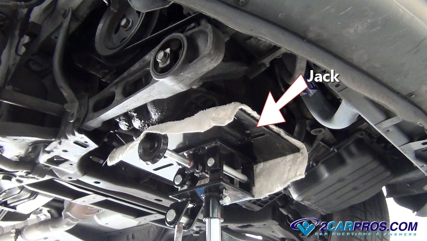

A jack maybe needed while removing the engine mount to help support the engine by taking the weight off of the mount.
jack supporting engine

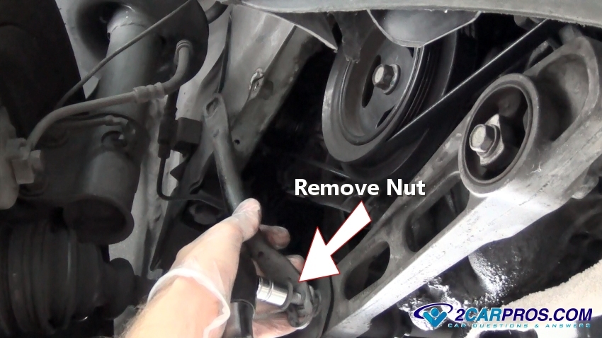

Remove the brace nut at the opposite end to remove the brace.
remove brace mounting nut

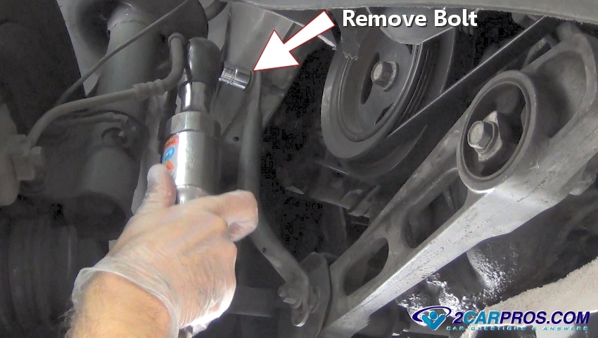

Once all obstructions have been cleared use a 15mmm or 16mm socket or wrench to remove the frame to mount bolt.
remove engine mount bolt

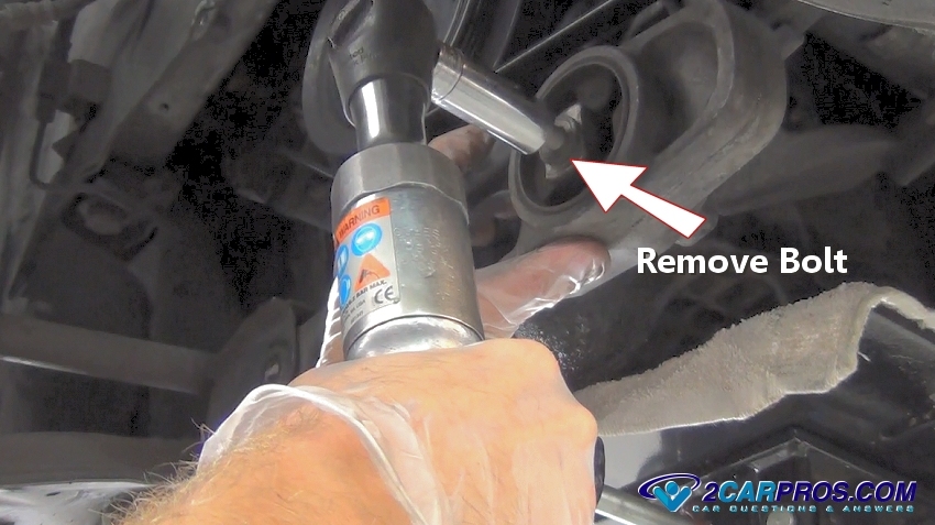

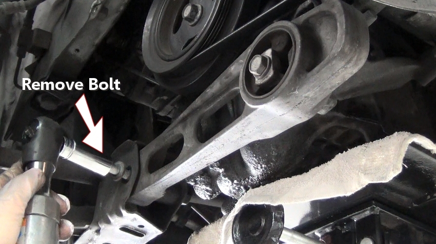

Finally remove the main mount bolt to the engine mount keep your hand on the mount as it will become loose.

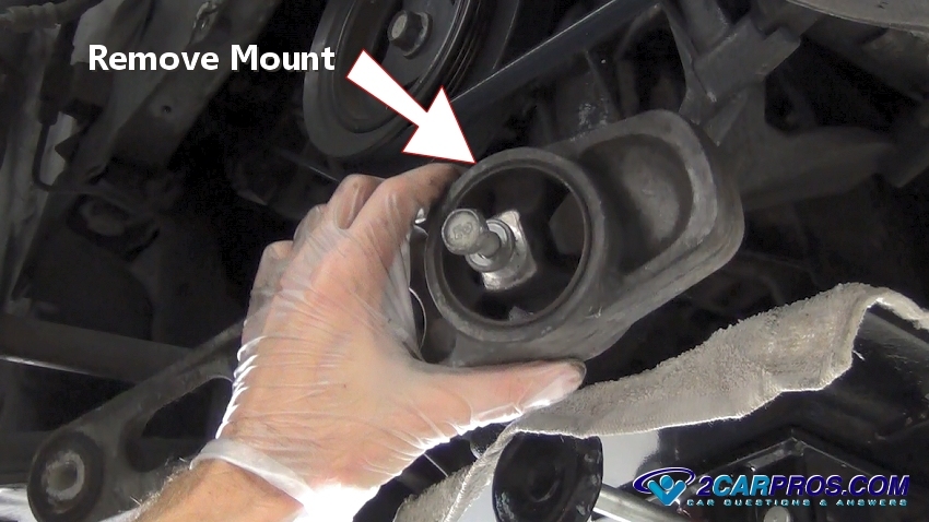

After all mounting bolts have been removed grasp the mount and pull it from the engine and frame brackets.
remove engine torque mount

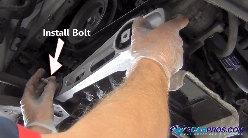

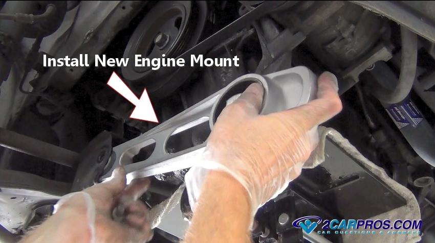

5. Install New Engine Mount
Grasp the new engine mount and insert it into the frame mount.
installing new engine torque mount

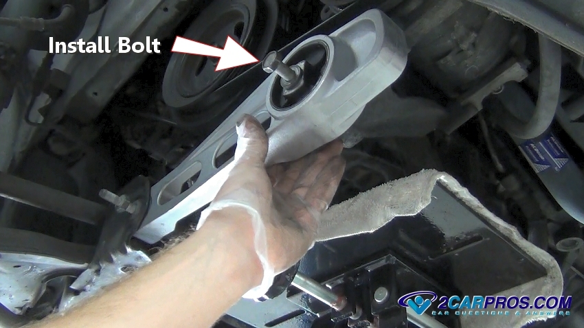

Insert the frame to mount bolt by hand which will hold the engine mount in place.
install enigne torque mount bolt
Hand thread the engine mounting bolt. The engine may need to be jostled slightly to align the threads.

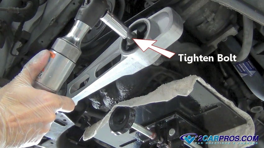

Using a ratchet or wrench tighten both the mounting bolt and nut to manufacturers recommended tightness which is usually between 45 and 55 foot pounds of torque.
tighten engine torque mount bolt

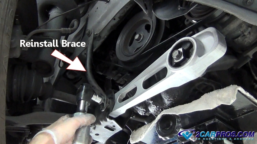

Reinstall any brackets or braces that were removed while replacing the mount.
reinstall engine brace mount

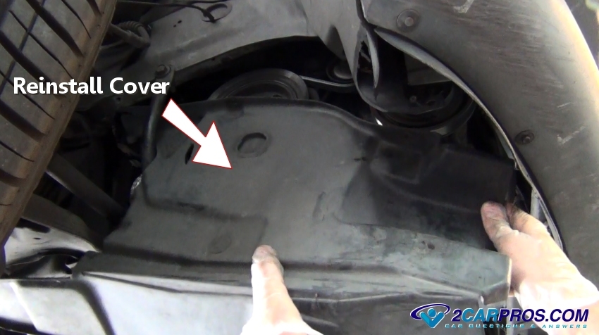

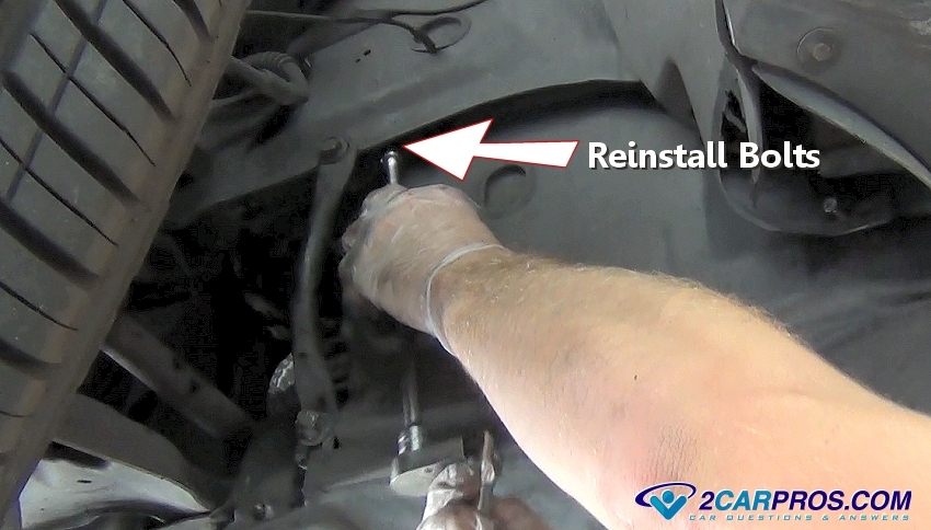

6. Reinstall Plastic Cover
Check to see that all the mounting bolts and nuts are tight and reposition the plastic cover.
reinstall plastic cover
Reinstall cover bolts and tighten. Then lower the car off of the jack stands and you rare all set. When starting and driving the vehicle listen for any strange noises which could be a sign of a problem and will need to be checked out.
reinstall plastic cover bolts
