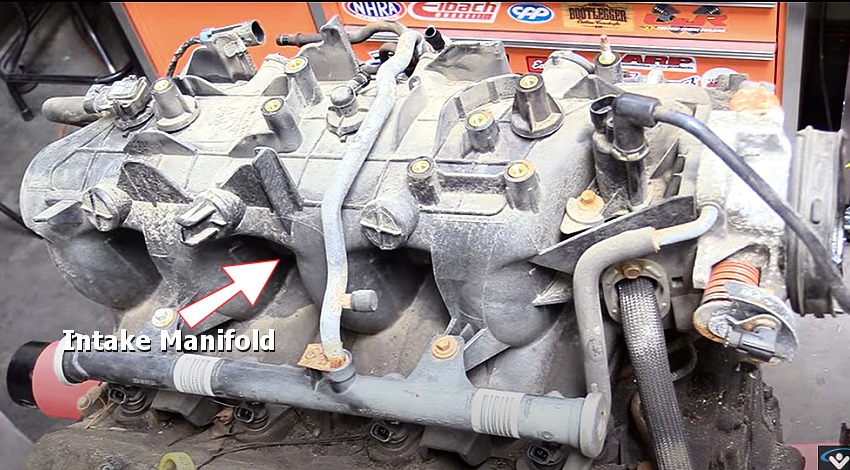

Disassembly: Here you see the engine has been prepared for the intake and gasket removal, beginning with the coolant drained and the battery disconnected. Also, all peripheral items have been removed such as engine cover, fuel  lines, wiring connectors, vacuum lines, throttle cable, air intake and EGR tubes. It is best to use your phone to take pictures to help when you are reassembling the intake.
intake manifold

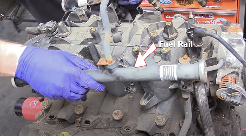

Remove the fuel rail mounting bolts then pull up to remove the fuel rail and fuel injectors, the injectors are sealed with O rings so they can be a little stuck, gently wiggle the injectors out of the intake manifold.
remove fuel rail

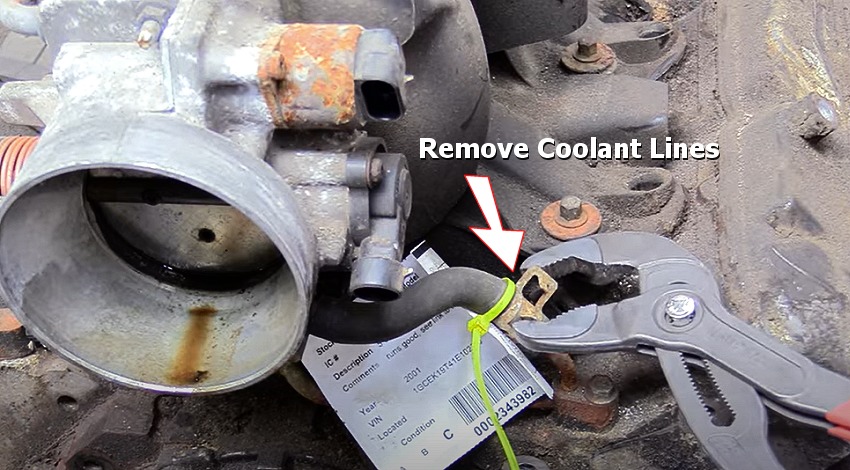

Inspect the intake and remove any remaining hoses or tubes. Older engines will have the distributor mounted onto the intake, make sure to note or mark the position of the rotor under the distributor cap before removing it. It must go back in the same exact position for the engine to run properly, a cell phone image works great for this.
remove coolant lines

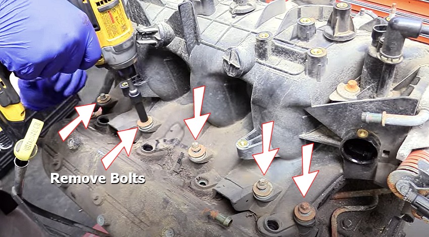

Intake manifolds are bolted to the cylinder head by either right and left sides, or top and bottom. Locate the mounting bolts and remove them, the example below shows right and left side bolts. Before removal use compressed air to clean excess dirt from the intake area.
remove intake manifold bolts

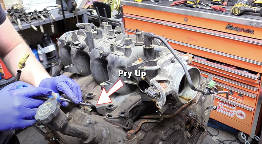

Double check to make sure all mounting bolts have been removed. Use a large screwdriver or pry bar to "pop" the seal loose on the intake manifold.
pry up on intake manifold

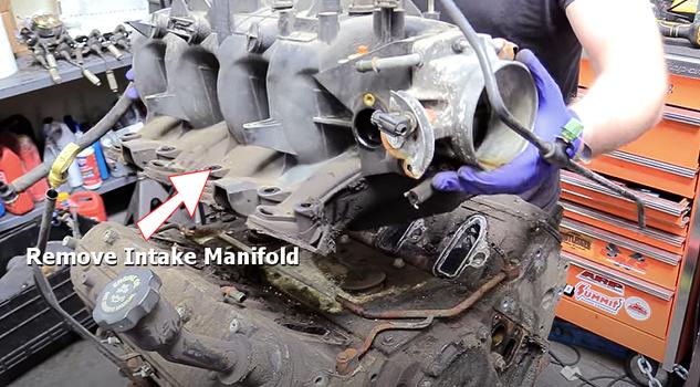

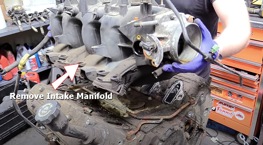

Gently lift the intake manifold from the engine while taking note of any lines or hoses you may have not noticed previously.

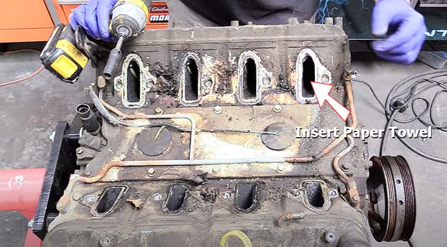

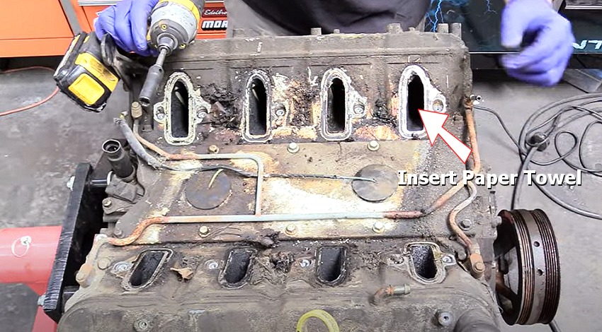

Once the intake manifold has been removed the intake runners in the cylinder heads will be exposed. It is important not to allow any dirt or debris down into the intake runners or engine, before any cleaning can begin insert a paper towel into each port to help stop dirt contamination. Using a gasket scraper to clean the gasket surface thoroughly, then remove the paper towels and you are ready to install the new intake gaskets.

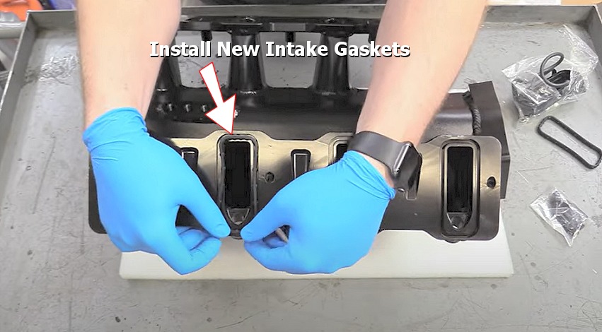

Here we are installing the new intake manifold and gaskets which will vary per application. These particular gaskets do not need gasket sealer or adhesive, they simply press into place, use silicone rubber to help seal at the manifold ends and coolant ports.

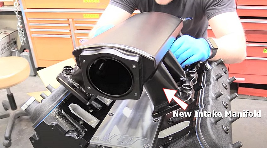

Once the intake is ready to be installed, gently lower it down while lining up the mounting bolt holes onto the clean cylinder head surfaces using the new gaskets. It is important not to move the intake manifold around once it has been lowered onto the engine to ensure the integrity of the gaskets.

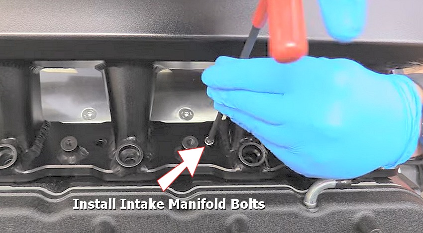

Install the intake manifold mounting bolts by hand in a cross pattern, then tighten by hand from the center working outward in increments. It is important to finish tightening the bolts to the manufacturers specs including the tightening pattern which you can get from one of our experts for free, in this case it was 14 pounds of torque. Do not over tighten or the intake manifold could break. Once complete, reassemble in the reverse order to finish the job and refill with coolant. Some intake manifold jobs will expose the inside of the engine. In this case it is a good idea to change the engine oil and filter, this will help flush out any debris that may have gotten inside of the engine. Start the engine and check for leaks, allow time for the engine idle speed to be relearned by the computer. If the engine is running poorly check the injector wires and coil wire/plug wire connection also check for vacuum leaks. If further problems exist scan the PCM for trouble codes and repair accordingly.
install intake manifold bolts
