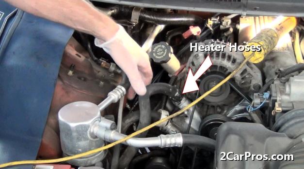

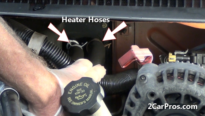

Step 1 - Locate the heater hoses to be replaced and remove or relocate any obstructions.
locate heater hoses

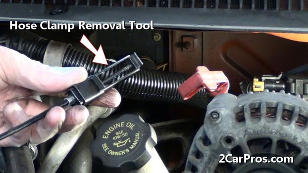

Step 2 - Some vehicles use a spring loaded hose clamp which can be removed by using a special hose clamp removal tool, a pair of pliers can also be used. A worm screw style of clamp will use a screw driver to remove.

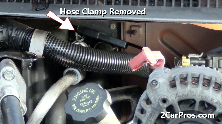

Step 3 - Once the tool has been installed, move the hose clamp to gain access to the hose mounting fitting. (Note: Heater hoses are connected to the heater core, this core is fragile so caution should be used when removing the heater hoses to avoid breaking the core and causing a coolant leak.)
hose clamp removed

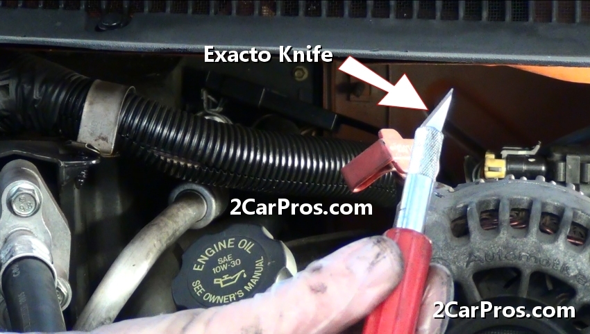

Step 4 - After the hose clamps have been loosened and relocated down the hose, use an exacto knife or razor blade to gently slice the hose long ways along the fitting.
exacto knife

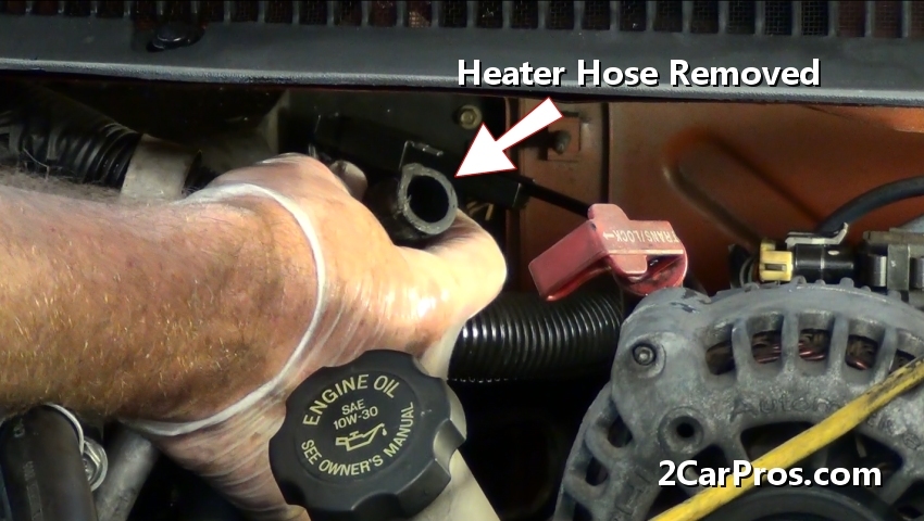

Step 5 - Once the heater hose has been cut, gently lift and twist the hose to release it from the heater core fitting, repeat this process for the remaining hose.
heater hose removed

Step 6 - Next, locate and remove the heater hoses from the engine which are usually near the engine water pump.
heater hoses engine side

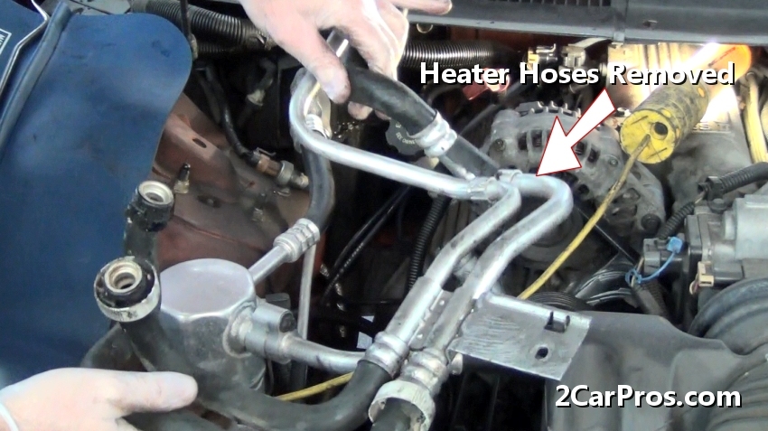

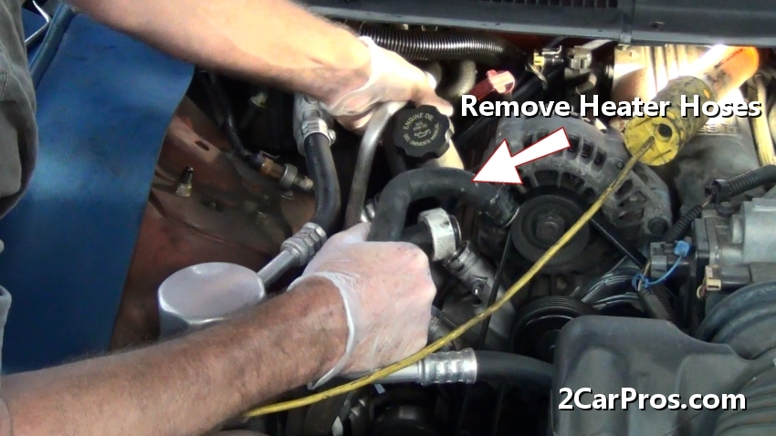

Step 7 - After the hoses have been released from the heater core and engine, remove any remaining mounting hardware and remove the hoses from the engine bay.
remove heater hoses
Step 8 - It can take a little ingenuity to configure the hoses for removal.
heater hoses removed

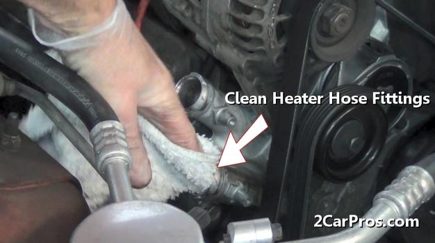

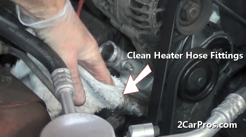

Step 9 - Once the heater hoses have been removed, use a shop towel to clean the heater hose fittings to help seal the new hose installation.
clean heater hose fittings

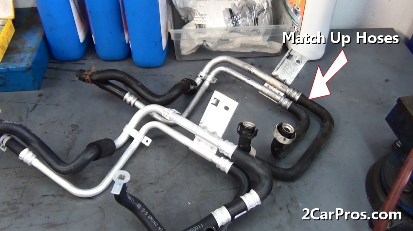

Step 10 - Compare the worn heater hose set to the replacement hoses to ensure a proper installation.
match up heater hoses

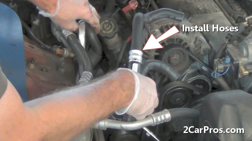

Step 11 - After comparing the new hose set, install the hoses into the engine bay.
install heater hoses

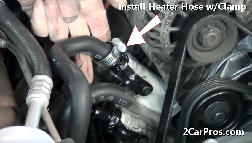

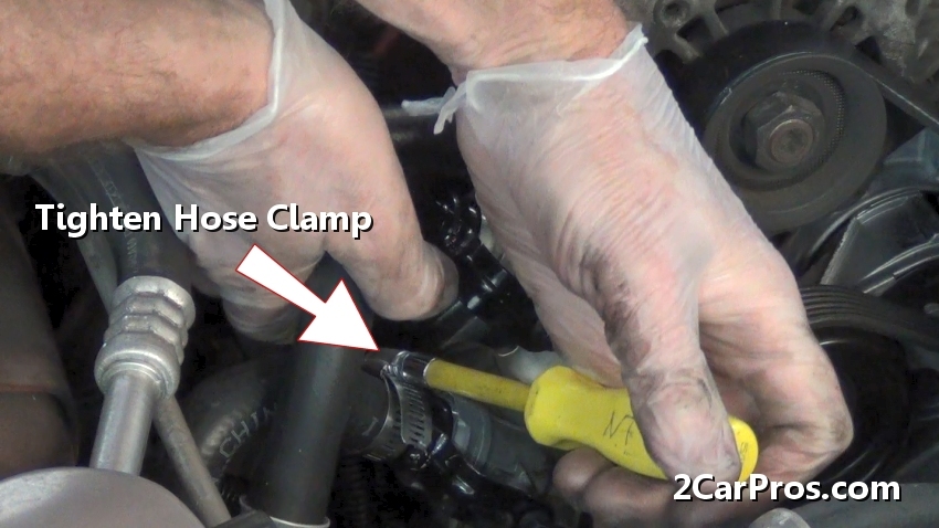

Step 13 - Next, position the hose clamp over the middle of the hose fitting and tighten securely, repeat this process for the remaining hose.
tighten heater hose clamp

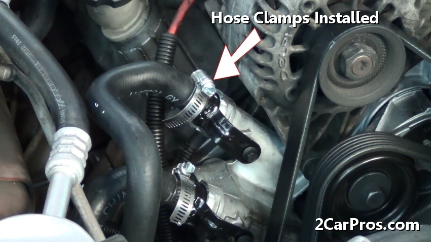

Step 14 - After the hoses are installed and clamps tightened, inspect for obstructions such as metal shielding that can damage the hose and relocate to prevent damage to the hose.
hose clamps installed

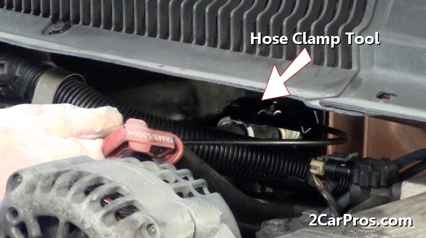

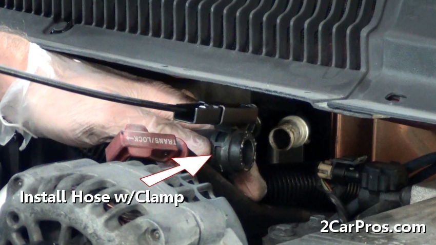

Step 15 - Connect the remaining hose ends onto the heater core fittings using a hose clamp tool to activate the clamp.
hose clamp tool
Step 16 - It helps to activate the clamp tool before attaching the hose to the fitting. (Note: Do not use lubricant to aid hose installation as it may cause it to prematurely fail.)

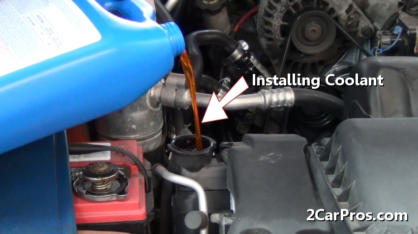

Step 17 - Once the heater hose connections are complete, refill the cooling system. Once the job is complete, and the radiator is being refilled, start the engine and allow to warm up to operating temperature (thermostat open) and top off with coolant, then reinstall the radiator cap. Once the car has been driven, check for coolant leaks and recheck the coolant reservoir fluid level.
installing engine coolant
