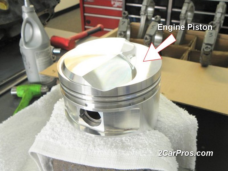

To replace piston rings the piston must be removed from the engine block and replaced (if worn.) For best results the engine block should be bored and new pistons fitted to the connecting rods which should be re-sized. Piston rods can become "out of shape" due to the extreme force they are subjected to. All piston rings are accompanied by a set of installation instructions, these instructions are used to determine the orientation of the piston ring gap. The location of this gap is an important aspect to the performance of the ring. Begin by cleaning the piston thoroughly and securing it firmly in a vise. (Do not tighten against piston, use connecting rod.)

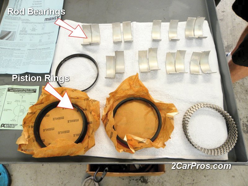

Remove the piston rings from the box and separate them into organized piles on a clean surface, use caution as to not mix rings or turn them over. (Compression rings install one direction only.) Locate piston ring installation instructions and read completely. (Each ring manufacturer has specific instructions.)

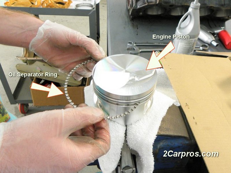

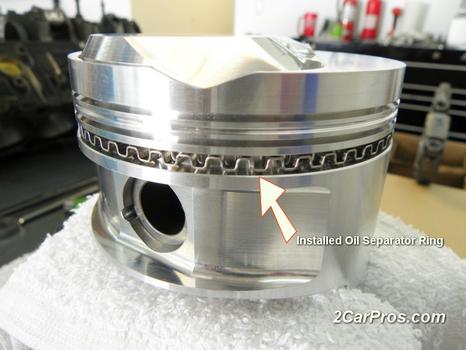

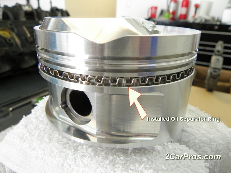

The first piston ring to be installed is the oil separator ring. This ring is used to hold in place both oil wiper rings and is designed to allow engine oil on the cylinder walls to be removed and moved back into the oil pan via oil holes built into the piston. This ring doesn't need an installation tool.
installing piston oil ring
Oil ring separator correctly installed.
piston oil ring seperator

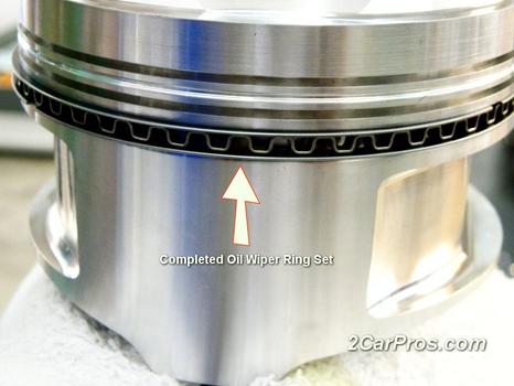

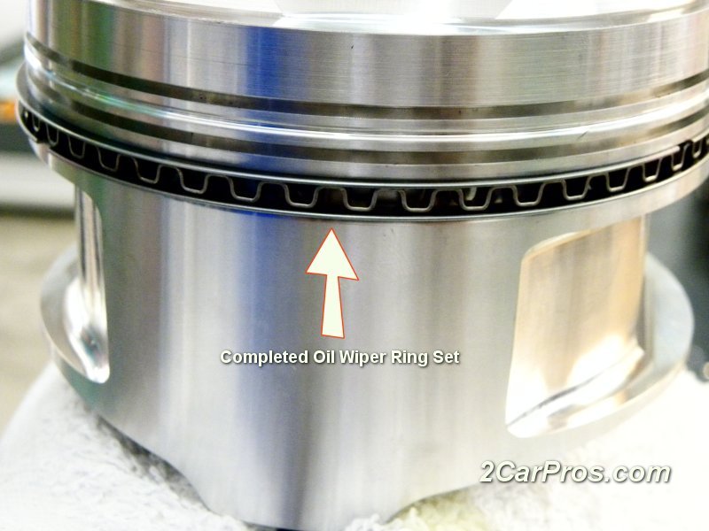

 Once properly installed the individual oil wiper rings are ready to be installed. These rings are unidirectional with no top or bottom unlike most compression rings.
oil wiper ring installation
Each oil wiper ring is held in place by the oil separation ring that is securely mounted in the piston ring groove. These oil wiper rings reside at either end of the separator and are again, unidirectional. Be sure to reference the installation guide to ensure proper placement of the ring gaps.
installed piston oil rings
Once the assembly of the oil wiper ring combination is complete double check the ring gap location as sometimes they can turn without notice while the installing the additional oil wiper ring. Be sure the oil ring is free from carbon, dirt, grease or any debris of any kind. Now we are ready to install the first compression piston ring.

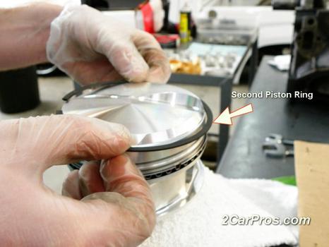

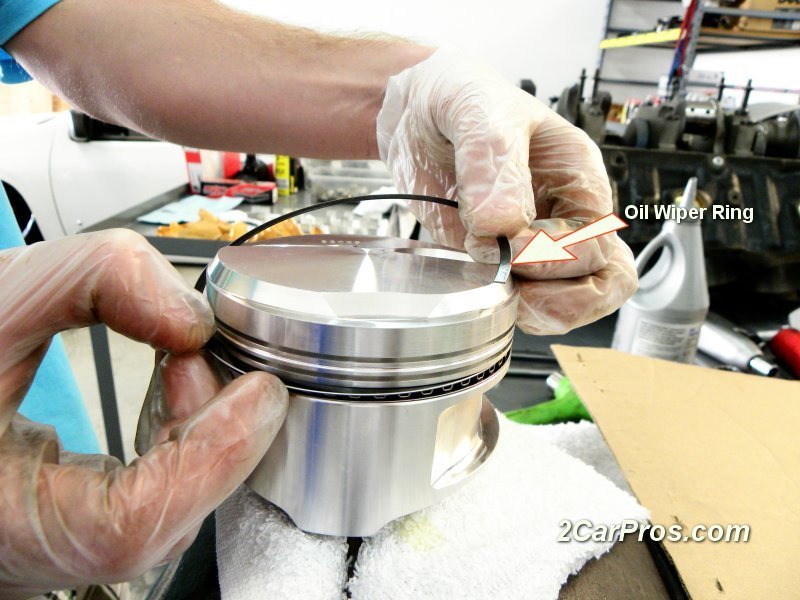

Carefully choose the correct piston ring (the second and first piston rings are usually different from one another.) This ring could have a top and bottom and usually is shown by a small dot on the top flat part of the ring, near the gap. This ring can sometimes be installed without aid of a ring installer. Gently pry the piston ring open just far enough to fit straight over the piston. Do not bend, or swirl the ring onto the piston because it can bend the ring inhibiting its operation. As with the oil wiper rings be sure to locate the ring gap in the correct location on the piston.
installing top piston ring

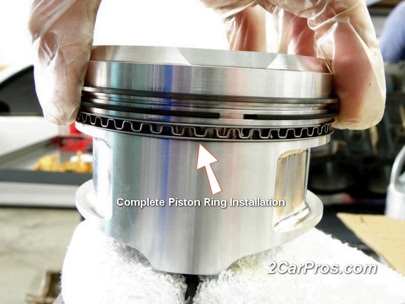

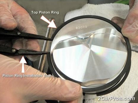

The top and final compression ring is installed at the top of the piston, a tool is needed to help spread the ring due to its rigid nature. Like the second ring the main compression ring must be installed with the top of the ring facing upward. If the piston rings are installed incorrectly the piston (engine) will have low compression and may burn oil. Be sure the ring gap is in its proper placement for optimum performance. Once all piston rings have been installed perform a final ring gap location inspection. Always be sure the piston rings are "free floating". Ring must be able to move freely on the piston or it will inhibit proper operation.
installed new engine piston rings

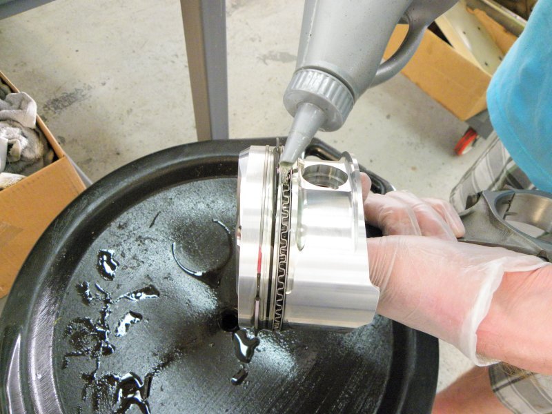

Before installation, piston rings must be lubricated (oiled) this helps the piston rings "mate" to the piston and the cylinder walls. Also include wrist pin and piston skirts in the lubrication process. Repeat this process for all pistons to be installed into the engine block, once completed the pistons are ready for installation. Store assembled pistons in a clean dry area if they are not immediately used.
oil piston rings

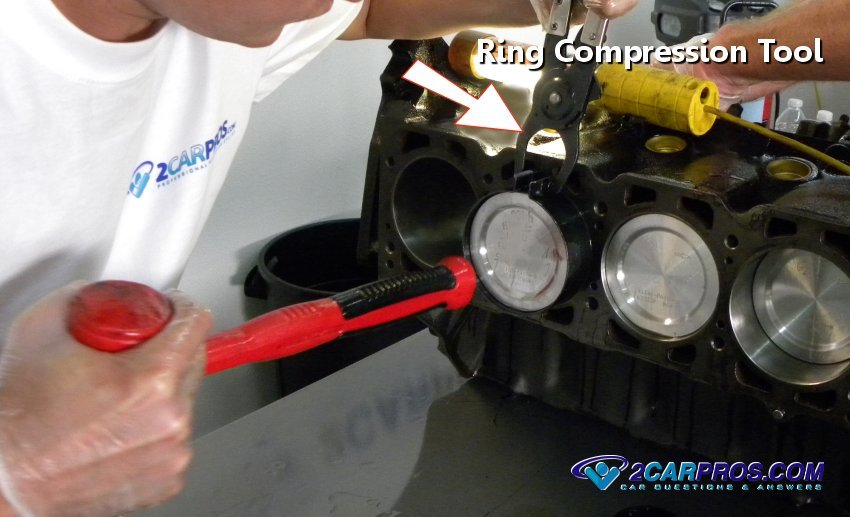

 Once the piston rings have been installed onto the piston clean the cylinder bore and apply a thin layer of oil onto the cylinder walls. Using a ring compressor hold the rings against the piston while using a plastic or rubber hammer to gently tap the piston into the bore. This can take some time and practice but hang in there, the first one is the most difficult. Once new piston rings have been installed allow a break in period before subjecting the engine to full load, this will allow the rings to properly mate to the freshly machined bore. These "break in" procedures will help the engine perform to its utmost ability while controlling oil consumption.
