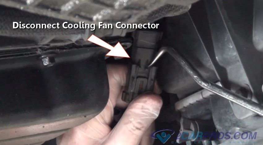

Drain the cooling system and locate and disconnect the electrical connector for the cooling fan.
disconnecting cooling fan connector

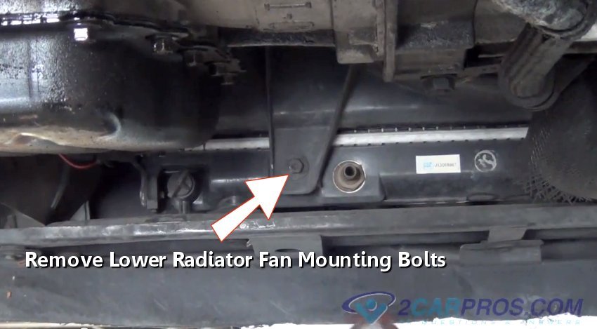

Remove the lower mounting bolts that attach the fan to the radiator. (Note: Some vehicles have alignment dowels which need not be removed.)

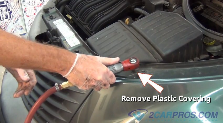

Loosen mounting bolts or clips to remove any plastic shielding that will inhibit the replacement of the cooling fan.
remove plastic covers

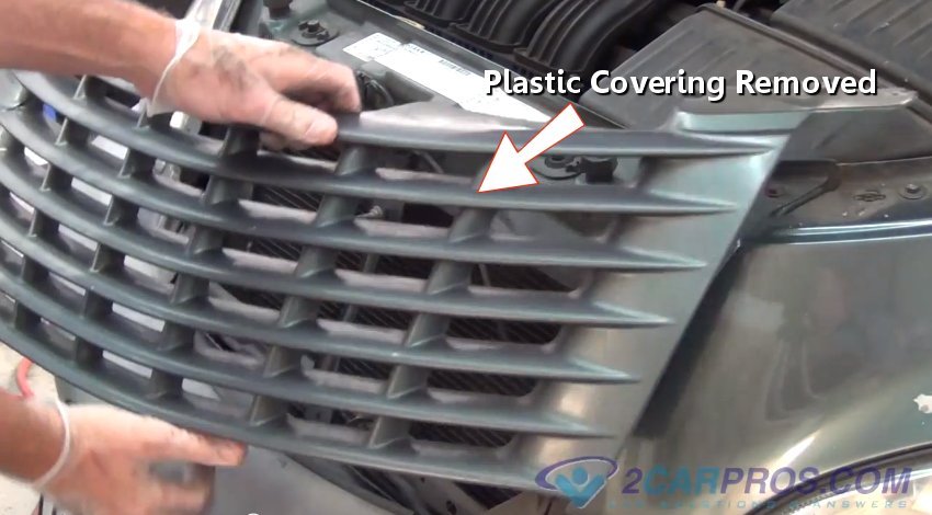

Once all mounting bolts have been removed, lift the plastic covering from the vehicle.
plastic cover removed

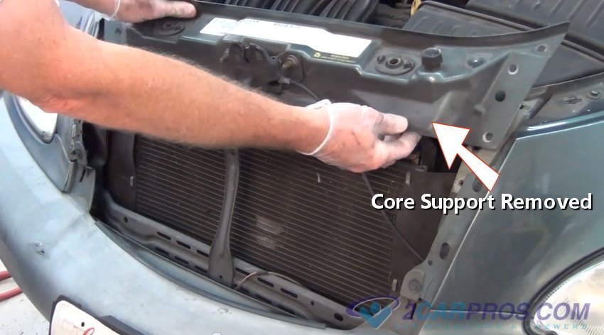

Lift the core support from the vehicle, a hood cable release could be mounted to this support.

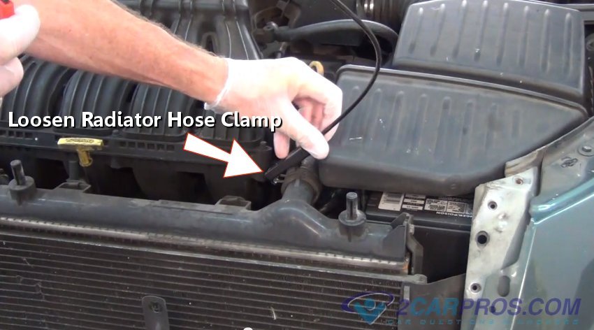

Loosen the upper radiator hose clamp using a hose clamp tool or channel locks. Grasp the hose and twist using a hose pick or screwdriver to assist.

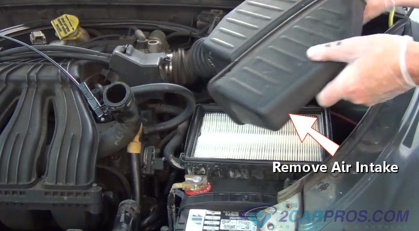

Undo the mounting clips or bolts that hold the air intake in position, this step needed only if the air intake is blocking the removal of the cooling fan.

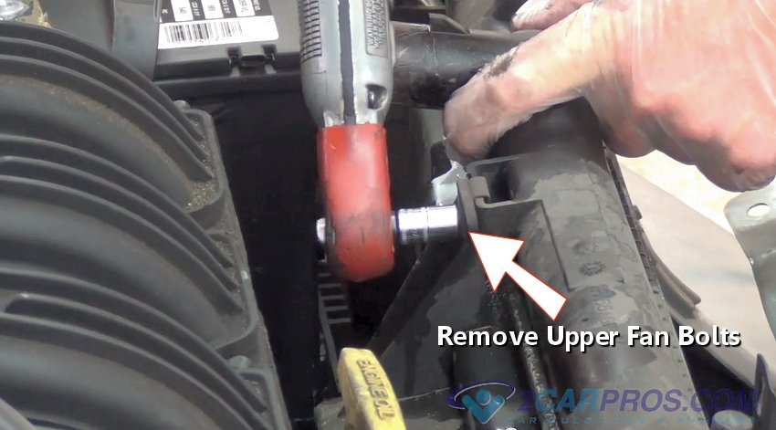

Loosen and remove the upper mounting bolts from the cooling fan radiator mount.
remove upper cooling fan bolts

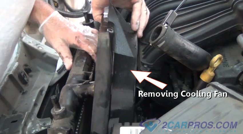

Recheck that all mounting bolts and clips have been removed, gently lift the cooling fan from the engine bay, be careful when performing this action as to not damage the radiator cooling fins.
removing cooling fan

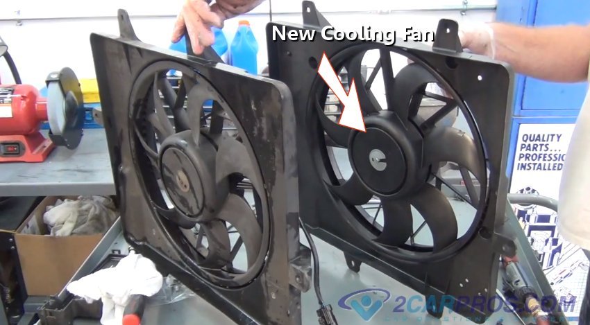

Compare the old fan to the replacement cooling fan. Inspect mounting tabs and electrical connector to ensure proper installation, some cooling fan designs feature the replacement motor separate.

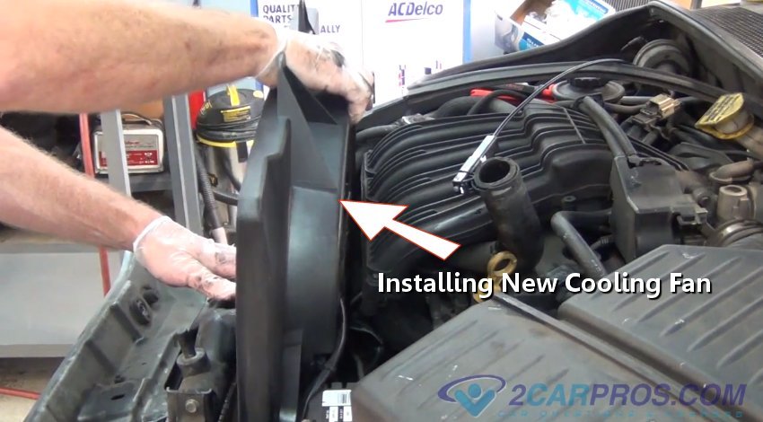

Gently lower the new cooling fan down into the engine bay and onto the radiator. Again, use caution when performing this as not to damage the radiator cooling fins. Reinstall all mounting bolts and refill cooling system and check the coolant reservoir, add coolant to the radiator as needed. Once these steps have been completed, simply reverse the order to reassemble. Start the engine and turn the air conditioner "ON", or wait until the engine reaches operating temperature to check for fan operation and recheck coolant level.
