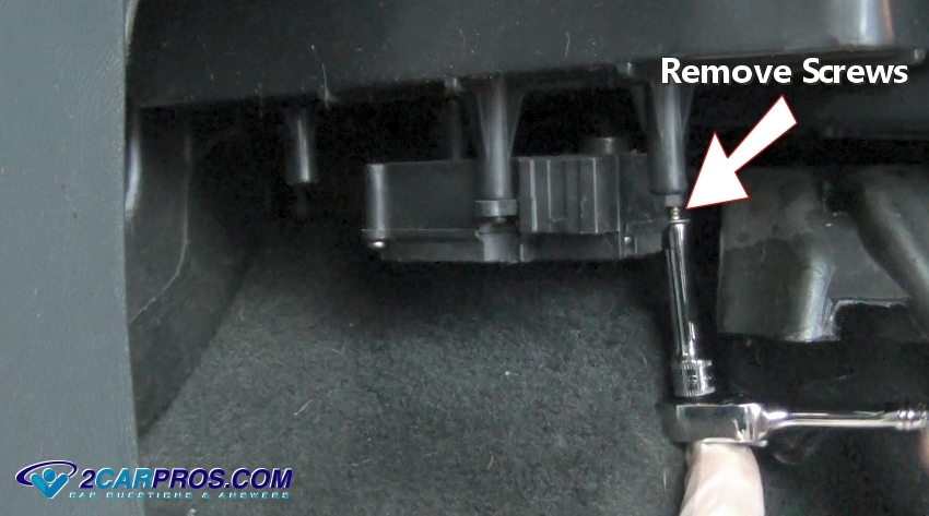

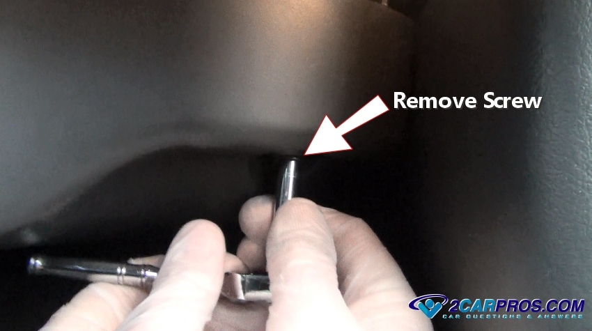

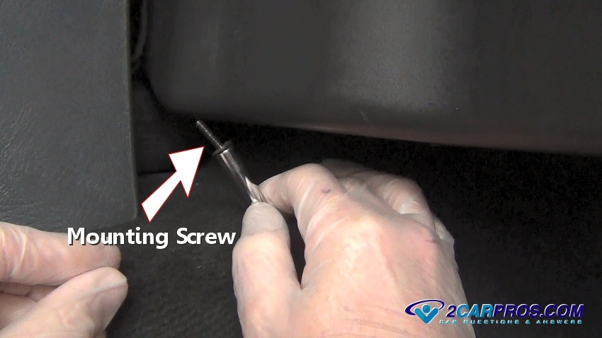

1. Most of the time a panel or two will need to be removed to complete the job. Using a small socket and ratchet remove the mounting bolts that hold the under dash plastic cover on the passenger side, these screws can be in obscure places so look around for them.
remove cover screw

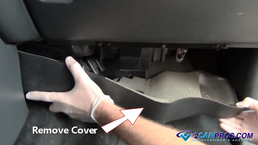

2. Once you have located and removed all of the mounting screws grasp the cover and gently pull it from the underside of the dash. This will expose the heater box with various controls including any wiring.
remove under dash cover

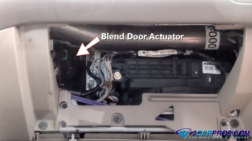

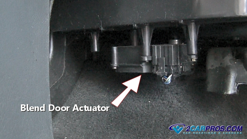

3. Here is what it looks like when the glove box is removed exposing the blend door actuator for replacement.
bend door actuator
Remove the Door Actuator
4. Here is a typical right side temperature actuator used for dual climate controls (also temperature for signal mode units). This actuator hangs below the box which is one of the easier units to replace.
bend door actuator

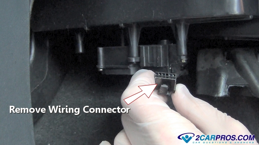

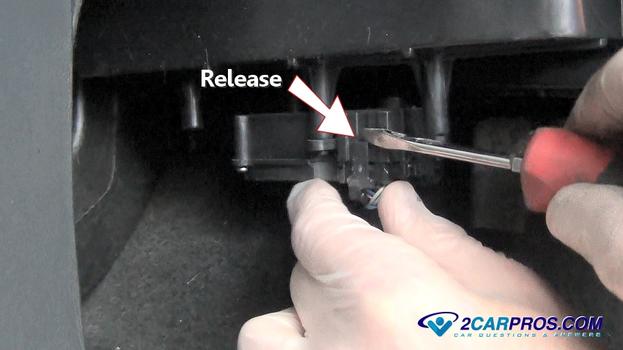

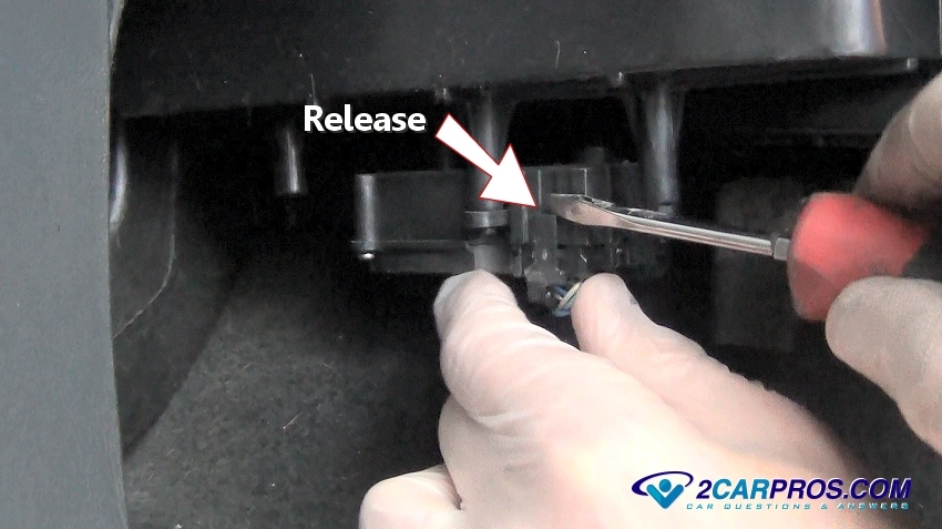

5. Begin by using a small screwdriver to release the wiring safety clip on the harness for the actuator. These clips can be brittle and break so be gentle.
bend door actuator
6. Once released gently pull down on the wiring connector and remove it from the blend door actuator. Inspect the connector for rust or corrosion and clean as needed.
remove blend door actuator wiring conenctor

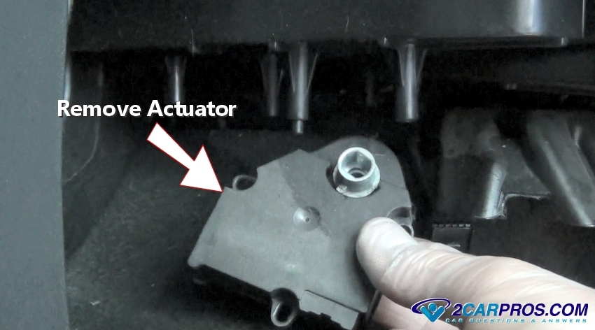

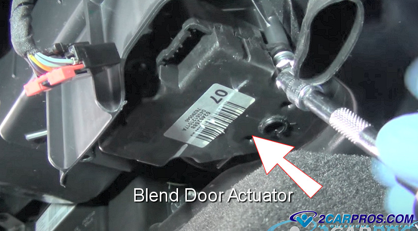

7. Locate and remove the actuator mounting screws. There should be two or three screws holding it in place. A small universal might be needed to help remove the screws in awkward places. Once removed place the screws into a small container so they don't get lost.
remove actuator screws
8. Once all of the mounting screws have been removed the actuator should become loose. Grasp the actuator and pull it from its mount to remove.

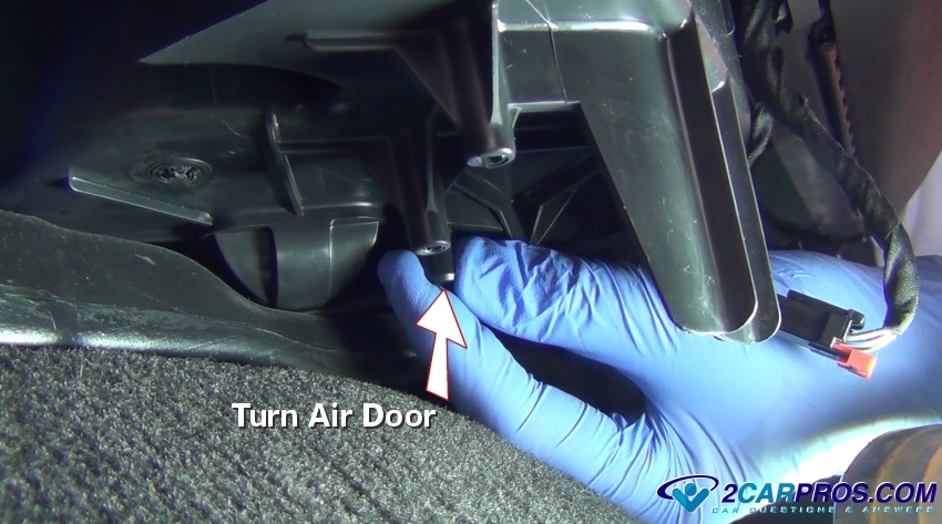

Turn the Air Door Pivot
9. Before installing the new actuator it's a good idea to manually turn the blend door in both directions to ensure it is not stuck which will cause the new actuator to fail. Grasp the door pivot and move it back and forth to its full travel, it should move freely. If you cannot move the blend door an obstruction has gotten in the way of the door movement. These obstructions include: pen, tooth pick, small toy or bubble gum to name a few. If the door is stuck the heater plenum with need to be removed and the problem resolved before installing the new unit.
To test the blend door operation and to double check that you are changing the correct actuator motor turn the blower motor on and work the door in each way. You will be able to feel the air change temperature or vent level.
turn blend door pivot

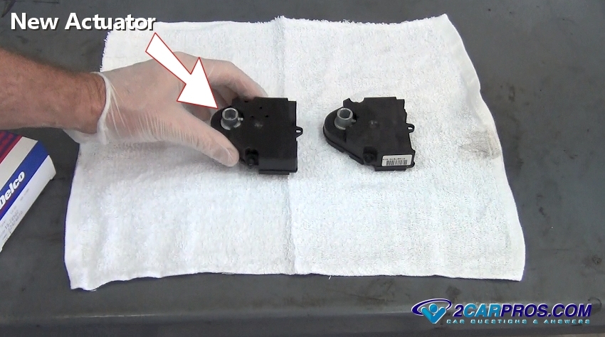

10. Compare the bad actuator to the new unit. Be sure to check the wiring harness connector terminals they should match identically. Now the new part is ready to be installed.
new blend door actuator

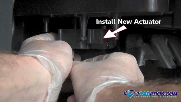

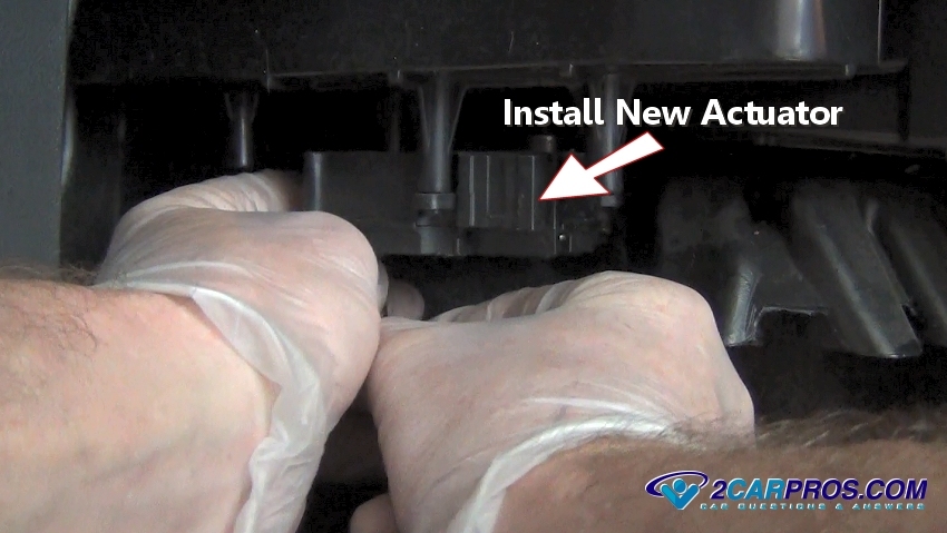

11. Install the new part in place as you insert the mounting screws by hand. Be careful not to cross thread the mounting screws because they thread into the plastic housing and can easily strip, (do not over tighten).
install new blend door actuator

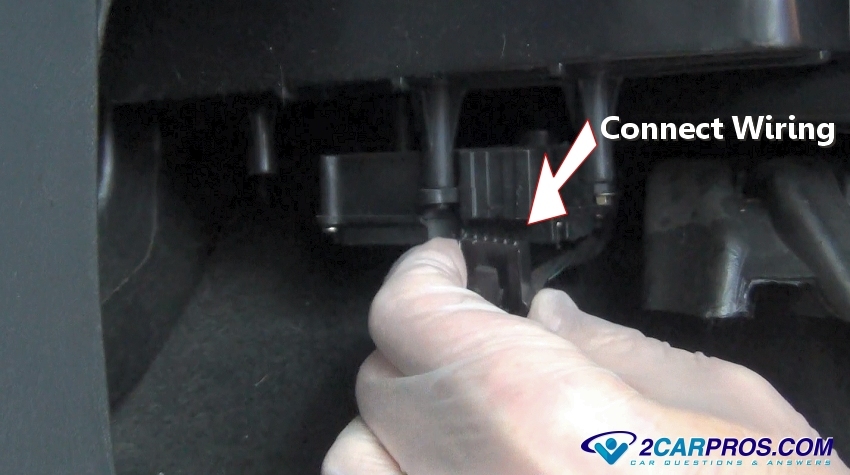

12. Once all screws are in place firmly push the wiring harness connector back into the actuator. You should hear a click signaling the correct installing of the connector.
connect blend door actuator wiring

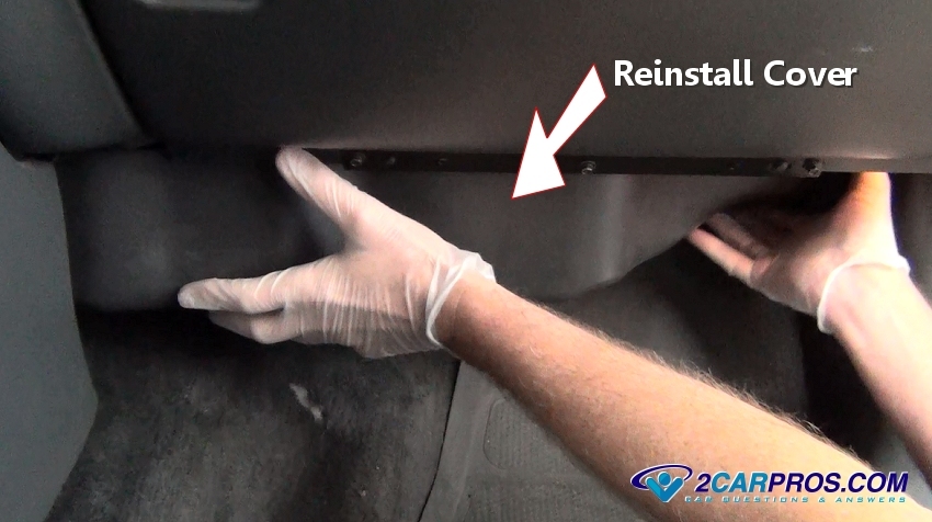

13. After the installation is complete double check your work and reinstall the plastic cover. This can take some jostling to get the bolts holes lined up so hang in there.
reinstall under dash cover

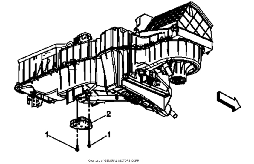

You can use a repair resource such as Mitchell1, a paper manual found on Amazon or a resource like Google images to locate the particular area in which the actuator needs to be replacement.

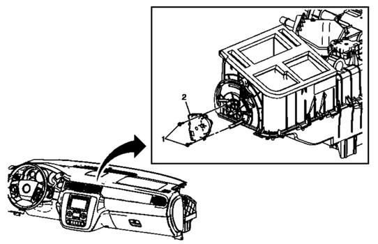

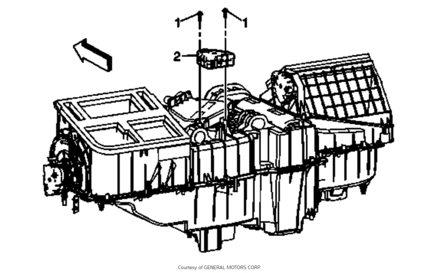

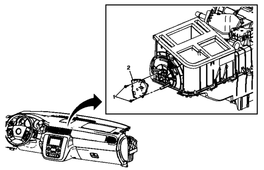

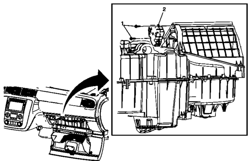

Here is an example of a Silverado, Suburban and Tahoe locations.
Recirculation Actuator
recirculation blend door actuator location
Mode (Defrost Mid Vent and Floor) Actuator Location
mode blend door actuator location
Left Temperature Actuator Location - Signal System Temperature Actuator
right blend door actuator location
Right Temperature Blend Door Location
left blend door actuator location
