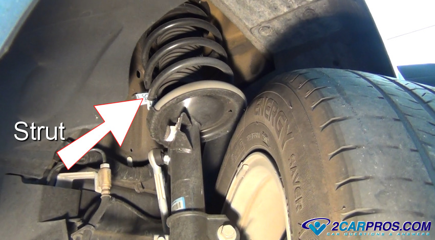

There are three kinds of suspension configurations: Strut type, this is the much easier suspension to deal with because the spring is contained within the strut so there is less danger. Here is what the strut style of suspension looks like which is most common.
strut suspension type

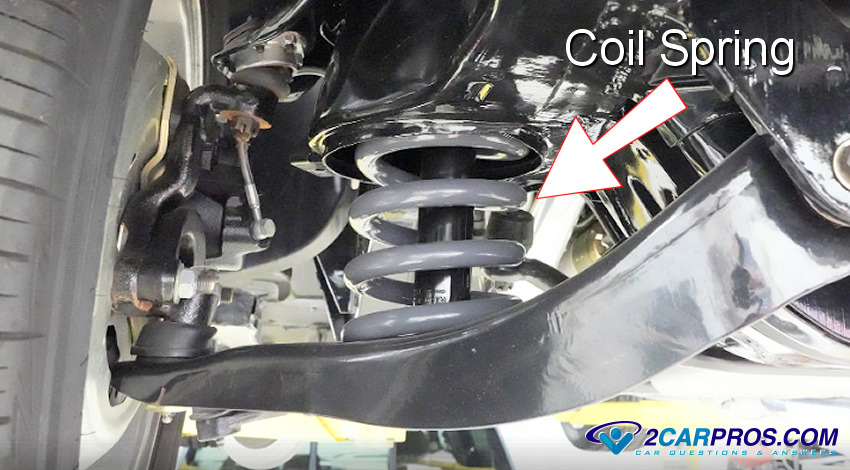

The other two are coil spring, and torsion bar style of suspension in which the spring presses against the lower control arm. For this style of suspension you must use a spring compressor, or release the torsion bar tension before replacing the ball joints. Here is an example of the coil spring suspension.
automotive coil spring suspension

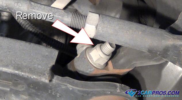

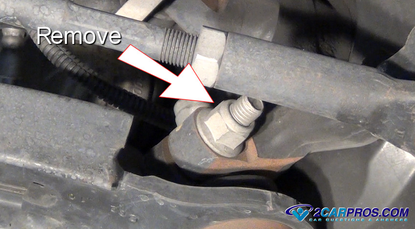

1. Remove the ball joint retainer nut or pinch bolt which will be at the end of the control arm connecting the spindle. If the ball joint has a nut the tapper joint will need to be released. This tapper joint release guide is on a tie rod but the process is the same. The pinch bolt may require you to wedge the spindle slot open and help in it's removal.
remove ball joint pinch bolt

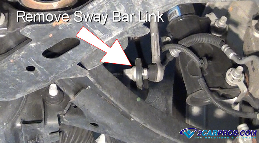

2. Locate and remove the sway bar link from the lower control arm.
remove sway bar link

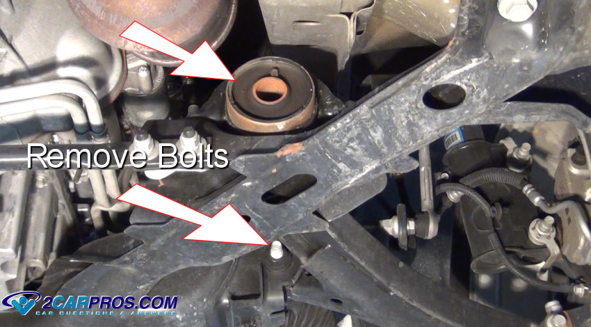

3. Loosen and remove the lower control arm bushing bolts, keep your hands on it because it will drop down from here.
remove control arm bolts

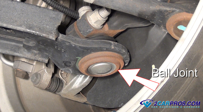

4. Now the control arm or ball joint is ready to be replaced. If you are replacing the ball joint separately you can heat up the outer ring of the control arm to help loosen the joint. Then use a ball joint press tool and help in it's removal, once removed, clean the surfaces and install the new part. The ball stud may be riveted to the control arm, using a drill you can remove the rivets and remove the ball stud from the control arm.
