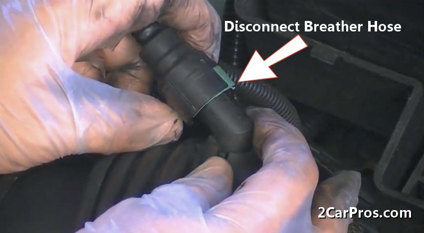

Engine breather tubes maybe connected to the boot/tube which is used to ventilate the engine crankcase gases into the intake system to be re-consumed by the engine combustion process. These tubes are held in place by a plastic clip. Use a small screwdriver or pick to lift upward the fastener which will enable you to remove this connection.
removing breather hose

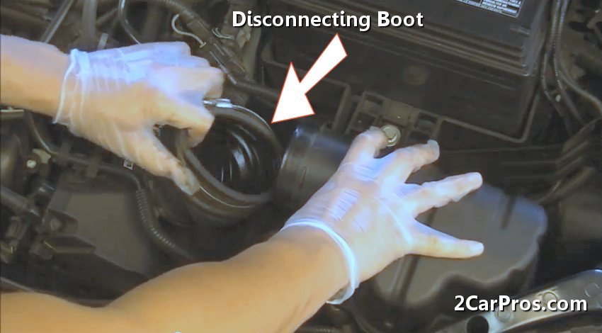

Sometimes the boot can be stuck on the intake tube or air cleaner housing due to heat from the engine and pressure from the clamp. Use a screwdriver or pick to help break the seal and while performing a twisting motion to help loosen the seal and remove one end of the boot.
disconnecting intake boot

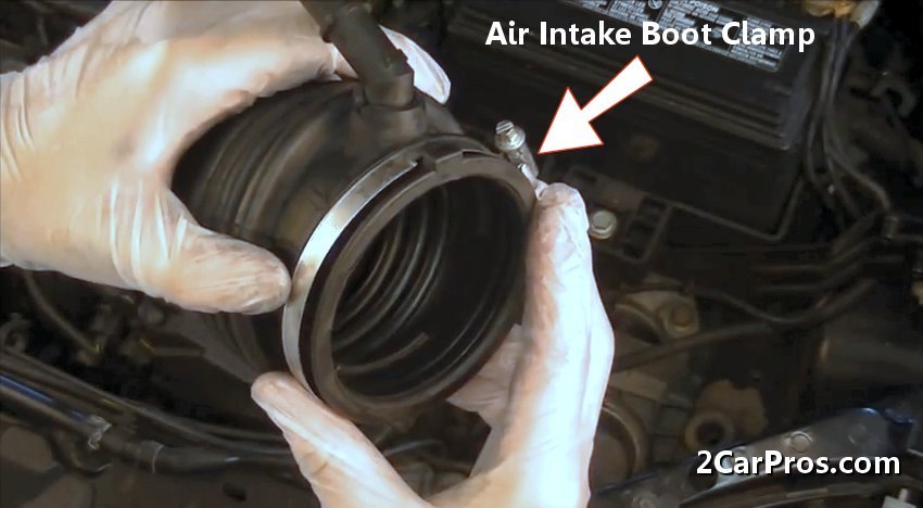

Match the new boot to the old unit, they should match up identically. Reinstall mounting clamps onto the new boot or tube. Take note of the clamps orientation which will make installation much easier.
air intake boot clamp

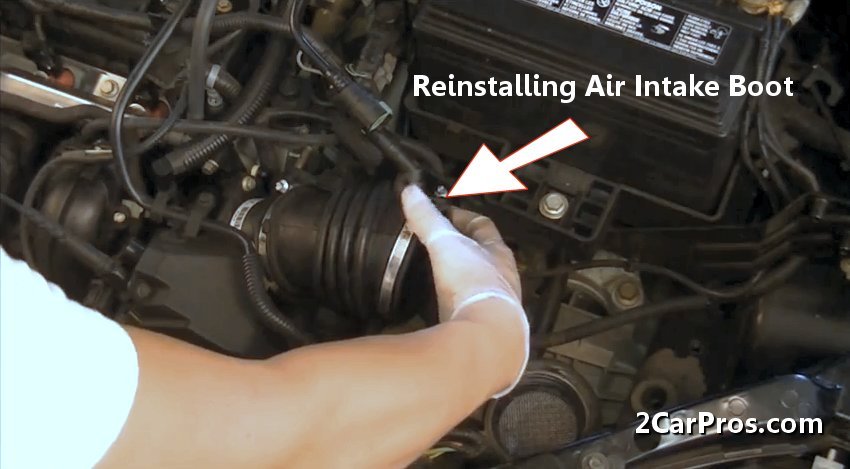

While holding the new boot firmly with one hand while making sure the clamps do not fall off, reinstall the new air intake boot onto the throttle actuator first. Be sure not to get any dirt into the area during the installation process.
installing air intake boot

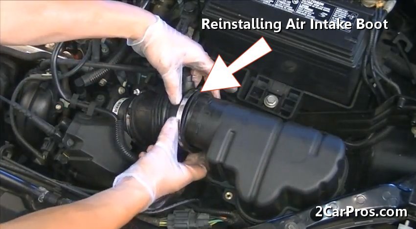

Finish by installing the air intake tube while fitting the boot end on the tube and onto the air filter housing or mass air flow sensor while tightening the clamps snugly, do not over tighten. Some tubes will have an orientation tab which must be fitted into its proper slot. Start the engine and listen for any vacuum leaks or hissing sounds which would be an indication of the boot lip being folded under either on the throttle actuator or the air filter housing.
