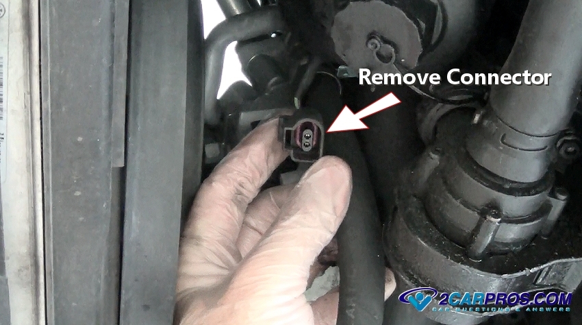

Locate the electrical connectors on the front or rear of the compressor and disconnect, use a small pick or screwdriver to release the connector safety. If this connector cannot be seen, or its too difficult to remove you can do so once the mounting bolts have been removed for the compressor.
remove electrical connector compressor

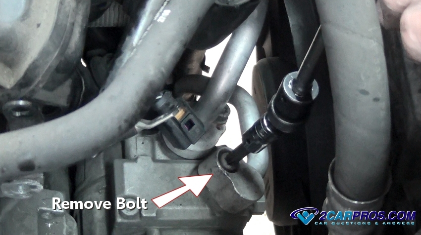

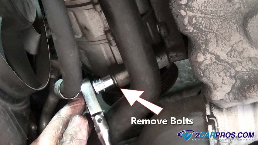

Locate and remove the high and low side refrigerant line mounting bolts or flare nuts depending on the manufacturer's design. Again, on some models this step may need to be performed after the mounting bolts have been removed and the compressor is loose.
remove compressor hose high side

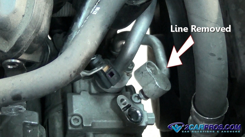

Firmly grasp and wiggle the bulkhead of the refrigerant lines to slowly pull upward to disconnect them from the compressor. There is an O ring seal which can make a tight fit, also a small amount of refrigerant (pressure) maybe released as well which is normal. Complete this step by removing both high and low side hoses.
high side line removed

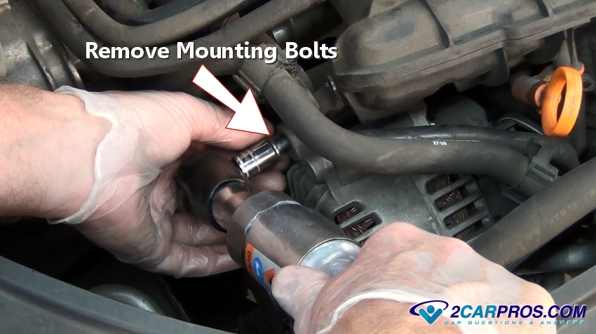

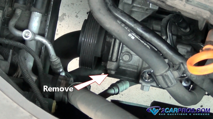

Locate and remove lower and upper mounting bolts. These bolts can consist of long and short bolts which sometime can be obscure and difficult to get to, if so use a universal joint socket or small wrench to aid in the removal. Always leave at least one loose bolt connected to the bracket or block to hold the unit in place.
remove compressor mounting bolts
Grasp the unit while removing the last mounting bolt. The compressor is a little heavy and a bit awkward so be careful it doesn't fall and cause damage to the unit or yourself. Once completely loose remove it from the engine bay. This can sometimes take some finagling, or possibly even loosening the engine mounts while using a floor jack under the oil pan with a block of wood to help lift or lower it slightly. Other times the radiator or cooling fan shroud must be removed as well.

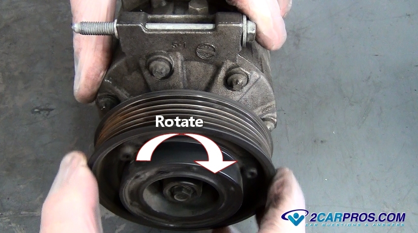

Once the old AC compressor has been removed, turn the pulley or clutch to determine its condition by checking for rough movement or grinding noises. If present, this sometimes can mean the system is contaminated with foreign metal or seal material debris from the failed unit which can plug the orifice tube or expansion valve. In these cases the system must be flushed by using an a/c system flush kit which can be purchase from Amazon or the local parts store.

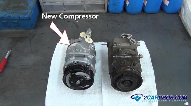

Step 4: Preparing the New Compressor

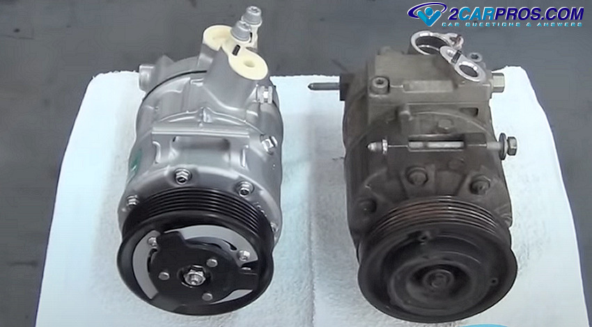

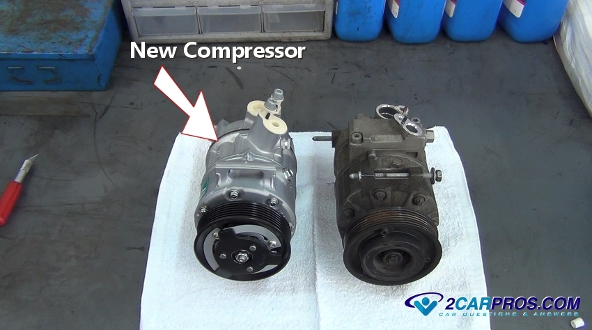

Compare the new compressor to the old unit to ensure a proper installation. Sometimes the replacement unit can look slightly different due to updates and slight design variations. One thing to look for is the configuration of the refrigerant ports on both the intake and exhaust sides. Also, check the belt pulley by counting the number of ribs which the belt must ride in, also the outside diameter of the pulley must be correct as well.
new air conditioner compressor

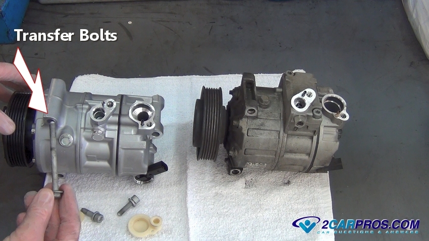

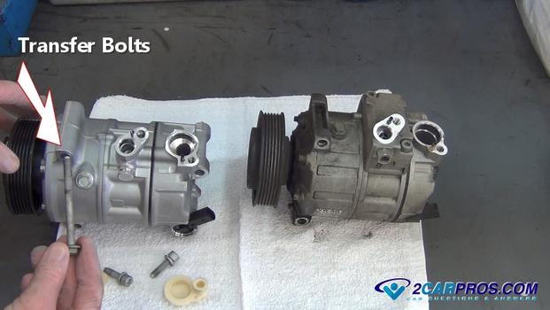

When installing the new compressor into the engine bay it's a good idea to transfer some of the mounting bolts from the old unit to the new one before lowering or raising it into the engine bay, this will help for an easier installation.
transfer compressor bolts

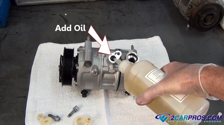

Though the system has PAG oil throughout its internal workings and is usually including in the new compressor, it's a good idea to drain the new compressor of and then add new oil to ensure proper lubrication before installation, then reinstall dust caps. Some units have the correct amount of oil already installed, be sure to read the installation tag which is supplied with the replacement unit.

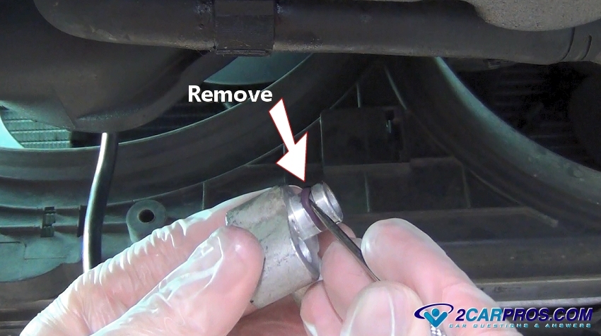

Step 5: Replacing O Ring Seals
O rings are used to seal the high and low side lines to the compressor housing. These sealing surfaces must be clean and free from dirt or damage to keep them from leaking. Use a small screwdriver or pick to carefully remove the old O ring seals from both the high and low side lines without scoring the sealing surfaces.
remove o ring

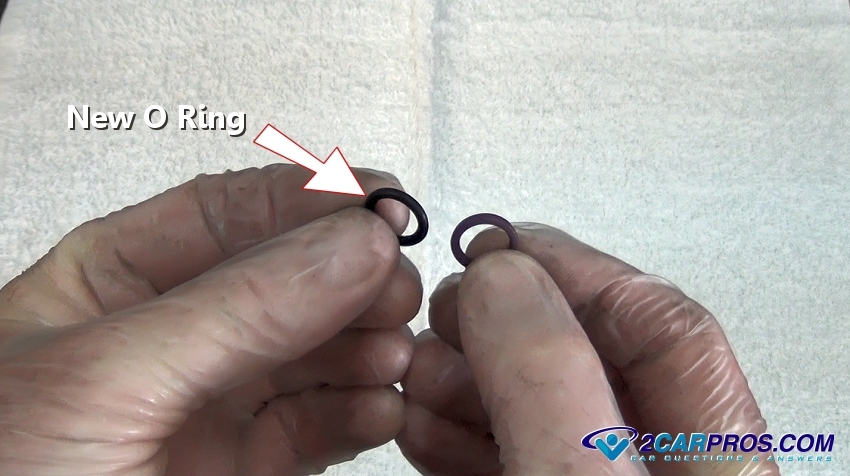

Match the old O rings to the new ones to ensure a proper seal. Keep an eye on the O ring thickness because some rings can be smaller in diameter then others. It's a good idea not to reuse the old seals because they become flattened over time due to pressure and heat and may leak which would cause the job to be redone.
new o ring seal

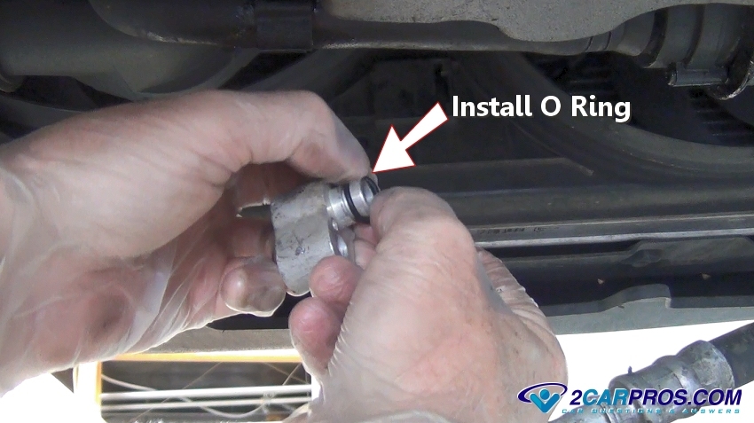

Apply a thin layer of PAG oil over the O rings to help the installation without damaging or cutting the new seal, repeat this process for each line.
installing o ring seal

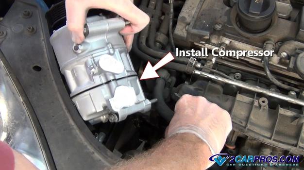

Step 6: Installing the New Compressor
Clear any hoses or lines while gently lowering the new unit into the engine bay. Hand thread in the mounting bolts which will hold the unit into its mounts or engine block.
install compressor

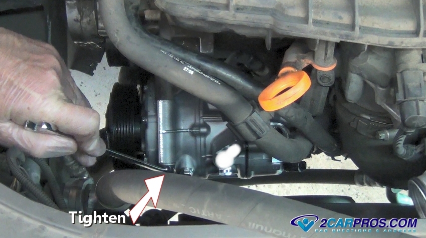

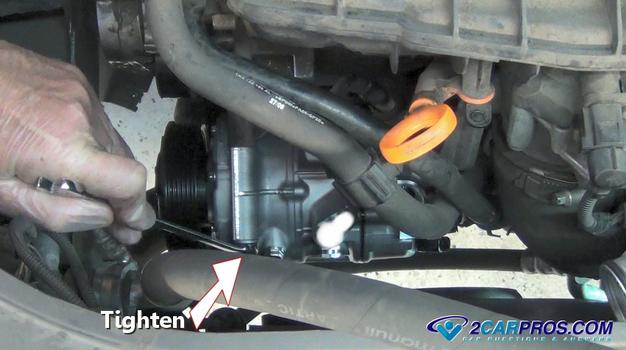

Once all mounting bolts have been hand threaded in, use a wrench or socket to tighten the mounting bolts evenly and in a cross pattern. This will help to not distort the housing which can cause premature failure.
tighten compressor bolts

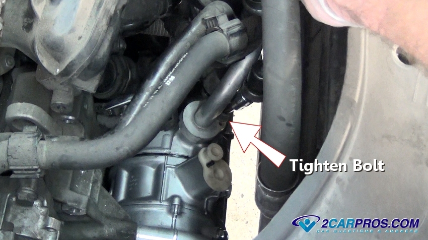

Remove the port dust covers and install both high and low side refrigerant lines with the mounting bolts and then tighten. These bolts don't need to be extremely tight just snug enough to not come loose and seal against the housing. Torque specs for the bolts can help.
tighten line bolt

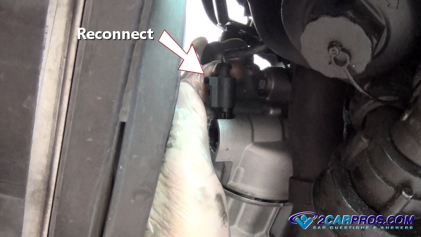

Make sure the electrical connector is clean before reconnecting it to the clutch coil or refrigerant control valve at the rear of the compressor housing.

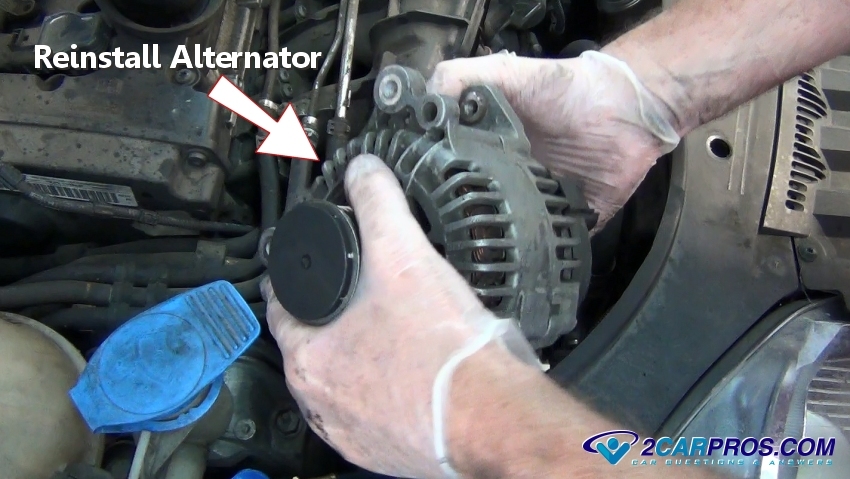

Reinstall any accessories such as the alternator by gently lowering them into the engine bay while installing the mounting bolts and electrical connectors. At this time is it a good idea to replace the serpentine belt with a new one. Double check the alignment of the belt by inspecting the pulley of each accessory and drive pulley located on the engine crankshaft.
reinstall alternator

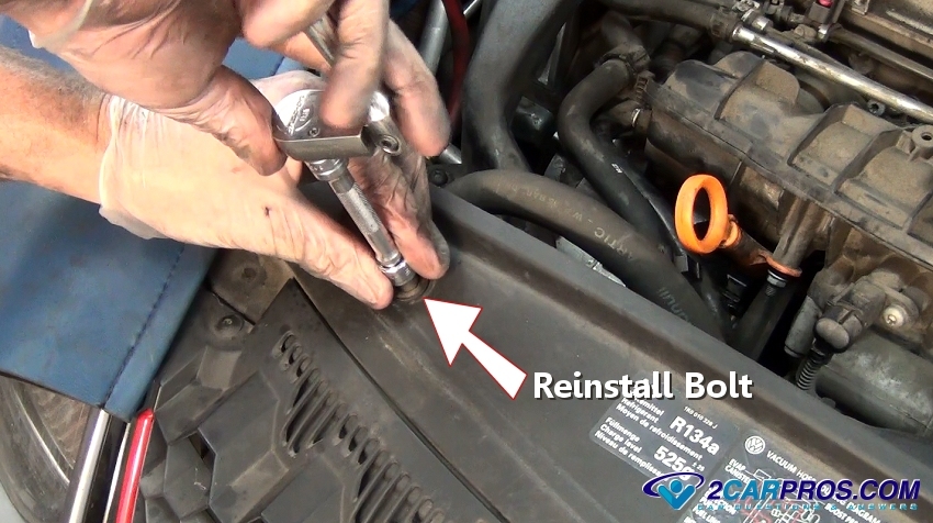

Reinstall any tubes or hoses removed in the replacement process, continue by tightening all bolts, screws, clips or brackets previously removed. Now the system is ready to have a vacuum down and recharge service performed. Never simply fill the system with refrigerant because there is moisture is present inside the system due to the normal atmosphere that entered once the system was opened. This can cause the compressor to fail prematurely and the AC system not to work as well as it should.
reinstall bolt
