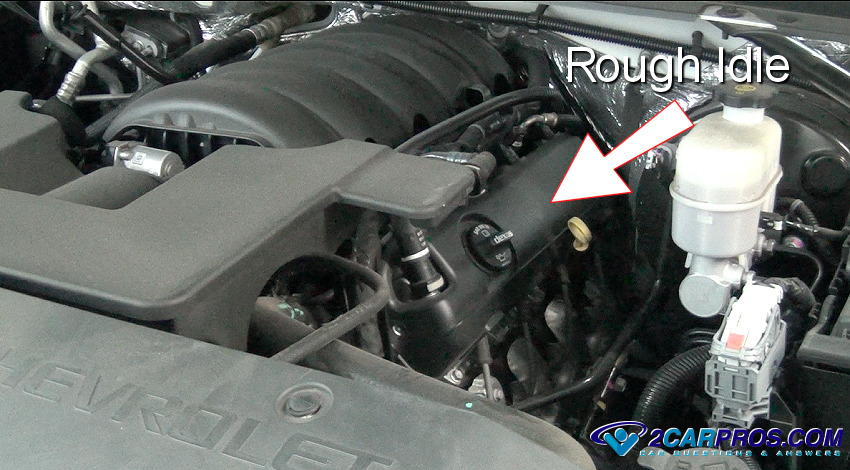

A rough engine idle condition is a common issue that many drivers face often indicating underlying problems within the engine, fuel or ignition system. We have created this guide to identify and repair most rough idle conditions and have listed them in order of popularity as it applies to automotive combustion style of engines. When a combustion engine is at idle, it is susceptible to a rough idle due to the low engine speed, at this point the engine mechanical integrity, fuel and ignition systems must be in proper working order.

Park your car on level ground with the engine off, open the hood and do a visual inspection for anything obvious such as a broken vacuum line or loose a ignition coil. Also, if you have a check engine warning light on you should run the codes first to see which ones are stored, this will help guide us in the right direction and avoid unnecessary repairs.

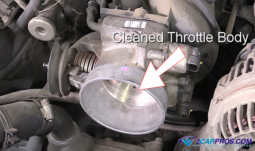

4. Throttle Body Service: This might seem strange to some, but if the throttle body is not serviced it disrupts the airflow into the engine's intake manifold which can lean out a random or particular cylinder. This is why most repair shops will recommend a throttle body service when a tune up is performed.
cleaned automotive engine throttle body

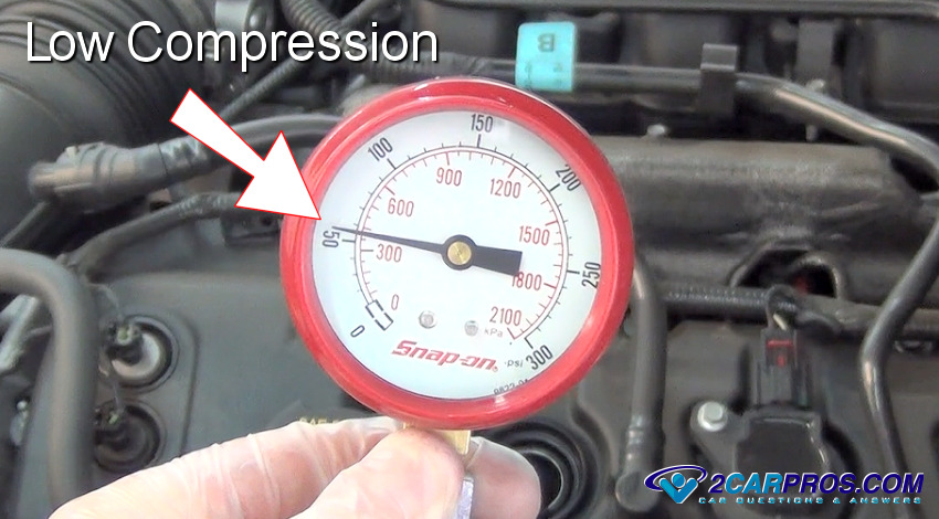

6. Low Cylinder Compression: If the compression is low on one or more cylinders it will cause a rough idle condition. This is easily checked by removing the spark plugs and doing a compression test. This can be caused by a badly leaking intake or exhaust valves, bad piston rings or a blown head gasket.
automotive engine low compression

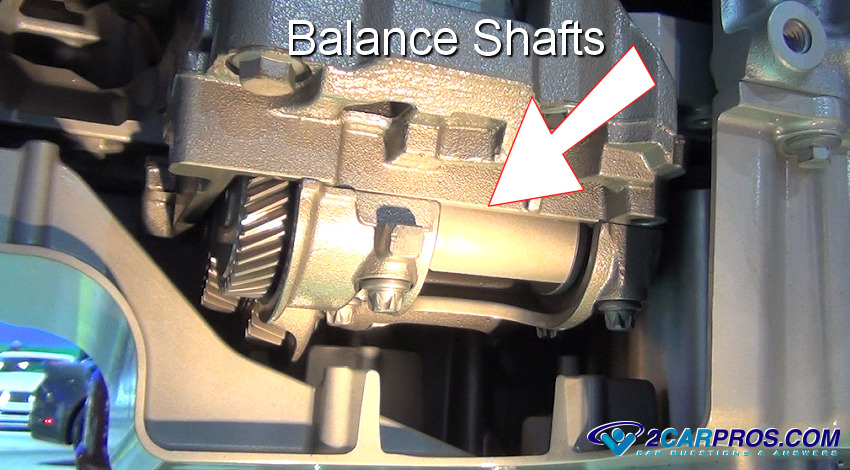

7. Balance Shaft Failure: Most engines are designed with a balance shaft assembly built inside the engine which does exactly what it says, it balances the engine to stem off vibration, this is most noticeable at idle. This system can stop working due to drive gear or chain failure, or one of the shafts can break. Here is what the balance shaft set up looks like in the image below.
automotive engine balance shafts
