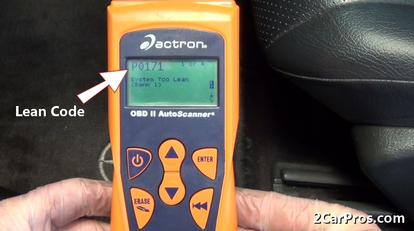

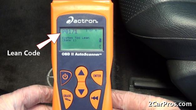

Once a check engine or service engine soon light has determined a lean engine code has materialized, a repair procedure inspection is needed. Explanation: A lean code is enabled when the computer has detected enrichment adjustments have maxed out, with no results, this inability triggers the lean code.
lean trouble code

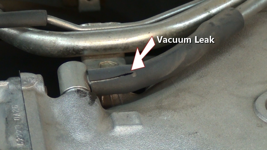

Un-metered air which enters the intake system of the engine can cause a lean mixture code to be triggered, inspect all vacuum lines for cracks or dilapidation. Check the integrity of vacuum hoses at each end of the hose.
vacuum leak

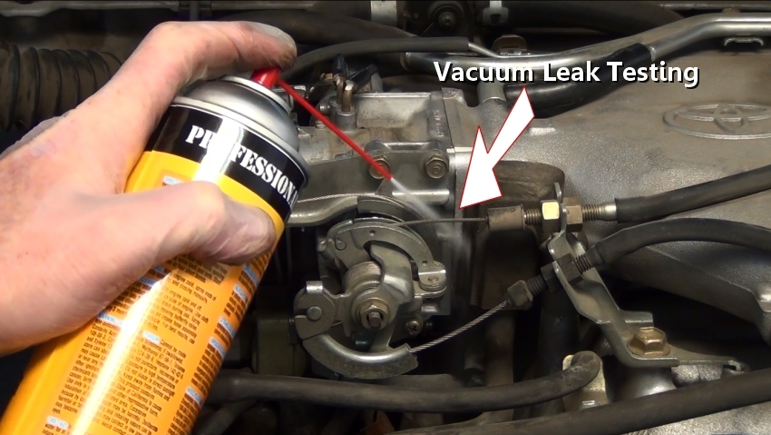

The intake system utilizes gaskets which seal various components, if these gaskets fail a vacuum leak will result, causing the code failure. Use carburetor cleaner to help locate any potential leaks by spraying around gasket surfaces and observe a rise in engine idle speed if a leak exists.
vaccum leak testing

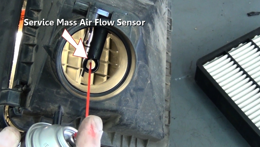

After miles of driving, the mass air flow sensor's filament or hot wire, can become contaminated due air impurities which create false readings. Using sensor safe carburetor cleaner to clean this filament can sometimes remove these deposits allowing the sensor to obtain a correct reading.
service mass airflow sensor

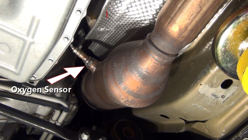

Testing the exhaust system oxygen sensors can help determine the functionality of the sensor. If the sensing element fails, feedback information will be incorrect causing a lean mixture code.
oxygen sensor

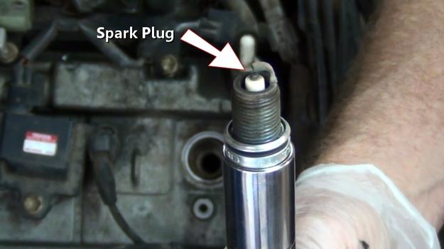

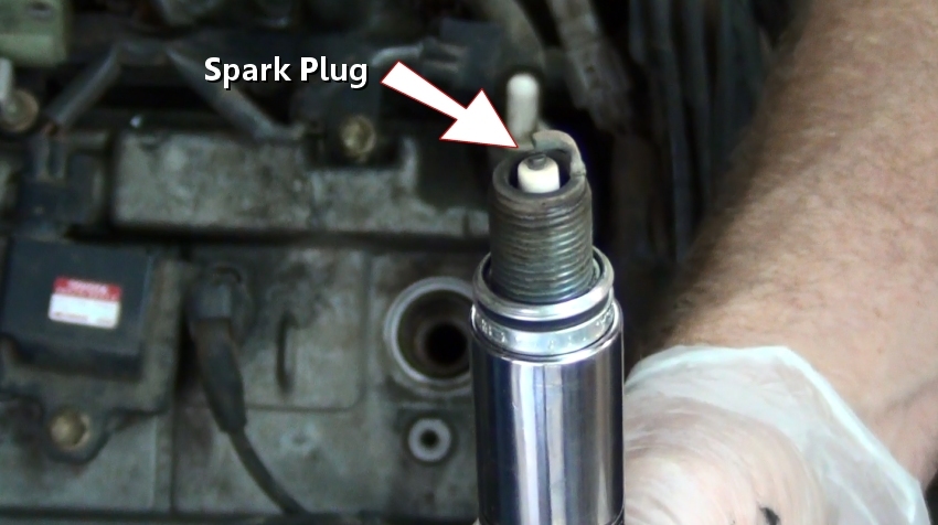

When an engine misfires an almost clean charge of oxygen is released into the exhaust system. This will cause the exhaust system to test lean as tested by the O2 sensors, this can sometimes be fixed by a tune up.
spark plug
