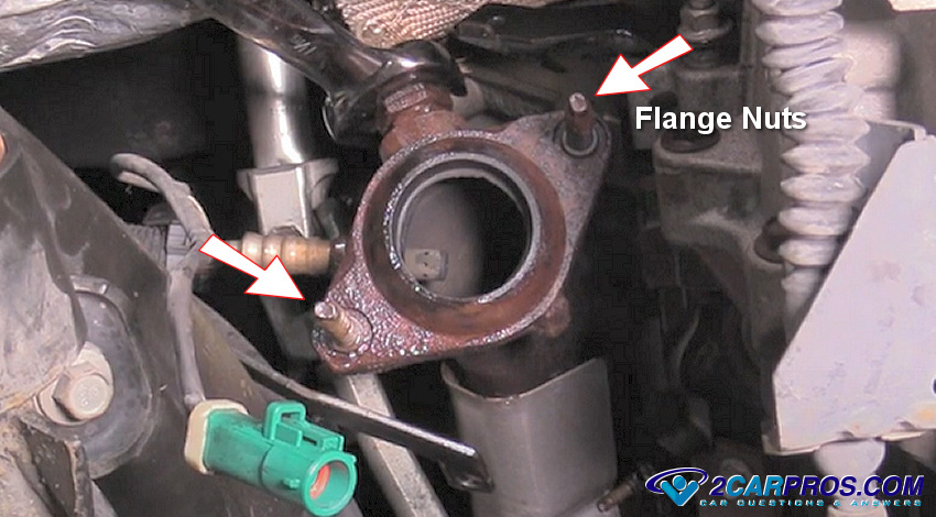

At the rear of the exhaust manifold are flange studs with nuts, this is where the exhaust of the engine is expelled into the catalytic and muffler system. Make sure these are coated with penetrating oil, and then remove, you might need to use a breaker bar to help with the removal. The image below shows the nuts and head pipe removed.

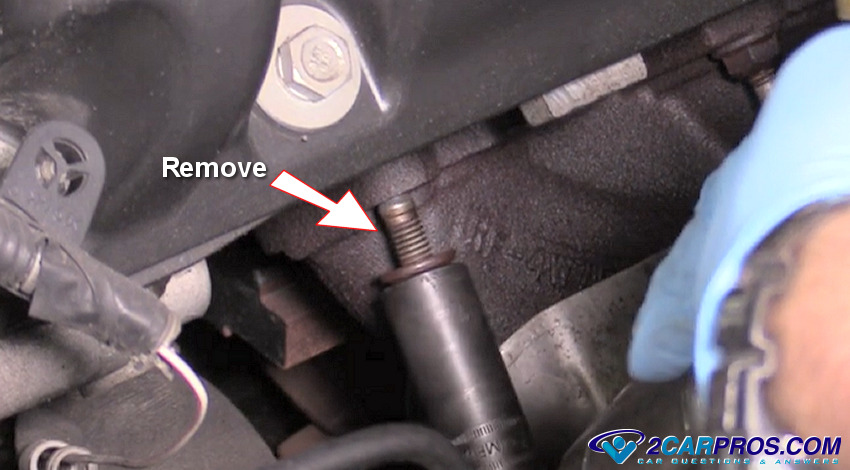

Using a socket and wrench, carefully remove the bolts or nuts holding the manifold to the cylinder head. Start from the outer bolts and work your way inwards. If you come across a broken bolt which is common you will need to remove it before reassembly.

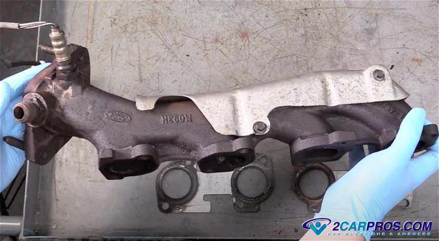

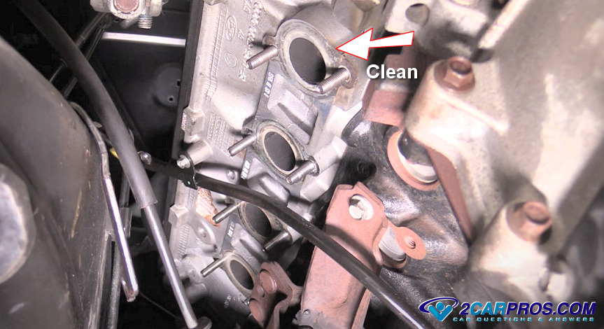

Clean the surface on the engine block where the manifold was attached. Inspect for any signs of damage or wear on the manifold and the engine block. Also, exhaust manifold are known to crack in which the manifold will need to be replaced. Clean the gasket surface on the manifold thoroughly as well.

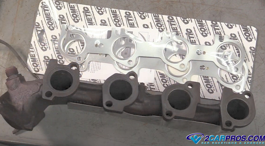

Prepare the new gasket by ensuring it matches the manifold's shape and port layout. Apply any recommended sealant if specified by the gasket manufacturer.
Step 10: Reinstalling the Exhaust Manifold
Place the new gasket on the engine block and carefully align the manifold over it. Secure the manifold by hand-tightening the bolts in a crisscross pattern starting from the center.
