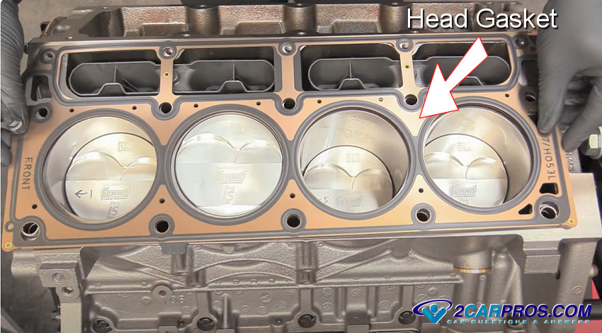

What is a Head Gasket?
An automotive engine head gasket is used to seal the engine block to the cylinder head which helps contain the combustion process. It also controls radiator coolant distribution between the engine block and cylinder head, when this gasket fails it is commonly referred to as a "blown" head gasket.
